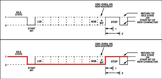

Posted: 01:28am 30 Aug 2014
just had a look at the start and stop bit framing for RS232 data, and found the following:
the top diagram is the original, the bottom has the levels for sending a zero byte (chr$(0) in MMbasic) with no parity highlighted in red. on the face of it, it appears that you get a single clean negative-going pulse that is 9-bits long.
if this was inverted with a single transistor, would the single positive pulse not be ok for PGC? adjusting the baud rate, one could selected a desired pulse length. it would still be necessary to monitor using RI or CD to be sure the pulse was finished (plus wait for a couple of bit-times for the stop pulse to pass) before moving on to send out the next ICSP bit.
someone with a digital scope to hand might care to check this out.
this doesn't address the issue of assuring that the PGD data is synchronised. it could be worth an experiment though, to see what happens. perhaps PGD could be monitored with another spare input line?
rob :-)Edited by robert.rozee 2014-08-31
Posted: 01:41am 30 Aug 2014
How have you allowed for the ms delays of indeterminate length?
Are you thinking maybe 1 baud?
It looks unreliable and much slower than what I have now!

Posted: 01:52am 30 Aug 2014
it may well be less than reliable. i am just kicking around the idea. it may also require some tricks using windows (or linux) interrupts to ensure that everything happens at the right time; basically, every change of PGD would need to be confirmed before the next PGC pulse was triggered. i honestly have no idea how much overhead would be required to do that.
rob :-)
Posted: 01:56am 30 Aug 2014
Please see my pic above. To do what you ask it must be done on the USB board as there are NO interrupts at all from the RS232 lines into the PC. It's all USB packets between PC & USB serial board.
Your kind of idea needs several extra USB packets per minute (as in tiny) transaction so will take forever.
JohnEdited by JohnS 2014-08-31
Posted: 02:34am 30 Aug 2014
yep, you are right - any (faked) interrupts coming back would follow a long and indeterminate path who's length could not be relied upon. everything would quickly fall to pieces.
another tack: is it fair to assume that the order of outgoing USB transactions is always maintained? ie, if you send an instruction to change the state of (say) DTR, then send another instruction to transmit chr$(0), will DTR change state before the chr$(0) is transmitted?
if this holds true, then perhaps one can simply make sure that bits are 'pumped' out of DTR at a sufficiently slow rate, using a timer interrupt. ie, place PGD bits into a queue, and have a timer interrupt:
1. pick up one bit at a time from the queue
2. set PGD accordingly
3. send a chr$(0) out the comm port
the interval of the timer interrupt would need to be somewhat more than the length of the transmitted byte, and one could start very slow and experiment with ramping up the rate. using a baud rate of 1 M-bit/s, the length of PGC pulses would be around 10uS.
