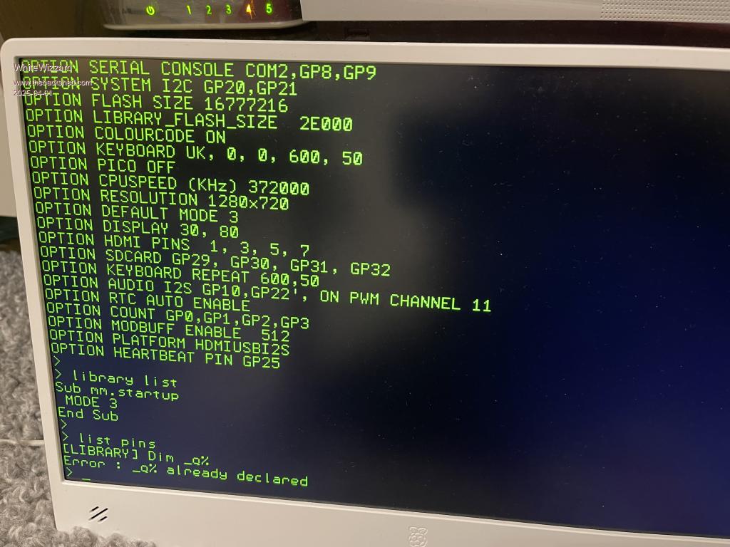

Posted: 07:51pm 31 Mar 2025
@Peter,
RC8 on one of your  latest ‘reference design’ PCBs (I2S HDMI USB) and am seeing an error (screenshot below) with ‘LIST PINS’.
Note I seem to remember this being reported already so maybe you’ve fixed it but not for RC8?
Edited 2025-04-01 05:52 by WhiteWizzard

Harm: thanks for the report - good news. I just need to post the LIST PINS fix and we should be good to go for 6.00.02
