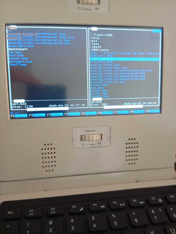

quick&dirty just commented out and defined colours by hand real quick, it runs on a RP2040 and a 7inch LCD ..very nice!
This is FONT 4 and works well, same with FONT 1
Edited 2025-07-15 00:31 by dddns

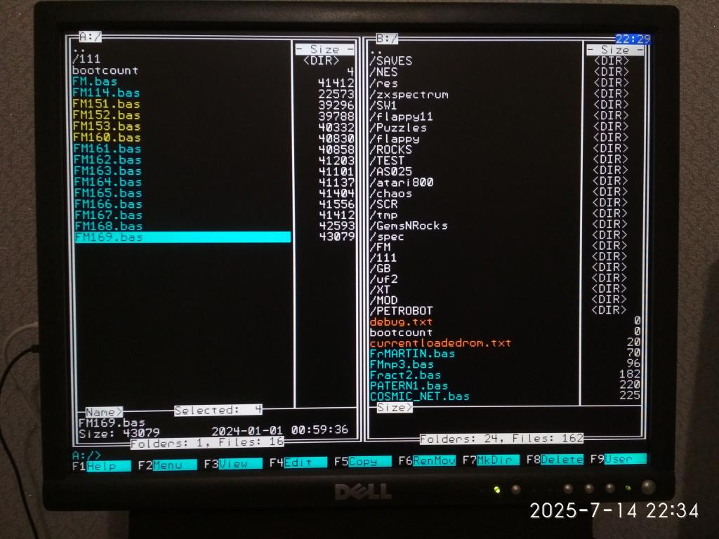

Posted: 07:52pm 14 Jul 2025
FM v.1.69 For testing!
+ A bunch of minor edits
+ Added display of file sizes on panels
Now we need to figure out how to switch the view of panels?
FM169.zip

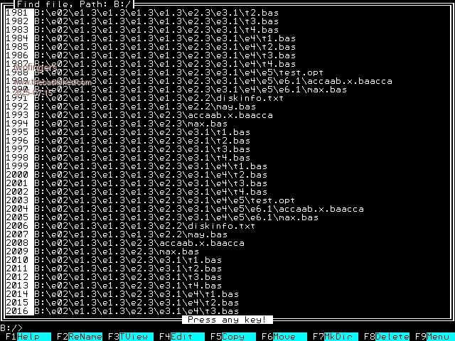

twofingers
Joined: 02/06/2014
Posts: 1782
Posted: 10:33am 15 Jul 2025
Hi Vadim,
the "File Find" function has proven to be a useful idea.
As I already wrote, I've dispensed with storing the results in an array and instead just output the results to the screen. This allows me to output a seemingly unlimited number of results. I'm still considering a solution to display or execute results directly in the panel, e.g., by entering the number or by copying a screen page of 36 files into an array and then selecting them with the cursor. In any case, it's progress!
Michael
