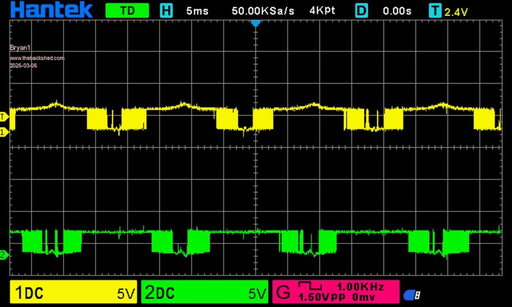

  Bryan1 said  Ok taking Mab's suggestion undid the VS1 and VS 2 connections and set Ch1 to VS1 and Ch2 to VS2
Now with the psu set at 24 volts and the DMM connected to the resistor bank does go to VBat so when the switch is turned on the current goes upto 240mA from 70mA then drops off as the voltage drops to 11 volts.
Fell asleep before i saw this. Then had to go to work.
If that scope trace is vs1 and vs2, there is an asymmetry between them: the little peaks on the tops of the top trace. My guess (it is just a guess though - it's hard
to understand what's going on), would be the gate drive is not getting though on one quarter - or the fets are not turning on.
The outputs from the control board seemed ok in the earlier scope traces, so i'm wondrring if the +ve supply (Vtp om the schematic) for the high side drives is getting through ( i'm thinking they use bootstrapping to get the high side drive voltage, so in my mind there's more bits to go wrong there).
My guess based on those scope traces is that vs1 high side is trying to turn on but vs2 high side isn't.
But my guess is sort of based on the assumption the higher than expected current draw isn't caused by a short.

  mab1 said
snip

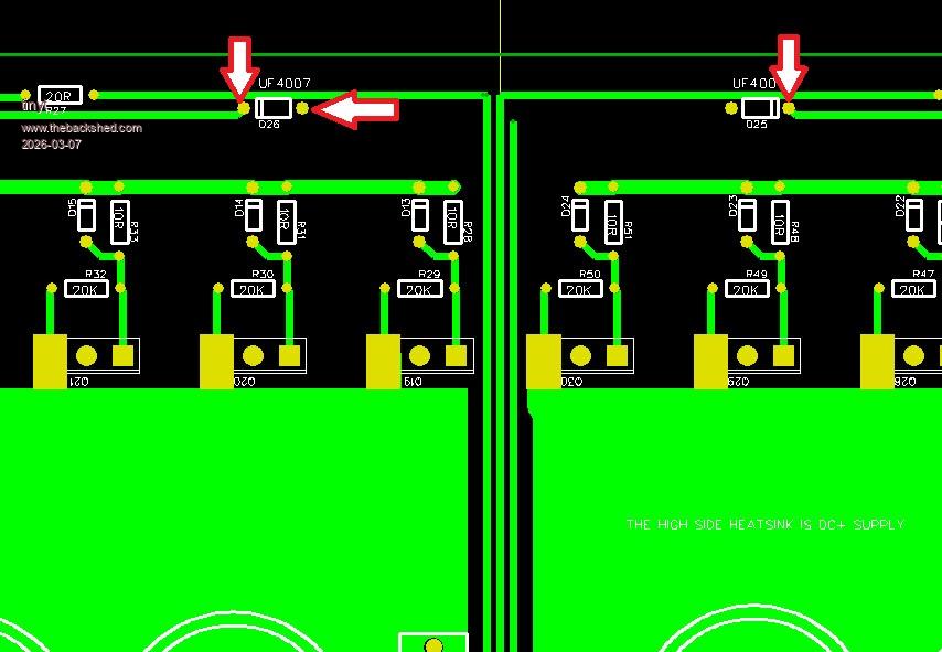

Maybe Bryan can check orientation(pointing opposite to each other) and voltages at D25 and D26 on the power board. Voltage should be around 18vdc for the diode lead pointed to by the horizontal arrow.

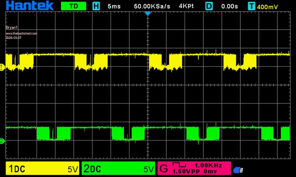

Setup the scope on VS1 and VS2  and Gnd

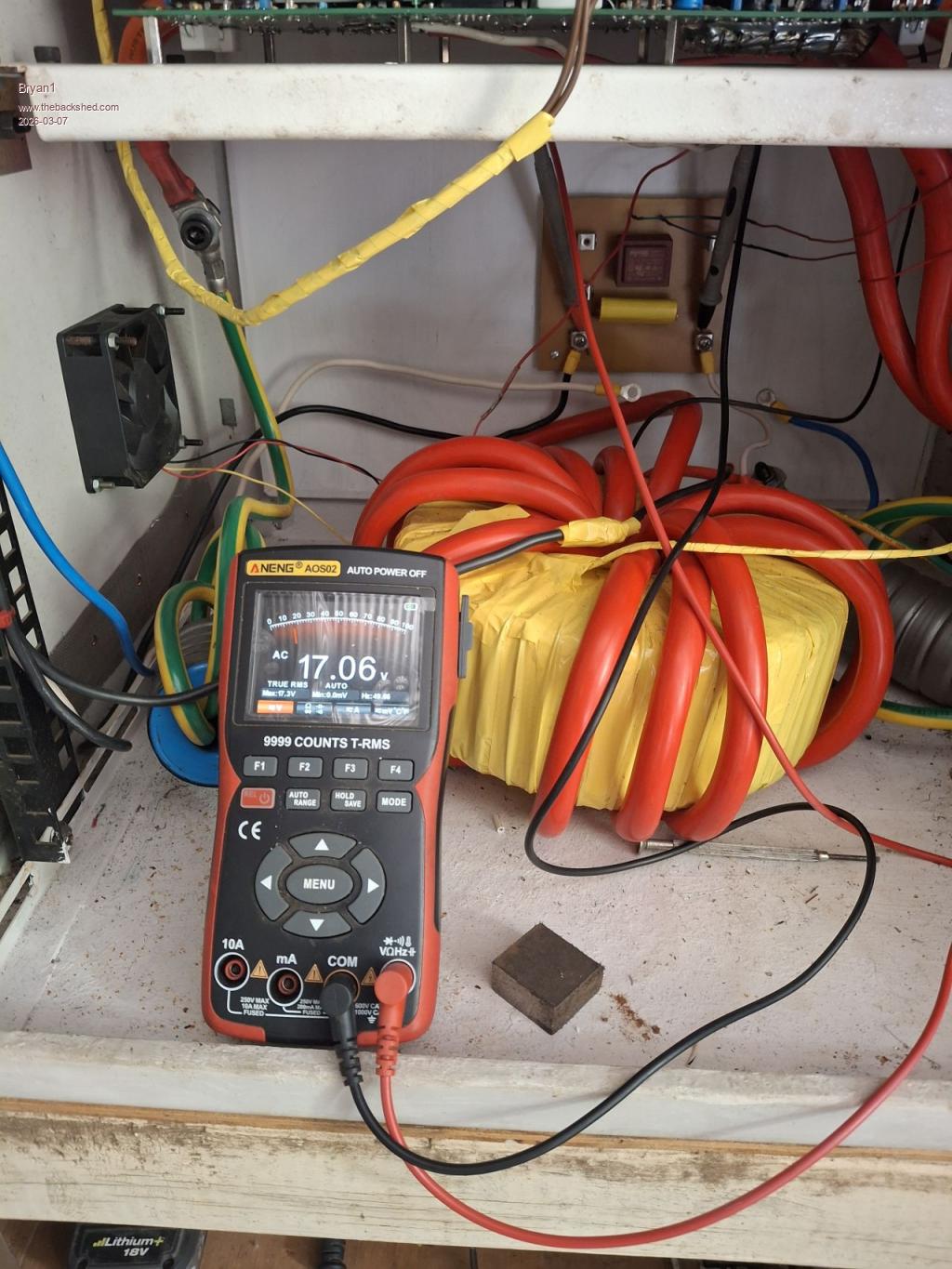

Now the AC output was 14 volts on the fluke DMM
PSU set to 28 volts and 1.2amp where the current draw was 500mA so about 14 watts.
Now measuring that resistor after I turned the pot down quite a few turns was 568mV and I did notice on turning the pot out the AC voltage didn't change at all.
TinyT I just had a look at those fast diodes and they are in the correct position.
Where is this measured?
What is the Vtp voltage reading?

Edit: 24volts DC input 524mA current draw and 14 volts AC output where the probes are in the 240 volt socket

The voltage at the lead of the diode pointed to by the horizontal arrow?

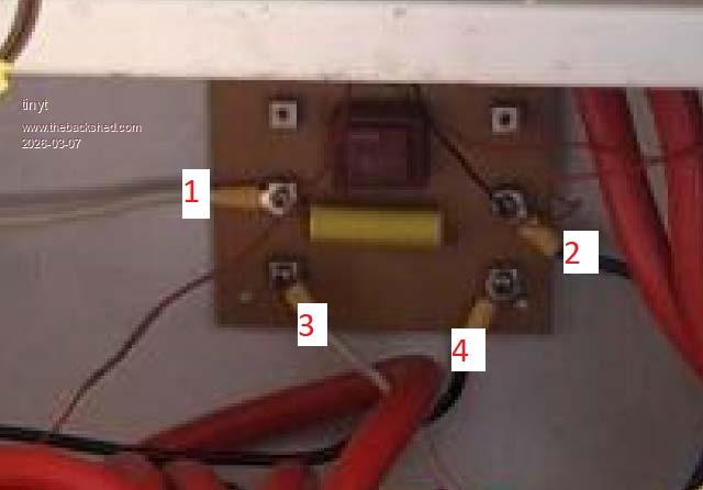

Please identify the numbered leads/terminals in the picture below.
Edit: And what are the yellow(capacitor?) and brown(step down transformer?) parts.

1. is a AC outlet  from the toroid secondary which goes to the 16amp circuit breaker
2.The other AC outlet going to the other 16amp circuit breaker
3. output from toroid seconday
4. the other toroid secondary output that goes thru the hole of the energy meter and is the longer wire.
The yellow part is a 5uf capacitor and the brown part is the 12AC transformer now I did do a test where I put the leads on the 12AC pins and it only showed about 300mV now when I turned it off the voltage did drop to zero.

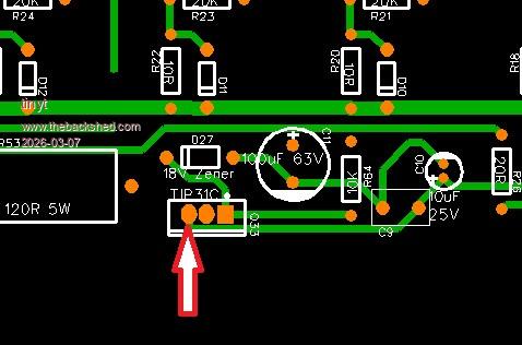

Can you measure at the pin of the TIP31 pointed to by the arrow?

Can you temporarily disconnect wires 1 and 2?
Then measure AC output at terminals 3 and 4?

3.44 volts measured on the left pin, 6V on the centre pin and with the 18V zener 4.07 volts

  Bryan1 said  3.44 volts measured on the left pin.
That is too low, maybe your zener diode is not 18 volts. Measure the other two pins of the TIP31.
And put back wires 1 and 2.
Edit: If the zener diode is rated at 18 volts and your battery voltage is 24v-28v, R64(10K) should be much lower in value.
Do you know the part number of the zener diode?
If not try changing R64 to a value between 1k to 2k for a start.
Edited 2026-03-07 14:50 by tinyt

OK took out the ribbon cable and tested the zener diode was 17.7 volts so the zener diode is correct mate.
the left pin was 17 volts centre pin 24 volts and the right pin 17.7 volts
So it does look like the power board is good.
Edited 2026-03-07 14:55 by Bryan1

If your battery voltage is 24v-28v, that 120 ohms 5 watts resistor should be lower in value, maybe close to 60 ohms.
Edit: But if your final battery voltage is 48-56 volts, then you have to restore it to 120 ohms.
