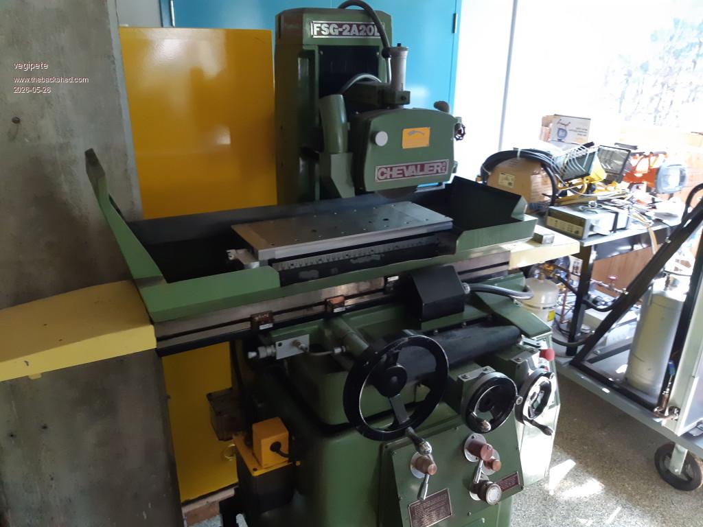

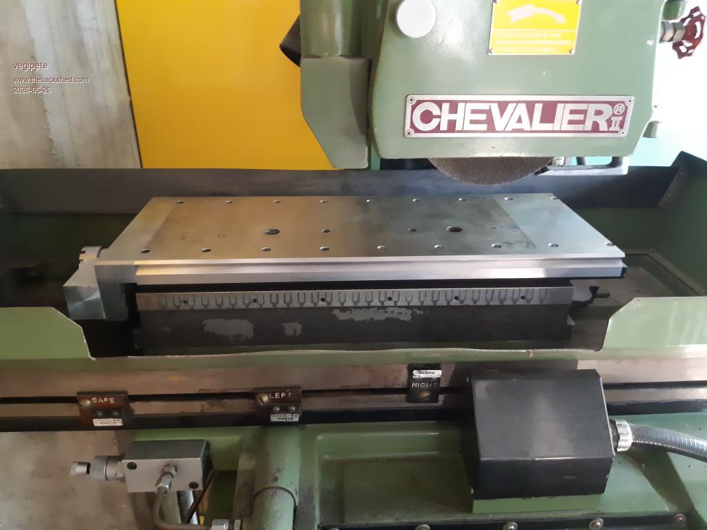

I plonked the work piece onto the grinder - the mag chuck will need moving slightly to get the travel to work. This piece is the cross slide for a lathe that I've been building for a rather long time. Mainly I want to clean up the top surface cosmetically. 21" inches end to end.
Perhaps I'm being overly critical of the state of the automatic hydraulic system. It kinda works, but it leaks on the floor, so we don't bother to use it. The machine gets so little use that no one has troubled to tear it apart and replace bad seals.

VegiPete, that is one nice looking machine. Shame about the hydraulics, maybe time to look into some seals for the cylinder, or fix it like a british car and fit a drip tray, works on my Mini's and Landrovers (I love em but they do mark their territory)

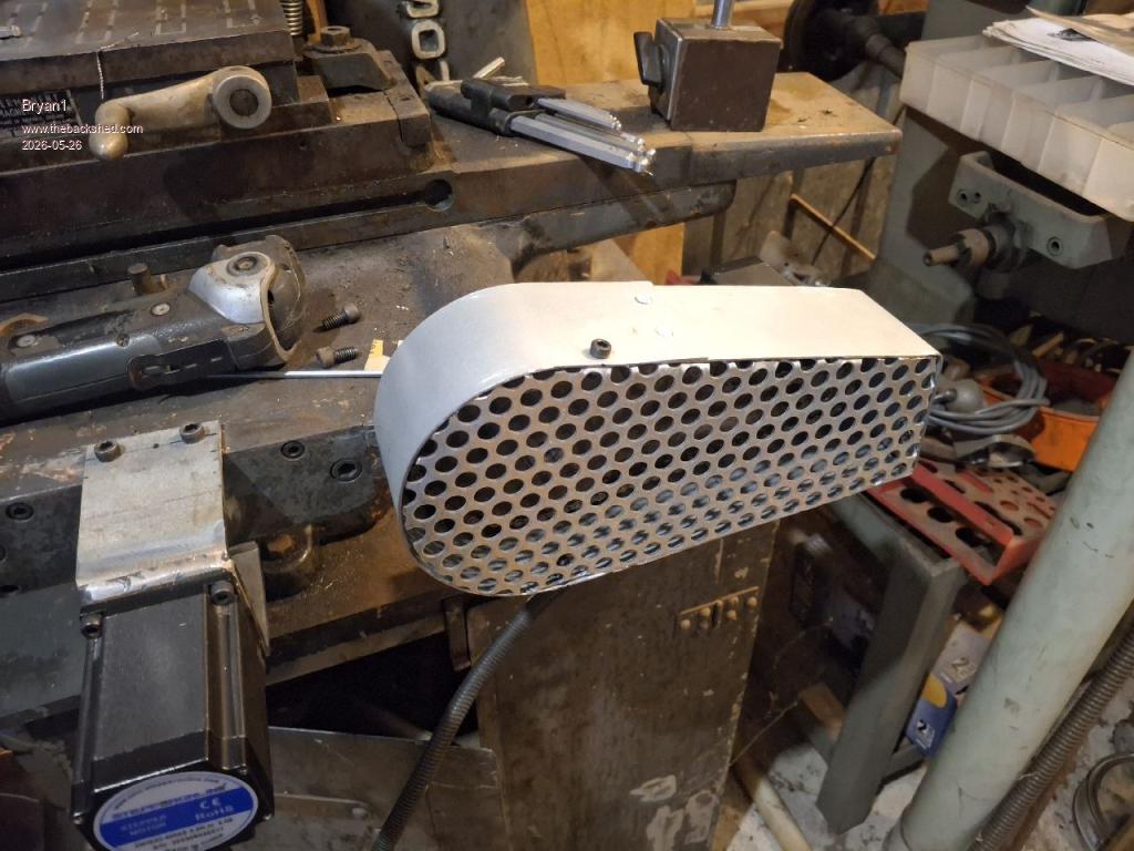

Finally got the X axis guard made and the back plate just needs a tweak so the guard sits nice and even away from the chain.
Still need to make the mounting brackets but now one step further on this project
Now I do have a heap of 2-3 metre lengths of twisted pair wiring and thats what I use for my breadboard setup, now I've never used it before for it's intended purpose so I would guess the white wire on each twisted pair would go to earth wouldn't it ?
Regards Bryan
