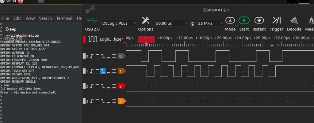

I'm attempting to connect a Wii classic to a pico, but I'm currently failing, I would just like confirmation that the signals I am getting on the I2C look correct, before I right off the Wii controller?
I have tried with and without 10K pull up resistors, no difference, I always get the error:-
[1] Device WII OPEN keys
Error : Wii device not connected1
My options are displayed in the image, I'm using I2C on GP26,GP27, I have also tried GP16,GP17.
In the image channel 0 upper GP26 data and channel 1 lower is GP27 clock.
This is the whole trace, from when I run the test program, until it errors out.
Thanks for any input.
Regards Kevin.

Posted: 05:13pm 28 Nov 2023
The WII does not acknowledge I2C device address &h52 (&b1010010).
Are SDA and SCL swapped? Is &h52 correct? Normally the &h5x series is reserved for eeproms like 24C32.

Posts: 6199
Posted: 09:19pm 28 Nov 2023
The waveform Kevin showed tells us that the controller is not listening to &h52, so it is not possible to configure it.
First you need to find its address.
Hence the tool Jim showed.
P.s. There is also a WII classic PRO controller. Also think that of you have 2 or 3 of these controllers on onze I2C bus, they need to have different adresssen. Maybe this one is &h54,,?

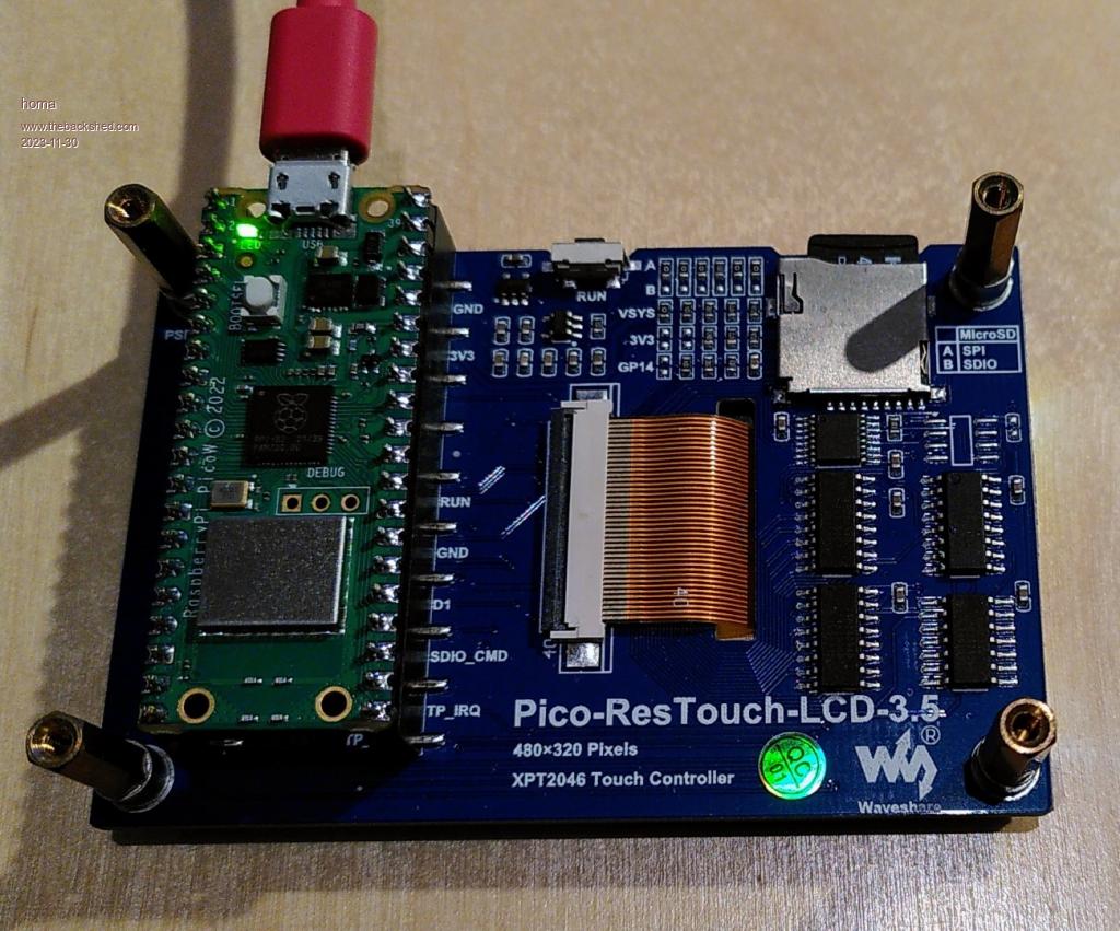

hallo phil99, hallo Peter.
Thanks for the feedback and sorry for the late response.
Unfortunately it doesn't work and I took another WebMite (pico) and tested it again. But even the SD card is not addressed.
With the old Pico without Wi-Fi and the same display! And the old firmware works: PicoMite MMBasic Version 5.07.01
  matherp said  Phil
Thanks for confirming it is all working - saves me breaking out the scope.
I did make a change recently to increase the PWM frequency from 1KHz to 50KHz to take it out of the audio range as it was introducing interference on audio. Why this should have an impact on homa's display I don't know.
  phil99 said
Change Backlight to another pin and setup GP13 with PWM to see if that works.
Unfortunately, this will not be so easy. This module is:
  phil99 said  Edit
I don't know if this is related to Homa's Backlight issue but there seems to be a little quirk. When setting the backlight to gp17 (lowercase) it came out on GP7 instead. Both in Option List and the actual pin. If uppercase GP17 is used backlight is on GP17. Standard PicoMite.
This is repeatable.
Upper and lower case, with spaces after the coma or without, neither helped.

  homa said
Omit the backlight pin when you configure the display
(Backlight is optional)
> OPTION LCDPANEL ILI9488W, RLANDSCAPE,GP8,GP15,GP9 ',GP13
That way you can set pin GP13 as PWM and test different settings for backlight control using PWM

homa
Joined: 05/11/2021
Posts: 728
Posted: 10:11pm 29 Nov 2023
Hello Jim, good advice, the result:
> option list
WebMite MMBasic Version 5.07.08RC21
OPTION LCDPANEL ILI9488W, RLANDSCAPE,GP8,GP15,GP9,GP13
OPTION SDCARD GP22
> option lcdpanel disable
Copyright 2011-2023 Geoff Graham
Copyright 2016-2023 Peter Mather
> gui test lcdpanel
> setpin gp13,pwm6b                 'display goes dark
> pwm 6,200,,50
> pwm 6,200,,5
> pwm 6,200,,95
> pwm 6,200,,30
> pwm 6,200,,40
WORKS!
Conclusion, must be a bug, sorry Peter.
... and what about the SD card?
