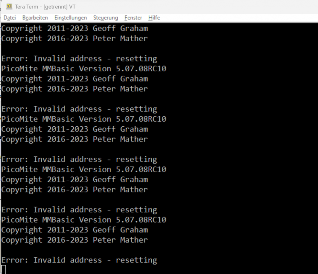

I also am still getting the repeated "resetting" after LIBRARY DISK LOAD. I'm using Peter's latest from 4 posts above and Bleep's library that Martin linked to in the post above that.
Here's my OPTION LIST (I don't have sound or touch configured):
option list
PicoMite MMBasic Version 5.07.08RC10
OPTION DISPLAY 50, 120
OPTION LCDPANEL ILI9341, RLANDSCAPE,GP21,GP20,GP17
OPTION SDCARD GP2
I get the resetting even when the Pico is not plugged into any PCB. (Tom--I do have Game*Mite PCBs, but don't have all the parts yet, so haven't soldered it up--and I'm keeping in mind the issues with the tented vias.)

  Quote  I also am still getting the repeated "resetting" after LIBRARY DISK LOAD. I'm using Peter's latest from 4 posts above and Bleep's library that Martin linked to in the post above that.
I think this now has to be a H/W issue. It would appear the library is not writing accurately or in the correct place. Have you tried clearing the flash completely (nuke) and starting again? I attach the clear flash program in case you haven't got it. If that doesn't work try on another Pico starting with clear flash. What are you using as a development system? Your options look similar to Mick's board that I'm using but not quite the same.

  lizby said  I also am still getting the repeated "resetting" after LIBRARY DISK LOAD. I'm using Peter's latest from 4 posts above and Bleep's library that Martin linked to in the post above that.
I managed to load the Library, but only when it is stored on SD Card,
A freshly unpacked Pico doesn't have an SD card installed yet, when loading the lib from A: I get the endless boot.
Flash _ Clear has to be done every Time after it went to the endless loop. Just reflashing PicoMite doesn't help.
So the way it ssems to work is Flash clear, (re)Install PicoMite. Set the options that the SD Card could be read. go to the LIB Dir on B and install the Lib using LIBRARY DISK LOAD.
Edited 2023-10-20 17:39 by Martin H.
