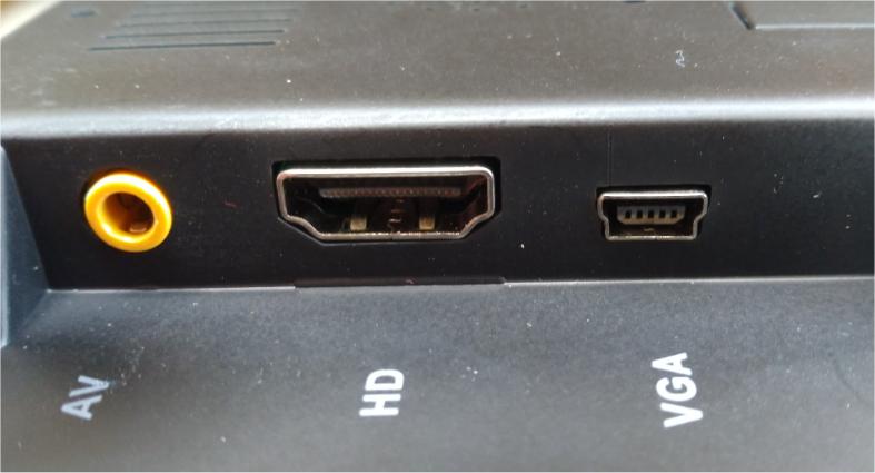

I hope this isn't altogether OT: I have a 7" HDMI display which has an input labeled "VGA". It's the shape of a USB "mini" connector, and looks like it accepts a 5-pin plug.
If the display came with a cable for that, I've lost it. Does anyone know of such a cable and what it would be called and where available? If this display would work, it might actually get me to build a Picomite VGA board.
Posts: 9257
Posted: 06:27am 20 May 2022
As far as I know there has never been a standard for a mini version of VGA. Anything other than the normal 3-row D connector is manufacturer specific. You may have fun with this one. However, the USB-A connector is intended to power one of the little VGA to HDMI converters so you don't really have a good excuse not to build one. ;)

The first step is to work out which pin does what. First search the web to see if anyone else knows. Then plug 5 DuPont wires in. The shroud must be ground and the 3 colour pins should measure 75R to ground. The remaining 2 must V & H sync. You will have to sort them out by trial and error. Put a PicoMite on a breadboard and plug the DuPont wires and earth into its VGA outputs via 220R for red and blue and 330R and 680R for green high and low. it doesn't matter which colour is which at this stage. Type CLS RGB(White) and see if it works, if not swap the sync. wires an try again. If that works you can then sort out the colours.
If you can't purchase a plug anywhere it is possible to make a crude one.
find some thin, stiff wire such as a small paperclip or magazine staples and solder them at the end of a piece of strip board then bend to fit the holes. Make it rigid with a little 5 min. epoxy. For the earth cut a small rectangle of tin plate from a can lid. Solder a wire on and epoxy it on to the plug (which you have insulated with epoxy) and bend and trim it to fit into the socket shell. Just one side should do, too hard to make it go all the way around.
Posts: 9257
Posted: 07:46am 20 May 2022
It's annoying because in most respects it's a standard USB connector. The problem is that USB leads only have 4 wires - pin 4 is used for OTG detection and has no connection at one end and is grounded at the other. (Yep, I've been looking it up!)
You can get 5-wire mini USB cables, but they are a bit thin on the ground. They don't seem to be sold as VGA cables though, so bear that in mind. Probably not much use to you, but I found what seems to be one on Amazon.uk.

Posts: 3418
Posted: 08:04am 20 May 2022
Assuming it is Mini USB here is a plug with 5 pins.
https://www.aliexpress.com/item/1005001908243531.html
Posts: 9257
Posted: 08:24am 20 May 2022
Hey, those are good! :)  I don't think they will fit though. They seem to be 5+5 pins, not just 5 in a row. The shell looks like it's the same as mini USB.
Posts: 3418
Posted: 08:32am 20 May 2022
Looked in the end of a Mini USB plug with a magnifying glass. There are NO pins. Same as regular USB, just mini.
So that plug is something else entirely.
Posts: 9257
Posted: 09:22am 20 May 2022
By Gad, Sir, I do believe you're right!
A mini USB has 5 flat pads, the two outer ones longer than the middle ones, all on the long side. Back to square one - that's a special connector. :(
From the apparent scale I suspect Dupont connectors will be too big to fit.
Edited 2022-05-20 19:30 by Mixtel90
Posted: 09:38am 20 May 2022
Is this the aberration in question:
https://www.aliexpress.com/item/32830643122.html
Unfortunately the photos don't show what is in the "USB" enclosure, but presumably it's not USB because surely you can't just wire USB <-> VGA.

Posts: 9257
Posted: 09:55am 20 May 2022
It's what I would imagine it to look like, Tom. As you say, it can't be USB as USB doesn't carry video - even if it looks like it. Pity they didn't show the inside of the mini plug. At that price it's probably worth a try. I tried zooming in on the largest pic and it looks as if there are pins in there.
