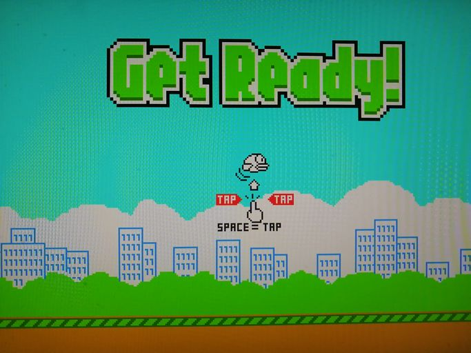

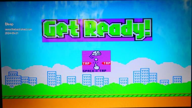

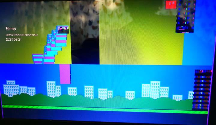

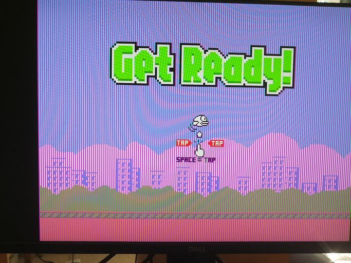

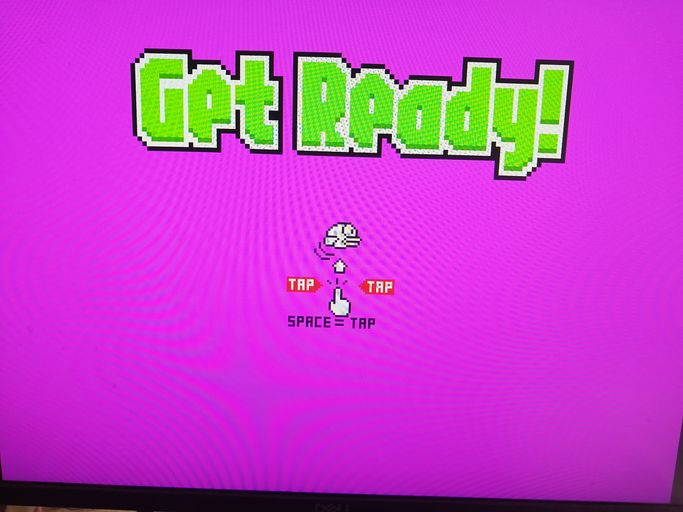

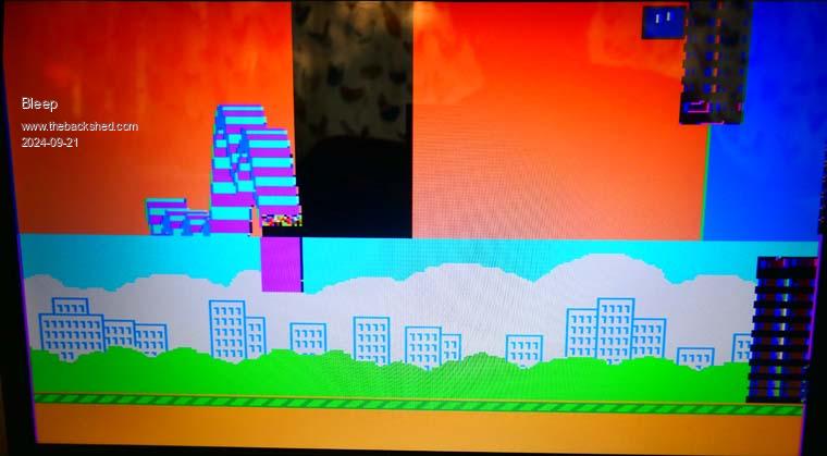

The test program you provided worked fine on HDMI Mode 2 and 5
I wasn't sure if you thought Petscii and or Flappy birds would also run in both of these modes, without modification? Anyway In HDMI Mode 2 they both work as expected.
However in HDMI Mode 5, Flappy birds did this.
and Petscii basically gave a completely magenta screen, with two partial copies of the running man only.
