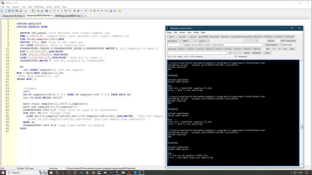

adc start samples!() 'get new samples
min=Math (MIN samples!())
print min
end
I get
RUN
[19] min=Math(MIN samples!())
Error : MIN is not declared
I cut and pasted but in mmedit min is MIN, it makes it a blue keyword.

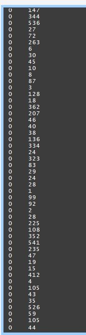

Posted: 06:09pm 12 Sep 2023
Thanks Volhuout.
 do
indx%=Math (MIN samples!(),low%)
print indx% , low%
loop
end
gives
not the lowest element.
Posts: 6199
Posted: 06:28pm 12 Sep 2023
Oh yes, the lowest value is 0, found at location 147 in the array.
Your index is the low value, ypur low value is the index.
And you have used an integer. So when the array value is 0.4, a 0 is printed
