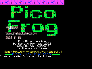

I have a very unfortunate bug to report. RP2040 VGA V60100rc16 The game Frogger uses SPRITE SCROLL to move the lanes left and right. In rc16 that does not work correct anymore. Maybe Claude messed up.
I have been able to trace it back to rc14 to have the problem also. rc12 is okay.
SPRITE SCROLL moves a lane 2 pixels left or right. In rc16/15/14 it seems to scroll 4 pix, then 2 back, then 4, then 2 back, in stead or 2,2,2,2,etc..
Please find below video recordings.
Watch the cars in the lower 2 lanes for the best comparison.
compare 2 videos
P.S. the scrolling text in the intro screen also shows the effect. Below is a picture of the scrolling text (yellow text) halted, and saved with "SAVE IMAGE". The video memory is really corrupted by the scrolling.
Edited 2025-11-19 06:25 by Volhout
Posts: 12057
Posted: 10:41pm 18 Nov 2025
What are you scrolling? screen or a framebuffer?  What is the exact command doing the scrolling? AFAIK nothing has changed in this area.

Posts: 6195
Posted: 08:07am 19 Nov 2025
Hi Peter,
This is the scrolling text issue.
 Title$=" Game based on the Arcade Game Frogger - copyright Konami 1981  - "
 tc%=0: tk%=7
 mode 2
   If TK%=7 Then
     Colour rgb(yellow) : text 14,176,Left$(title$,34)
     title$=Right$(title$,Len(title$)-1)+Left$(title$,1)
   Else
     blit 17,176,16,176,197,8
     Box 207,168,1,8,,0,0
   Inc tk%,-1:If tk%=0 Then TK%=7
   pause 15
 Loop until inkey$=" "
It blits in N graphics partly over itself. Depending when you stop it you get readable text or gibberish.
This is not the SPRITE SCROLL, but a blit. I will see if I can make a mini demo of the SPRITE SCROLL issue, but I think under water it is the same issue.
P.S. is it using RGB222 pixel move in an RGB121 plane ? It appeared in rc14, the first to have RGB222 in 2350. But this is 2040.
Edited 2025-11-19 18:10 by Volhout
