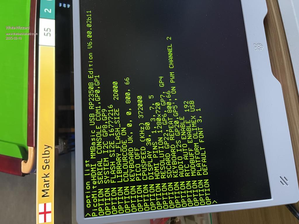

Posted: 04:18pm 14 Feb 2025
@Peter,
Three questions if I may - embedded below within my use-cases.
Currently working with Pimoroni Pico Plus 2 (ie RO2350B) with HDMI+USB firmware b11. This is on a OLIMEX PC board. Also have unpowered 4-way hub, RTC, I2S module, and usb-to-serial module to console in from laptop too (TeraTerm)
Hardware wise, everything is happily working as expected. Resolution is 1280.
The only thing plugged into the hub is a USB keyboard.
On power up, I see the ‘MMBasic welcome message’ on TeraTerm, but not on HDMI monitor.
QUESTION 1:  Is the welcome message meant to be on HDMI too?
About a second later (after power up) the system reports any USB devices plugged into the hub.
Channel 1 correctly shows keyboard, but channel 3 is reporting an unknown device (with pid and vid values).
QUESTION 2: I remember seeing a post about this before, but is this expected behaviour?
If I have a program running that uses a ‘large font’ (such as a large format clock on the HDMI screen), AND if I set Option Autorun On, then on power-up, I correctly see my clock (in large font), but then about a second later, I see the USB devices listed also in large font (which totally messes up the time shown on the screen).
QUESTION 3: is there a way to suppress the ‘usb device list’ so it doesn’t show at all?
Thanks in advance for any clarification…
