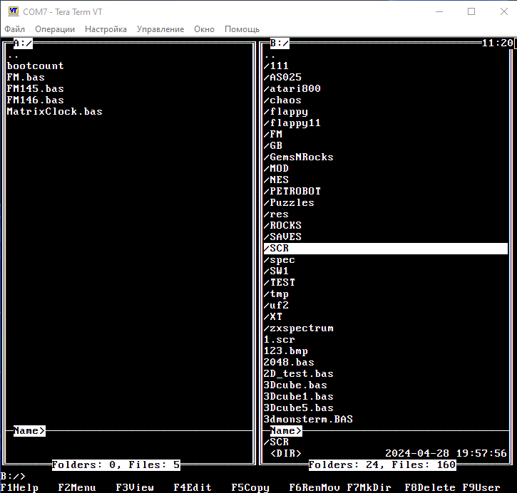

Installing the Perfect_DOS_VGA_437 font partially solves the problem of displaying the pseudographics symbols of the PicoMite encoding.

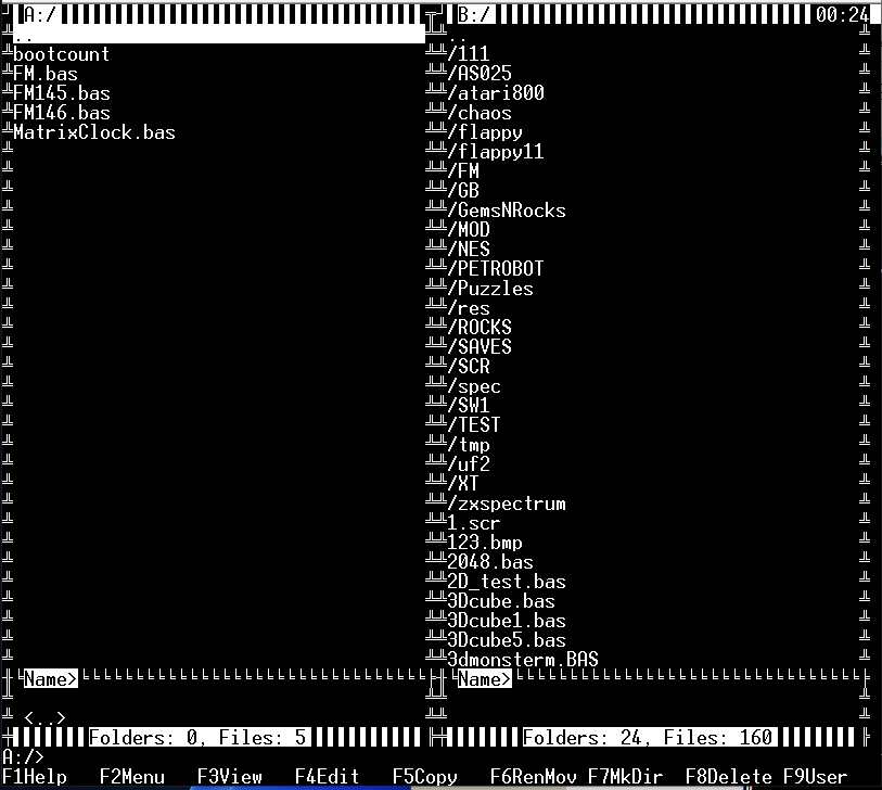

javavi
Joined: 01/10/2023
Location: Ukraine
Posts: 595
Posted: 11:09am 12 Apr 2025
I am talking about a simple version of FM without adaptation for VT100.
For me, if I turn on the "Terminal" font in TeraTerm, everything looks like this.
Maybe it's a question of choosing the right encoding for the country, I don't know, but with the installation of a new font for DOS, it solved the problem with pseudographics for me.
My desire to make all the symbols of the PicoMite font appear the same in the Terminal on the computer.
Edited 2025-04-12 21:13 by javavi

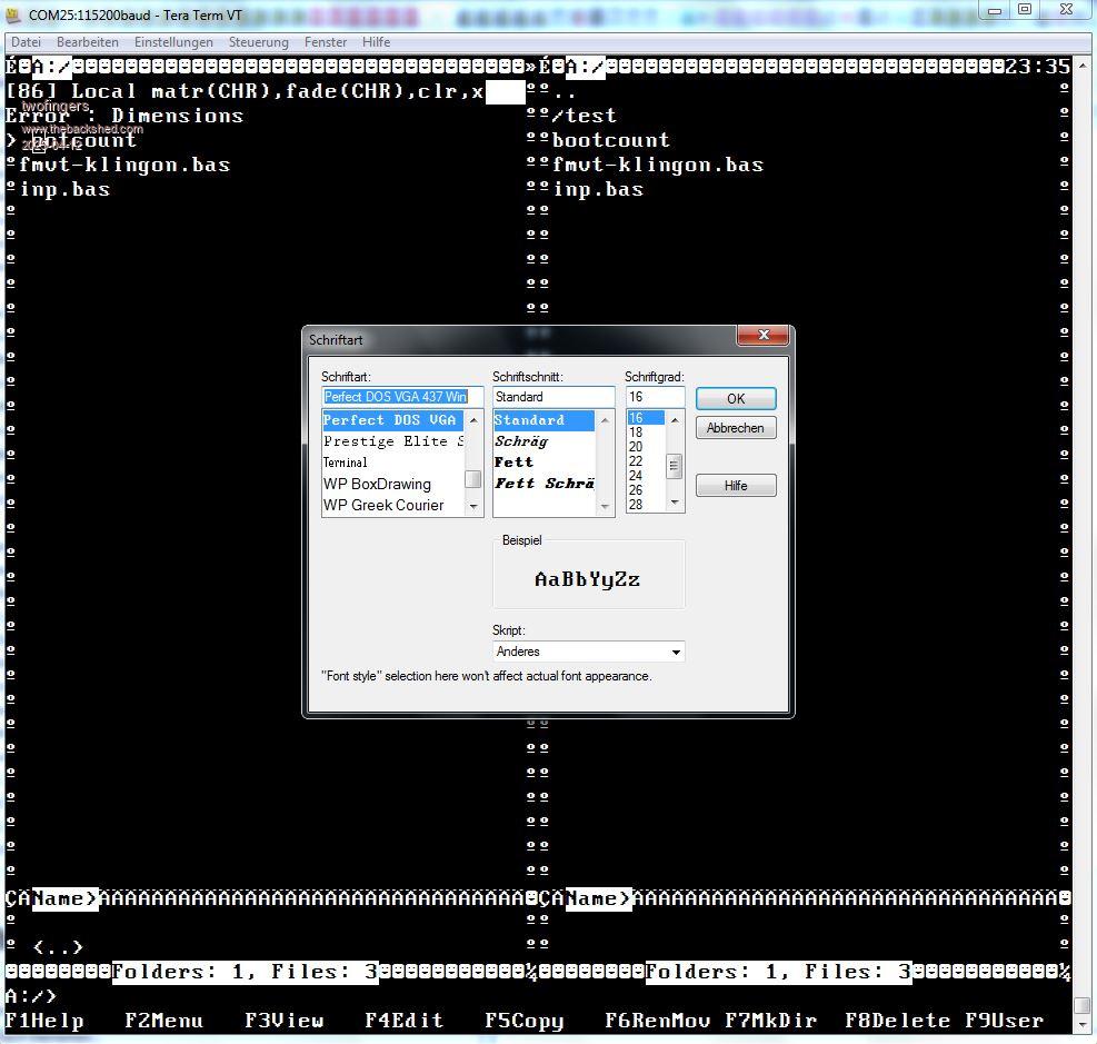

twofingers
Joined: 02/06/2014
Posts: 1769
Posted: 11:50am 12 Apr 2025
@Vadim:
  javavi said  ... I don't know, but with the installation of a new font for DOS, it solved the problem with pseudographics for me. ...
This is what your FM145 looks like with the 437 (Perfect DOS VGA 437 Win.ttf) font:
Michael
My goal was to create a file manager for "bare" PicoMites. I believe that's been done sufficiently with the FMVT for Klingons. I don't think it's a bad idea to have an FM for VGA and one with VT100 escape codes.
Edited 2025-04-12 22:01 by twofingers

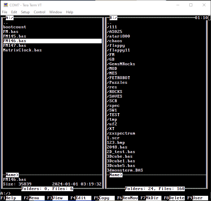

javavi
Joined: 01/10/2023
Location: Ukraine
Posts: 595
Posted: 12:05pm 12 Apr 2025
  twofingers said  This is what your FM145 looks like with the 437 (Perfect DOS VGA 437 Win.ttf) font:
For me, FM in the terminal now looks good without any adaptation for VT100! Only in black and white display on the terminal.
Another possible reason is in the terminal encoding settings.
FM147.zip
Edited 2025-04-12 22:08 by javavi

twofingers
Joined: 02/06/2014
Posts: 1769
Posted: 12:31pm 12 Apr 2025
@Vadim,
Did you use a bare Pico? Which firmware version? I'm already getting error messages for "MODE 1:Font 1." Obviously, that can't work with the console!
This doesn't work either:
[49] Colour Map  c(),c()
Error : Expression syntax
Your version looks just as wrong to me as the FM145.
BTW:
Please correct this.
Const FW=MM.Info(FONTWIDTH):FH=MM.Info(FONTHEIGHT)

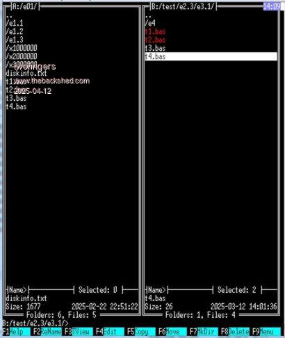

Joined: 02/06/2014
Posts: 1769
Posted: 12:35pm 12 Apr 2025
This is what your FM145 looks like at mitr with the 437 (Perfect DOS VGA 437 Win.ttf) font:
Michael

  twofingers said  What I'm looking for are clear instructions to achieve a specific result.
Try setting up TeraTerm with this DOS font size 12.
Additionally, configure the encoding:
Setup -> Additional settings... -> Coding: recive English/ISO8859-1
I managed to achieve the result with this encoding

twofingers
Joined: 02/06/2014
Posts: 1769
Posted: 06:16pm 12 Apr 2025
  javavi said  ... configure the encoding:
Thanks Vadim, unfortunately, I don't have this setting yet (Teraterm 4.85). I found the setting in V5 (but I don't like V5 very much). I won't be contributing much more anyway, because the VT100 version is sufficient for bare Picos boards, and I have few ideas for improvements for VGA.
Kind regards
Michael
