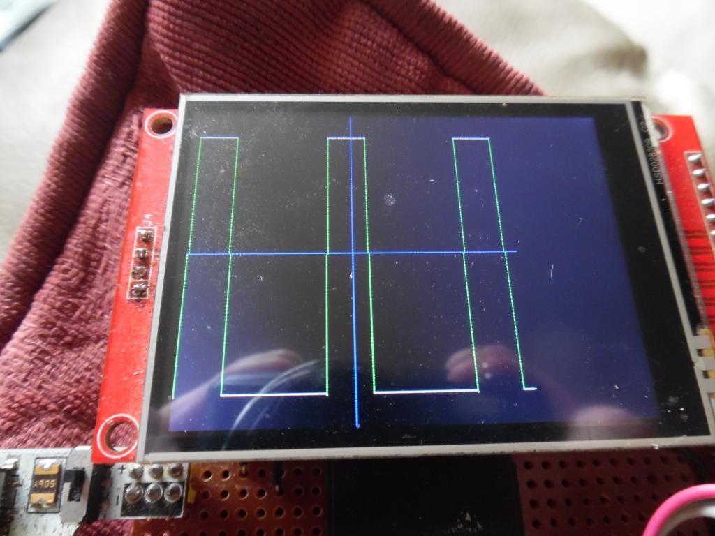

Posted: 03:38pm 07 Sep 2023
NPH . I looked at your old trigger and changed mine and it seems more stable!
a rising edge but my display and 0,0 at top left.
using ili9341 with 0,0 at top left. Moving to bottom left 0,239-y each loop seems waste so turn display board 180 and print text upside down.. no :)
   adc start samples!() 'get new samples
   'trigger
   c%=0
  do:If samples!(c%+1) > 0.1 then if samples!(c%) < 0.2 then exit do
inc c%:loop while c%<240
was If samples!(c%) > 0.1 then if samples!(c%+1) < 0.2 then exit do
As an experiment I tried line in green then plot in white on top.. 2 tone square.
for x%=0 to 238 'screen width
     line x%,239-samples!(x%+c%),x%+1,239-samples!(x%+1+c%),,rgb(green) 'draw new sample from sample(c%)
     pixel x%,239-samples!(x%+c%),rgb(white) 'plot new sample from sample(c%)
   next x%

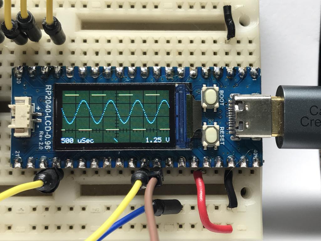

Stan - I've just changed the code to trigger either on channel 1 (GP26, pin 31) or channel 2 (GP27, pin 32) by repeatedly pressing the "trigger" button. You'll notice two things: The trigger symbol ("/", "\", "-") is shown in the color corresponding to the channel being used as a trigger source, and the terminal (if present) shows the transitions for trigger, voltage, and timing.
I'm feeding GP27 (pin 32, "channel 2") a 1 KHz sinewave I generated as an MP3 file, and downloaded to an ancient iPod. It gets to GP27 through a 47uF capacitor and 10K resistors between ground and pin 32 and between pin 32 and the 3.3 reference voltage on pin 35, as per Mick's recommendation.
Here's the code that accomplishes this:

Posted: 10:09pm 07 Sep 2023
Very tidy code. I just got to find frequency and the a way to get it to how many cycles by changing sample rate, 4 is nice cycles using ili9341 but frame layer L is fine, I wouldn't bother with what looks like a hospital "scope"
 SetPin GP2,pwm1A 'this optional test signal comment out
 PWM 1,1000,30  'square wave ,this optional test signal comment out

Posted: 03:08pm 08 Sep 2023
@NPH, I just seen your latest code and the image looks impressive. You really got it sorted. Excellent work. Lots of new stuff me to learn ,memory copy, peek ,math mean. stan.

NPHighview
Joined: 02/09/2020
Posts: 222
Posted: 10:17pm 08 Sep 2023
Stan - Thanks. Never too late for me to learn something, for sure.
I was skimming my code and realized that I was regenerating graticules every time the main loop handled switch presses. Making that conditional on debounced keys cut the execution time by 15% :-)
Now, to look at this with two new Waveshare display boards, each with 2 or more integral switches, a joystick, and a MicroSD socket. Just ordered; should be here in 2-3 weeks.
- Steve

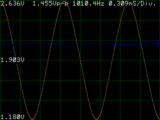

Some minor improvement to my last scope program.
When in the trigger level was set to a fixed value and the input changed so it no longer crossed that value it would loose track of the frequency. And not recover when the input was restored. Now fixed, along with the previous issue.
Scope_Auto F & V4.zip

Very nice! Is the blue line at the trigger level?
Posts: 3417
Posted: 12:59am 09 Sep 2023
Yes, and though not easily visible in the pic. at the right is it's voltage.
