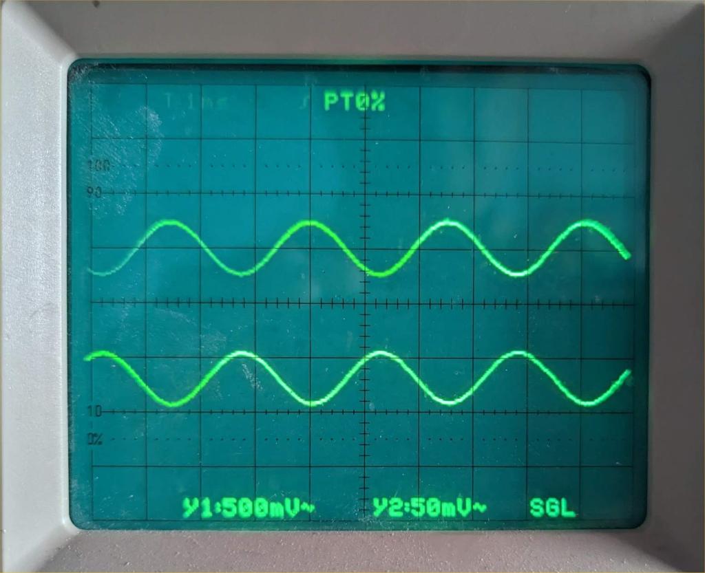

I've just updated B34 as follows:
LIBRARY LIST ALL implemented
Support for mono output in PLAY SOUND
PLAY SOUND chan, M, waveform, freq [,vol]
When M is set the right channel is set to to be the invert of the left
See the previous page for all the details of other changes

Does this also work with:
OPTION AUDIO GP6
(Only 1 PWM channel used, the other (GP7) free for other IO ?)
P.S. I can imagine it will not work the other way around (not using PWM3A, but using PWM3B).
Edited 2023-04-03 21:10 by Volhout
Posted: 11:18am 03 Apr 2023
No:
The two channels are running as normal just 180 degrees out of phase
Note on my VGA board design I am using GP22 and GP23 for audio (+ GP24,gp29 if DAC)
Edited 2023-04-03 21:20 by matherp

I can fix PLAY TONE - you will just use a negative frequency for the right channel. This will be in the first release candidate
e.g. PLAY TONE 400,-400
This will only work when the audio is stopped as subsequent PLAY TONE commands when a tone is active maintain the phase position to  avoid pops
So
PLAY TONE 400,-400
PAUSE 1100
PLAY TONE 800,-800 'ERROR
PLAY TONE 400,-400,1000
PAUSE 1100
PLAY TONE 800,-800 'OK
PLAY TONE 400,-400
PAUSE 1000
PLAY TONE 800,800 'Negative phase relationship maintained
Edited 2023-04-04 01:56 by matherp
