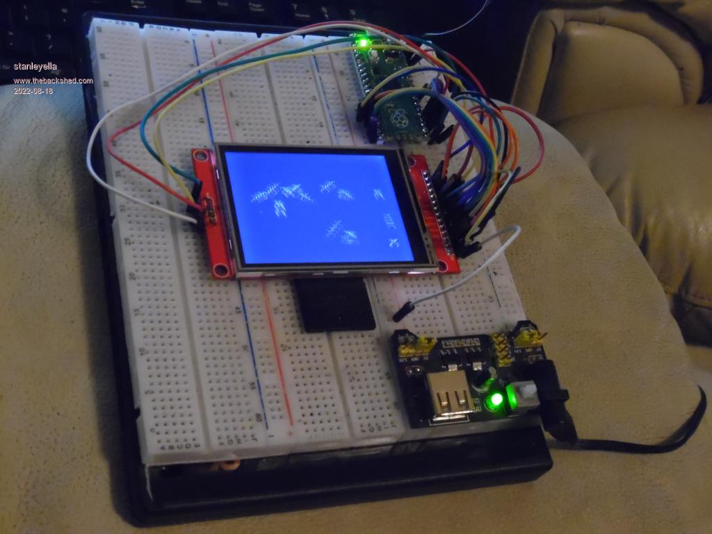

ps the manual.... ground 3.3 en and use a 3.3 linear reg an improvement? the idea was it was a cheap system, no extra stuff needed for reading a-d... rpipico fault.
An ili9341 is 3.3v logic but 5v supply through a 3.3v on board reg and jp1 which shorts it out so it runs off 3.3v. dunno about the led backlight which seems ok with 3.3 or 5v.
so as my breadboard supply has two switchable 3.3/5v supplies then guess run the pico off 3.3v rail and the lcd from 5v rail?
Wonder how fast it samples.
Well ground 3.3 enable and power the 3.3vout from 3.3v works. use usb to load code with it wired and supplied and it loads and removing usb lead it still works. maybe it will be cleaner. I ran the lcd and led backlight from 5v rail
the wall plug is 6.5v sm 600ma
Posts: 9260
Posted: 05:54am 18 Aug 2022
If that's the normal ILI9341 (it looks like it is) you can run it from 5V. The 5V supply is, I think, used as the main supply to the backlight, which (on current versions) is driven by a transistor from the controller chip. The backlight draws quite a bit of current at high brightness levels so it makes more sense to feed that at 5V. The controller chip itself is fed via an on-board 3V3 regulator so all I/O pins are at 3V3, even with a 5V supply.
You can feed the PicoMite at 3V3 (via the 3V3 pin) but you must connect 3V3EN to GND to disable the SMPS.
MMBasic takes a string of A_D samples, discards the first and last then averages the remainder to get a final value. This is all done automatically. It also automatically scales the A-D input so that you read the actual voltage on the pin.
Posted: 05:29pm 18 Aug 2022
  Mixtel90 said  If that's the normal ILI9341 (it looks like it is) you can run it from 5V. The 5V supply is, I think, used as the main supply to the backlight, which (on current versions) is driven by a transistor from the controller chip. The backlight draws quite a bit of current at high brightness levels so it makes more sense to feed that at 5V. The controller chip itself is fed via an on-board 3V3 regulator so all I/O pins are at 3V3, even with a 5V supply.
The last image shows the ili9341 running off 5V and the led at 5V. The picomite is 3.3EN grounded and 3.3V is fed into 3.3V out. Works with no usb.
The A-D seems a slow implementation but yet to try.

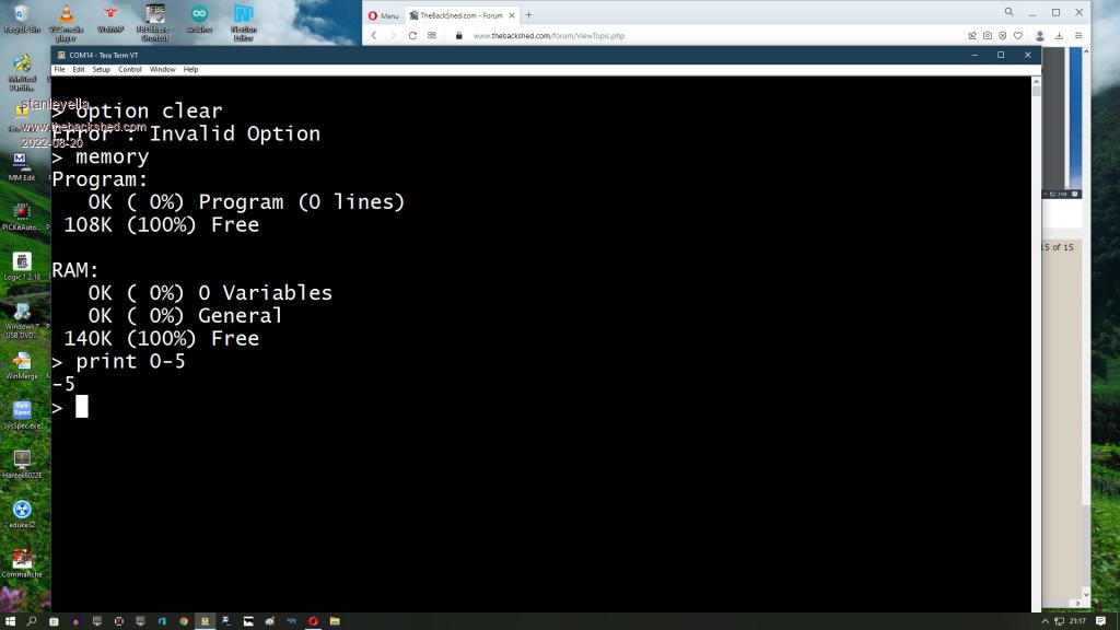

I may find a-d works ok for me but got side tracked getting second rpipico working with lcd. I put the headers in the other way so I could see the "labels" but they're useless and makes it easy to make mistakes as the left right pins reversed.
Also someone mentioned broken molex leads, got to check them not take for granted when got problems. teraterm it works but any lcd it's invalid option or syntax.
Other board works fine. Swapped displays etc.
Got one more rpipico to solder headers to.
Posted: 06:36pm 19 Aug 2022

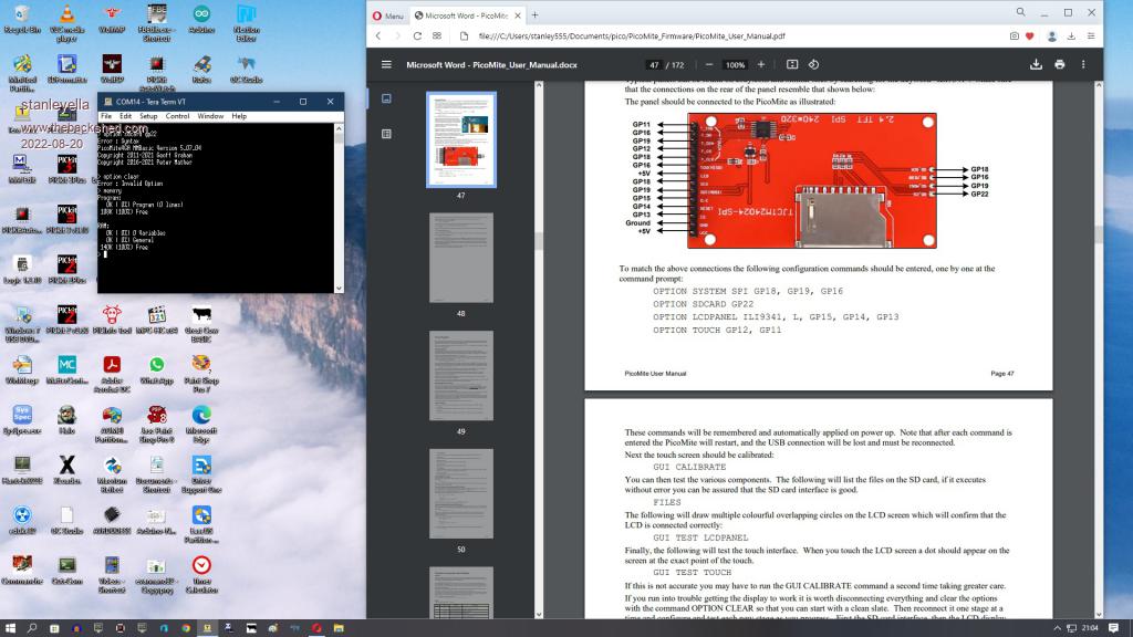

  stanleyella said  teraterm it works but any lcd it's invalid option or syntax.
If you're getting that, it's not the fault of teraterm. Try posting the code and the response.
Posted: 08:05pm 19 Aug 2022
mmbasic on rpipico is working?
no connections to lcd but clear showed errorr as all lcd commands when wired. lcd is working.
Edited 2022-08-20 06:06 by stanleyella

If you want help why not try taking the time to write in English using normal syntax and punctuation. Lots of forum members who don't have English as a first language seem to manage it perfectly well.
Please explain where in the manual you have found the command "OPTION CLEAR" since no-one else can find it?
