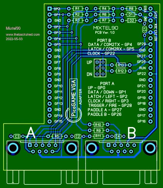

Version 1.4 is the latest posted version. The silk screen on the back is wrong. I've since corrected 1.4 and 1.4A but not re-posted the gerbils yet (gerbils often object to being posted. I think it's something to do with the glue on the stamps). I'll see if I can do that when I get home later.

No schematic, I'm afraid. It's one of the things that got lost in the USB stick failure. Not very important anyway (but I'll need to sort out a parts list for you) as it's basically a Version 1.4 with the following differences:
Port A Trigger/Fire is GP28 instead of GP14
Port B has no analogue port (it was GP28)
Port B has no Trigger/Fire (it was GP15)
As GP28 has changed its function it no longer has a switchable pull-up/pull-down.
This adapter will fail both the prototype and the Version 1.4 test software due to GP28 moving house from Port B to Port A and GP14 and GP15 going walkies.
.zipPicoGAME Adapter 00-[XGerber.zip

These are the latest releases. The screen printing on the back has been fixed. I *doubt* if anything will change now, but I have some version 1.4 boards on their way. The version 1.4A is very similar - details are in the Readme.
PicoGAME 14.zip

Looks good - thanks. I like the circuit layout - will make it easier to troubleshoot during assembly.

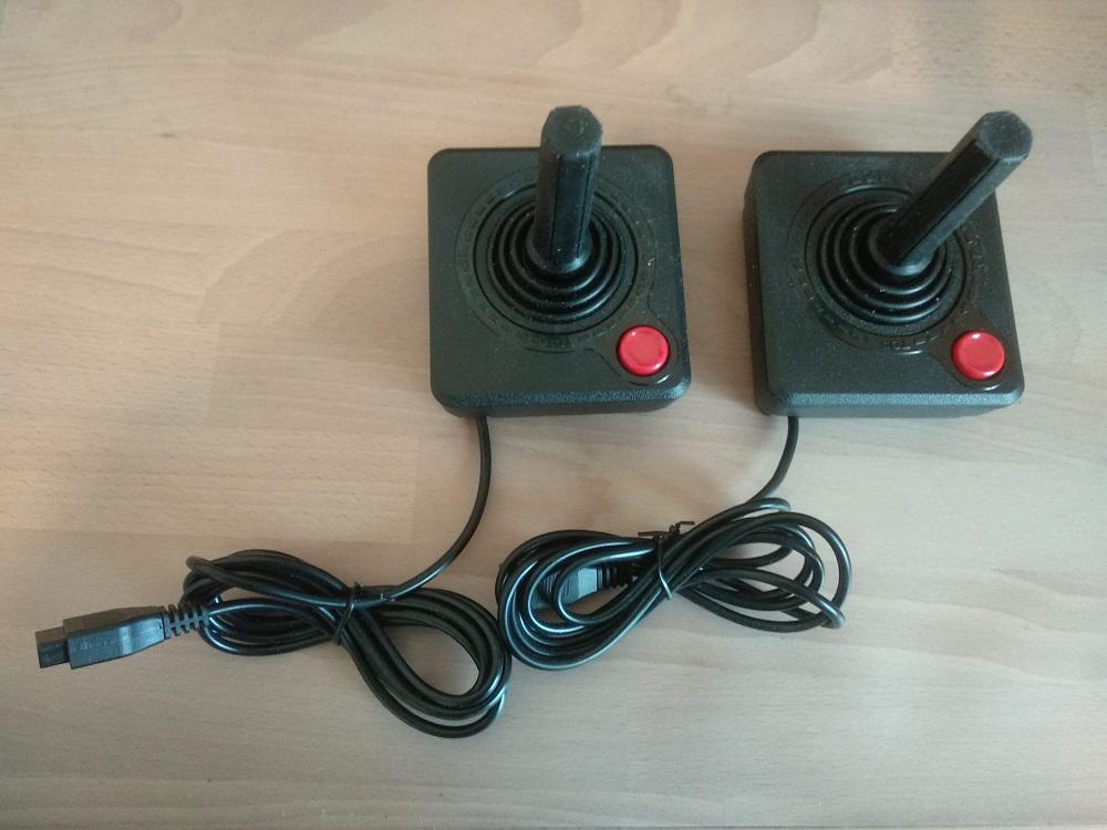

There is a point about joysticks. Old ones will probably have developed oxidised contacts. The oxide layer is very thin, but is insulating and may not break down at 3V3 or 5V when the contact pushes closed. Wiping contacts are ok, as are most gold-plated contacts, but neither of these was common on joysticks. There is a way round this for joysticks that don't have electronics (rapid fire etc.) in them. Use them to switch about 30V-50V a few times at just a couple of mA. The voltage will break through the oxide layer and the contact will almost always work at 3V3 again. Unfortunately, for "clever" joysticks you'll have to take them to pieces and clean the contacts.

I received my boards today also. The footprint for the power connector looks too small for my connector. Any problem using the USB A connector to supply power to the board?

  al18 said  Any problem using the USB A connector to supply power to the board?
I believe so; it's an output (for powering a VGA->HDMI adaptor or charging your phone) not an input.

It can be done, but with care. It bypasses the protection diode and any regulator in U1 position. If you are using the 1.4 board and the recommended USB connector then you'll be ok, but the prototype has the connector polarity wrong! It might be an idea not to fit the regulator and electrolytic until you've checked the polarity at its input. At least you'll know that you're safe then.
The power connectors are reasonable to find, just less common than the usual. I deliberately chose them because they are rarely used for any other voltage than 5V. The bigger ones often have 12V on them.
