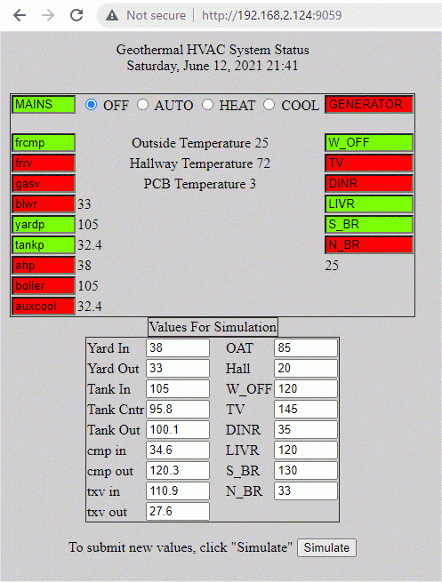

An HTML Server on the PicoMite
This htmlserver.bas was first written for the 64-pin MM+ in 2017. The biggest thing that has changed since in the MMBasic used is the syntax for longstrings. On the MM+ they were implemented by Peter Mather using CSUBs. When he incorporated them into the MMX & subsequent (Armmite, CMM2), he changed to more informative command names.
I spent the day today converting it. The surprising thing to me is that everything worked except for reading a DS18B20 (which I'm sure will work again when Peter gets back and figures out what he did between a13, when TEMPR worked, and a25, when it doesn't).
The program is 990 lines long, 33,548 characters. This is a pretty good workout for the PicoMite, and a tribute to Peter for the work he has done bringing it to this point. I did find some instances where the Picomite couldn't handle long lines with which the MM+ had no problem.
The web connection is using an ESP-01 in AT mode with SDK version 2.0. The original HTML server framework was first published by Peter Mather here (MM2: webserver with AT mode ESP8266).
This instance of the program is a work in progress. I don't remember all that I was doing in 2017, and some things don't work as I supposed they should. Nonetheless it does show what can be done in this line. The program has no guts--that is, it doesn't have the code to actually control a geothermal heating and cooling system based on the inputs. It's original intention was to provide a way to input simulated sensor readings in order to exercise the actual control code.
Code and the needed HTML template file are in the attached zip.
htmlserver.zip
