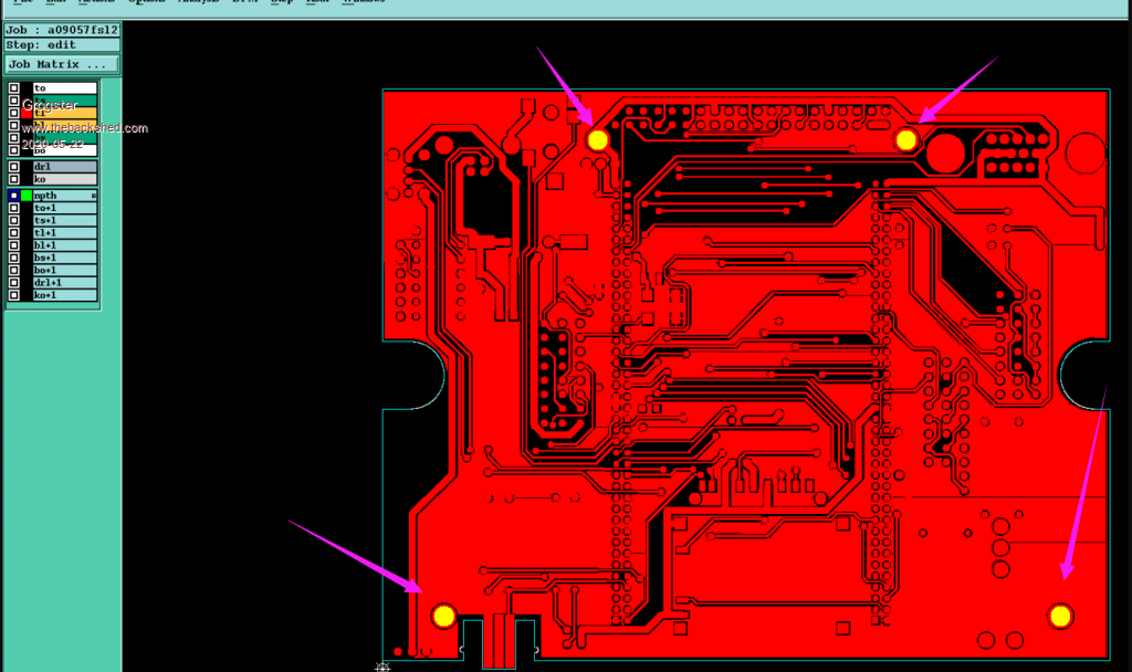

  matherp said  The 4 mounting holes are in the "unplated" drill file so why would they think to plate them?
The copper fill on the top is 3V3, on the bottom it is GND
I got asked the exact same question from my PCB house, but in MY case, I told them to plate-through the holes, as I expected all those points would have been ground.
Does that mean I need to involve Mr. Dremmel and grind out the through-hole plating that is on my ones then, Peter?

I ordered CMM2 boards from JLCPCB, they didn't ask about plating the mounting holes.  I should receive the boards in a few days so a good heads-up to check the mounting holes when they arrive.  I can always drill them out if they are plated.  Also a good suggestion to put fiber or plastic washers under the screw heads.  I do see that on my MMX 144 boards the mounting holes ARE plated but on those boards there are no traces nearby so it makes no difference.

In my case, it was me ordering blank PCB's, NOT via JLC.
JLC had no issues with the board gerbers at all.
I was using PCB GoGo, which is my go-to PCB house for all my own boards.
I will be using JLC for any and all of this design, because of the simplicity of ordering fully-assembled units.

JLC make the PCBs as per the gerbers with no plate-through on the mounting holes.

  matherp said  The 4 mounting holes are in the "unplated" drill file so why would they think to plate them? The copper fill on the top is 3V3, on the bottom it is GND.  In a perfect world, the screws should have a fibre washer under the head on the top....
My decision was just to leave that screw out!  But I might fiber washer my screws all the same.
I started looking at components to see if it was anything more than a power ground... but kinda expected it to be a track if it was carrying voltage.  I wouldn't have expected it to be high!  Glad I opted for unplated.  My gut feeling was "why would you plate a case attachment hole anyway?"

Just to be clear
3 of the mounting holes are completely isolated from any connection on both sides of the PCB. The one near pin39 of the I/O connector is connected to GND on both top and bottom. There is no problem if these holes are through plated.
The only risk is if the screw head is big enough to bridge between the pad round any of the holes to other copper on the top AND if it is tightened with sufficient force to cut through the solder resist.

  matherp said  Just to be clear:  3 of the mounting holes are completely isolated from any connection on both sides of the PCB.  The one near pin39 of the I/O connector is connected to GND on both top and bottom. There is no problem if these holes are through plated.  The only risk is if the screw head is big enough to bridge....
This is great info.

I will leave my through-plated boards as they are then, and just use fibre-washers under the screw head to be sure.
I only have ten of these boards, and if I order more blank ones(unlikely when it is so easy to get all the SMD done at JLC), I will make sure to say unplated if they ask.
