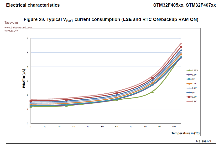

datasheet says:
"VBAT = 1.65 to 3.6 V: power supply for RTC, external clock 32 kHz oscillator"
worst case IVBat is given as 11uA (but typically half that).
I am going for 1.8V as my threshold.
VBAT does arrive through a diode (one half of a BAT54C) but measuring that; the voltage drop seems to only be about 90mV with power off, so I think the PIN() voltage is going to be accurate enough. My concern here is that when switched on, one may not be able to accurately sense VBAT when it dips below VCC. I may end up using an AD pin after all.

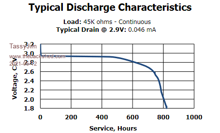

Lithium coin batteries discharge rather rapidly once they get below 2.5V so I would use somewhere near there as a cutoff.
https://data.energizer.com/pdfs/lithiumcoin_appman.pdf
CR1220:
https://data.energizer.com/PDFs/cr1220.pdf
Posts: 9265
Posted: 09:54pm 11 May 2021
I looked at that graph and panicked. Then realised that it's for 46uA and we're more likely to b closer to 4.6uA. :)
Phew!

Posted: 02:30am 12 May 2021
  Mixtel90 said  I looked at that graph and panicked. Then realised that it's for 46uA and we're more likely to b closer to 4.6uA. :)
Phew!
More like 2uA
The F4 board does have a diode pair combining 3.3V with the battery so I assume that Vbat will be the higher of the two (less volt drop).
The H7 boards have jumpers so Vbat readings will make sense.
Even if the F4 board spends most of the time shut down, a good CR1220 will last a few years.

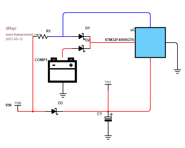

It would be interesting to isolate the 3.3v feed to the diode (Q1) and take it from a digital output instead. Then, under normal conditions, keep that output high to power the clock. To test the battery turn the output off and read the pin. The track is visible on top, right next to the Q1 silkscreen.
dMajo
Joined: 18/05/2020
Location: Italy
Posts: 30
Posted: 09:43am 12 May 2021
  Mixtel90 said  It would be interesting to isolate the 3.3v feed to the diode (Q1) and take it from a digital output instead. Then, under normal conditions, keep that output high to power the clock. To test the battery turn the output off and read the pin. The track is visible on top, right next to the Q1 silkscreen.
Nice idea
and going a bit further you can use an interrupt capable DIO. When set as input you can monitor power supply loss and eg save application parameters (otherwise stored in RAM) while the capacitor backup lasts.
When configuring the DIO as output and driving it low you can measure the battery voltage.
