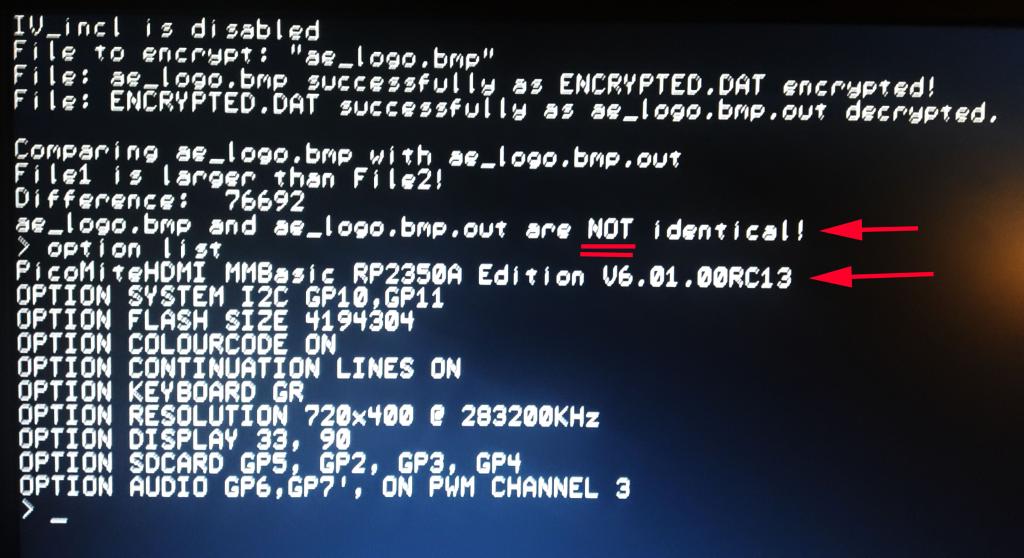

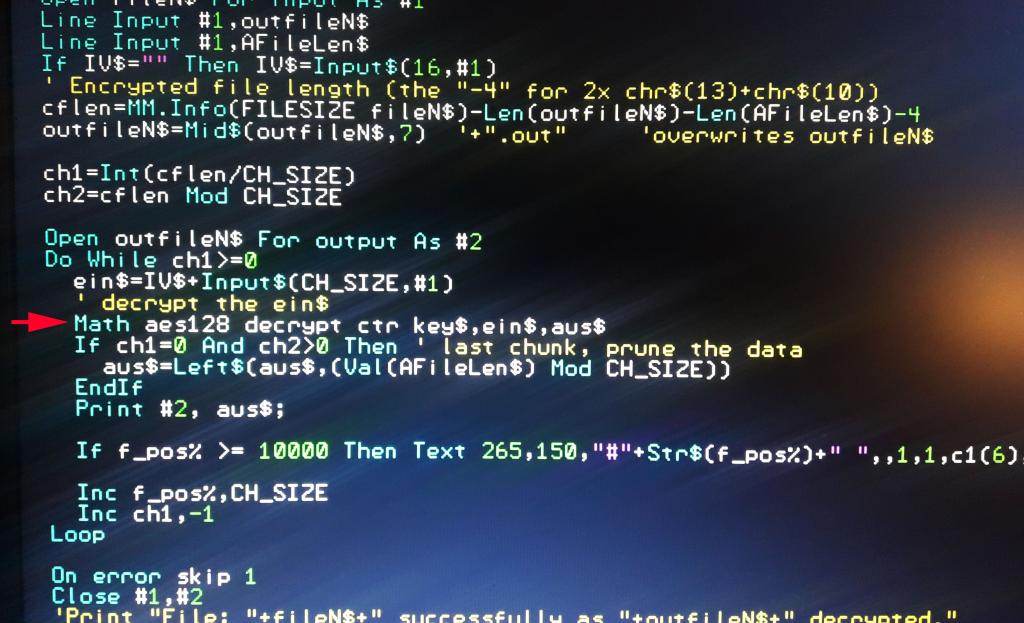

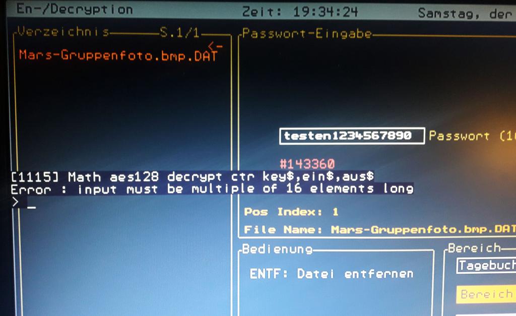

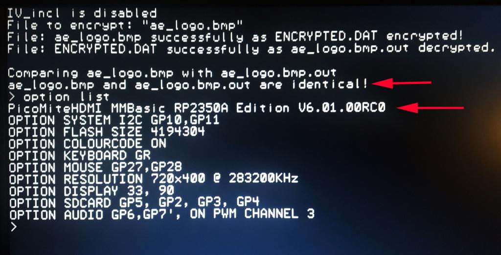

Hi Peter,
I am testing ALL my available working programs with your new RC13 and found another problem (which is also present in RC12 and maybe more down the line, but works in PicoMiteV6.01.00RC0.zip !)
ERROR with AES...
But in THIS version everything is fine:
No problems here, so something is changend with the AES...
Greetings
Daniel
Edited 2025-11-16 05:12 by Amnesie
Posts: 12058
Posted: 07:49pm 15 Nov 2025
I've checked the code and there is no difference from 6.00.02 to 6.01.00RC13. Please provide a test program that you have verified works on 6.00.02. Also specify all options and exactly which version VGA/WEB 2040/2350 etc

Posted: 08:17pm 15 Nov 2025
Hi Peter,
here is the testprogram (only the encrypt / decrypt):
AES_File08.zip
And here is the proof that the files in the different versions are NOT identical
(RC0 vs. RC13) also see the OPTION LIST below:
Greetings
