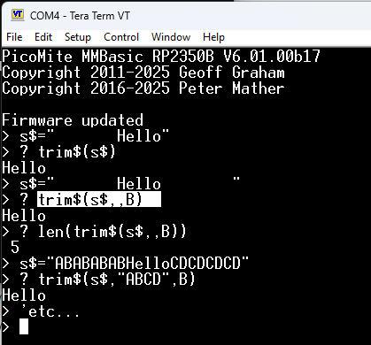

V6.01.00b17
PicoMiteV6.01.00b17.zip
New function by popular request
TRIM$(source$ [,mask$] [,where/where$])
This function can remove characters from the beginning or end of a string or both
source$ is the input string
mask$ is a string containing a list of character to be removed. If omitted it defaults to space
where/where$ can be L, R, or B or a string beginning with L, R, or B to specify characters should be removed from the left of the source, the right of the source or both. If omitted defaults to L

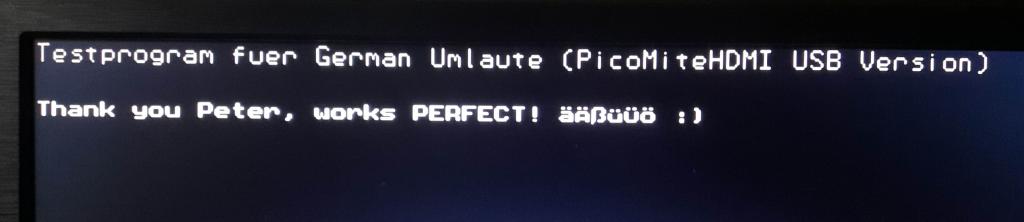

Posted: 07:41am 04 Oct 2025
  matherp said  V6.01.00b18
PicoMiteV6.01.00b18.zip
Minor internal changes
DE USB keyboard should now return codes 200-209 for accented keyboard characters with normal input (input$/inkey$)
Peter, thank you a lot! This works fantastic!
For those German people here, you can test it with my testprogram, which includes
Martins custom font:
german_chars_usb.zip
what an awesome update
