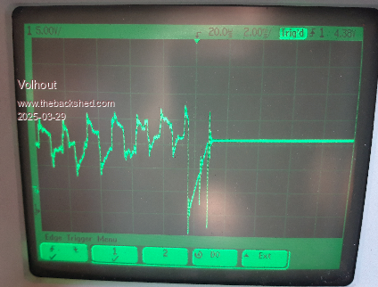

<ctrl>-C and PLAY STOP have a horrible sound now. The samples (for a short time) go to 0 volts (so maximum amplitude). You might better have simply muted the audio (write 50% dutycycle in the PWM. (**)

- play stop and <ctrl>-C still give the terrible click (have not used the scope, but it sounds the same as RC7_4).

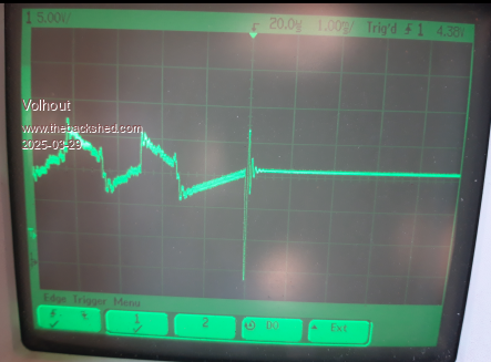

  Quote  play stop and <ctrl>-C still give the terrible click (have not used the scope, but it sounds the same as RC7_4).

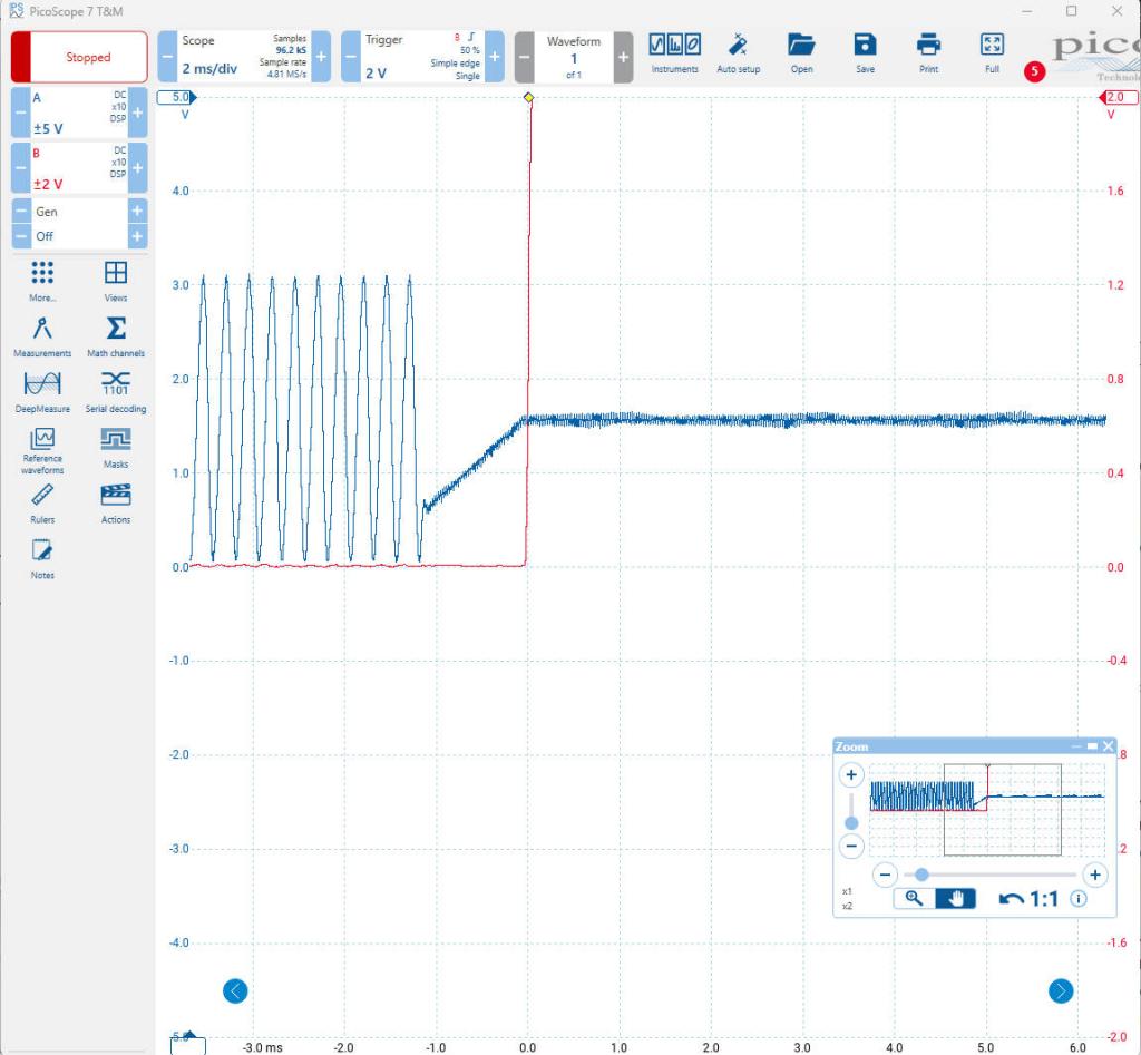

I've checked with the scope and before I could trigger on the pulse - now I can't.
PLAY VOLUME 25,25 PLAY TONE 400,400. Set the scope so it just doesn't trigger on the sine wav. PLAY STOP or ctrl-c and it doesn't trigger. Before I was seeing a spike to GND

OK, I dare you to find clicks now
I used a GPIO pin to trigger the scope as either a timed tone ended or immediately after play stop. There were artifacts on the waveform caused by a couple of issue but I think I've stopped them all
PicoMiteVGARP2040.zip
This is a 4000Hz waveform stopped after 600mSec and you can see the nice ramp from the last level back to centre

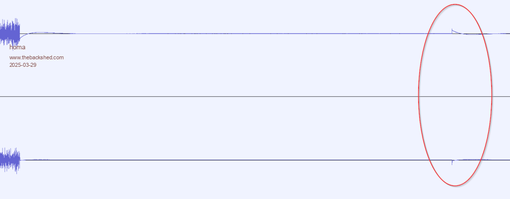

Posted: 04:02pm 28 Mar 2025
I accept the challenge
I have reactivated my old VGA board with the PWM output and installed the latest test version. Unfortunately the rp2040 does not support mp3.
So I used my Sultans.wav for it. What can I say? The sound output is perfect! No PLOPPS to produce, not even with [Ctrl]-[c]. Excellent work Peter!
But the error logic is a bit mixed up.
> play wav "sultans
> play pause
> play wav "sultans
Error : Sound output in use for PAUSED
> play resume
Error : Nothing to resume
> play wav "sultans
> play wav "sultans
Error : Sound output in use for MIDI
> play wav "sultans
> play pause
> play wav "sultans
> play resume
Matthias
Nachtrag:
> play flac "trick
> play pause
> play pause            <-- stop playing with a little little plop ;-)
Error : Nothing playing

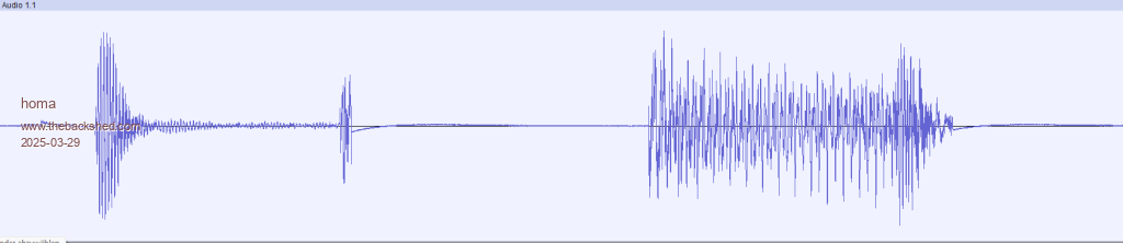

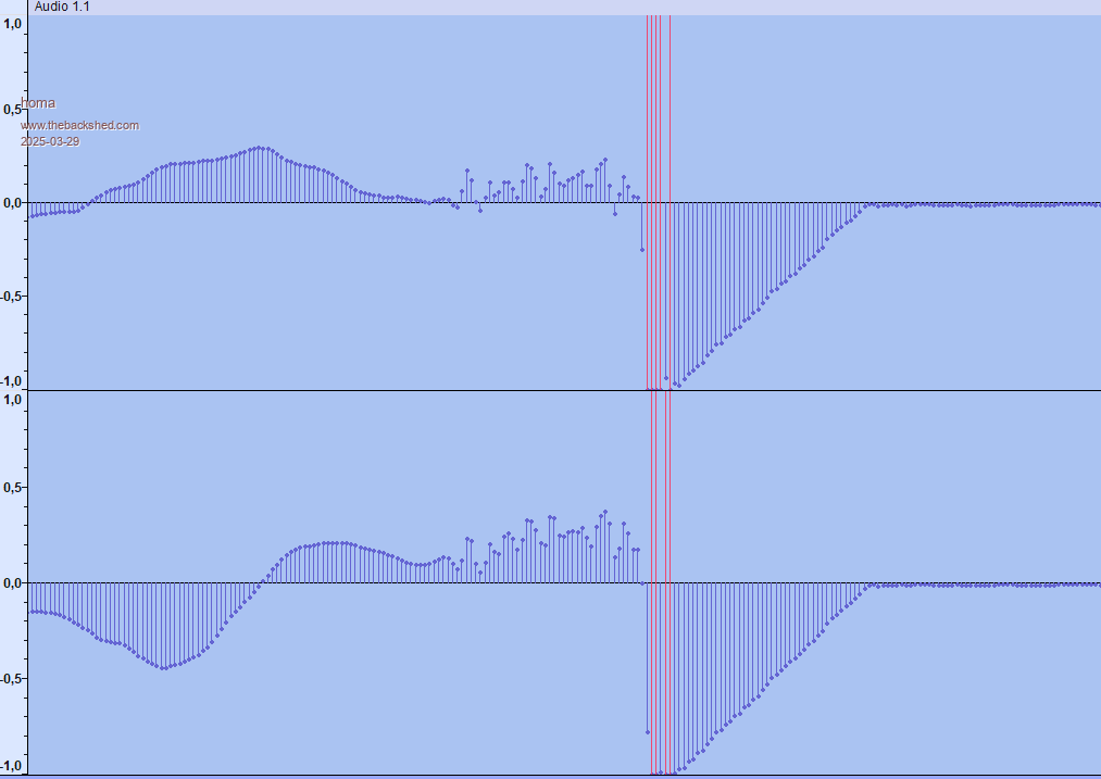

Posts: 6197
Posted: 04:43pm 28 Mar 2025
Sorry Homa,
I have to disagree to some point.
The PLAY TONE is perfect.
PLAY WAV and PLAY FLAC are not always. If feels a bit as if the actual audio sample value has impact on the behaviour. Pictures from a different scope.
Sometimes PLAY STOP is almost perfect. Here a single audio sample is wrong. This is almost inaudible.
Sometimes it is perfect. Like the soft return to 50:50 when playing tone.
But sometimes it is not.
Looking at the PLAY TONE (that always works perfect), the correction is always from values <2000 to 2000 (slope upwards). Also if I look at the waveforms Homa send: the correction is always with a rising slope. If you look at the above picture, the value of the signal is >2000, and should ramp downward to 2000 (falling slope). Is that the problem ?

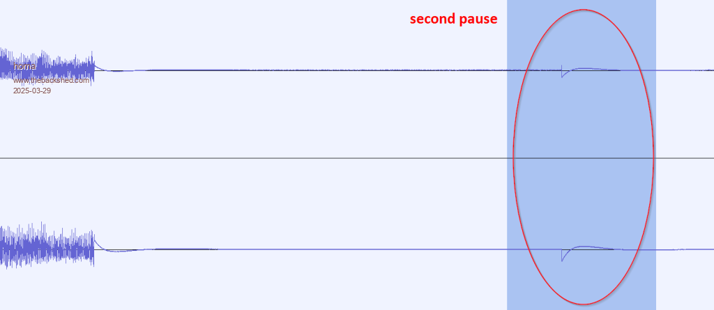

Joined: 05/11/2021
Posts: 725
Posted: 05:25pm 28 Mar 2025
  matherp said  Homa and Volhout - thanks for the testing. Hopefully this one gets there.
You're welcome, thank you for your persistent work.
with the latest version I have the problem in this case,
pause and restart playback too often:
> play flac "trick
> play pause
> play resume
> play pause
> play resume
> play pause
> play resume
> play pause
> play resume
> play pause
> play resume
> play pause
> play resume
> play stop
as a result:
double pause and stop is no longer a problem,
but this is still ...
> play flac "trick
> play flac "trick
Error : Sound output in use for FLAC
> play resume
> play flac "trick
> play pause
> play flac "trick
> play resume
Edited 2025-03-29 03:30 by homa

Last version, playing WAV, 90% good PLAY STOP, 10% still the(a) artefact.
Playing FLAC, have not seen it yet.
This version also plays Kong.
If you are close to release I will carefully test all programs more thoroughly.

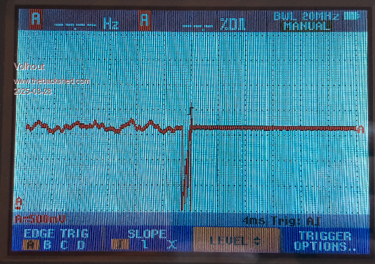

Triggering: I set the volume so it is between 0.5V and 2.8V max. Then I trigger the scope on 0.3V. These extreme glitches always reach 0V.
The PLAY STOP artefact: I thought it looked like performing a signed operation on an unsigned pwm value.
Edited 2025-03-29 05:54 by Volhout

Posts: 6197
Posted: 08:01pm 28 Mar 2025
What Homa is seeing looks what I described as the risk of keeping the last PWM value, and not returning to 50%.
The "tail" of the audio is the AC coupling of the sound card, compensating the DC of the non-50% dutycycle to zero.
Then at resume, you have a charged AC coupling, that is driven by the new (silent ? around 50%) audio, and the capacitor discharges again, with shown result.
