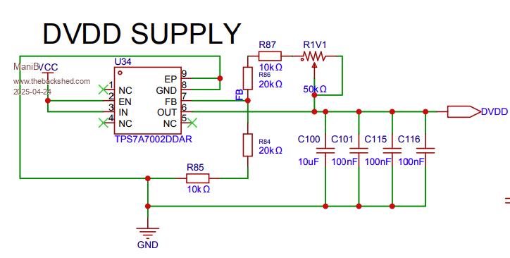

This is the wiring diagram for DVPP supply:
Component: U34 - TPS7A7002DDAR
This is a low dropout linear regulator (LDO) from Texas Instruments.
But what value should DVDD be set to?
Posts: 12056
Posted: 09:39pm 23 Apr 2025
Can anyone else tell me what I need to do to ensure that the date and time are not lost after switching off?
set the time "RTC SETTIME"
  Quote  But what value should DVDD be set to?
1.3V for 1280P, less if you don't want to run that fast

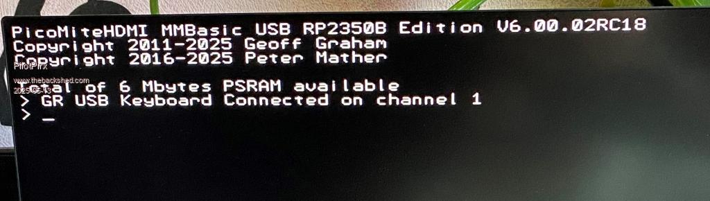

Posted: 06:03pm 24 Apr 2025
  matherp said  OPTION PSRAM PIN GP47
Thanks, now it shows: "Totalof 6 Mbytes PSRAM available"
> memory
Program:
  2K ( 1%) Program (95 lines)
182K (99%) Free
Saved Variables:
 16K (100%) Free
RAM:
  0K ( 0%) 0 Variables
  0K ( 0%) General
6376K (100%) Free

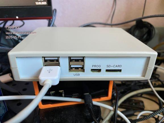

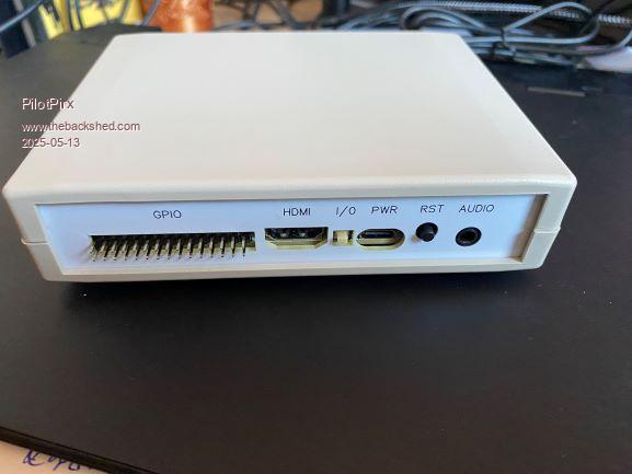

PilotPirx
Joined: 03/11/2020
Posts: 164
Posted: 07:24am 13 May 2025
I have now received the great PicoMiteHDMIUSB from ManiB and am delighted with the quality.
With housing, white labeled front panels, white circuit board, 6MB PSRAM, SD card and all the necessary settings.
I tested it straight away with an old Apple keyboard (German: Krümelschublade) and it works fantastically. MP3 playback also works perfectly.
If I'd had something like this in my Sinclair Spectrum days....  (But it wouldn't have helped, there was no HDMI, USB, SD-card or VGA back then).
To anyone who is interested, I think ManiB still has one left.
Thanks Geoff and Peter for this great software and hardware.
You can see by now that a lot of work has gone into it.
