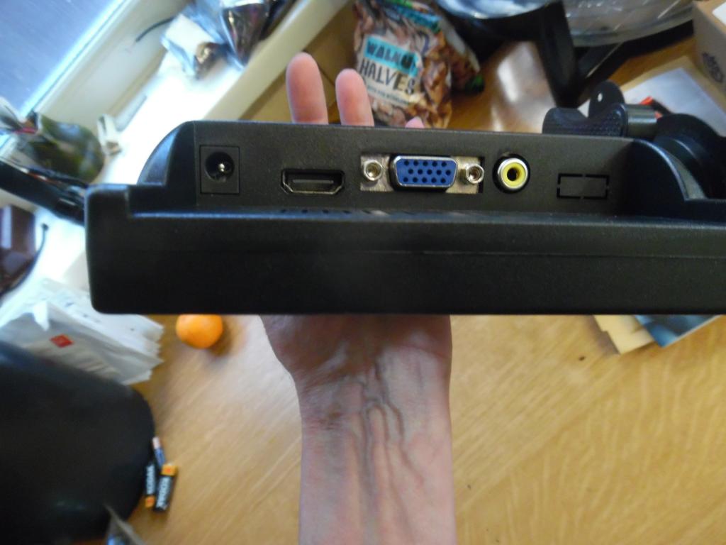

hi PhenixRising. it's a £14 car monitor that's got vga,hdmi,avi composite....but no audio. I posted it before as an alternative to a large screen lcd and cost and pins needed.
ebay and ae is dynamic so good luck finding it.

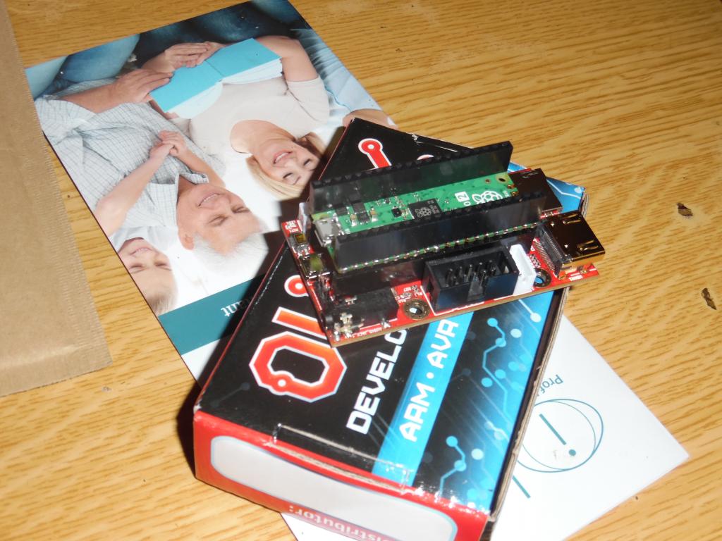

I got 2 pico2 from cpc today and soldered long lead female to male for olimex.
the olimex one went back to ili9341 board picomite2350 and all the setting it up again.
I had to set up the 2350 hdmi again but got glcd and hdmi working fine.
were the female headers a waste of time?
it seems more normal using the pico board pins than sockets
Edited 2024-09-14 05:49 by stanleyella

yeah, makes sense. as said not all the pins are free but my thought was if the pins are connected to the board sockets then use the female headers instead, dunno
Posts: 9246
Posted: 06:50am 14 Sep 2024
I've posted about this earlier. There are few free pins available on the Pico 2. On the Olimex board Some (I2C and SPI) are brought out to the 10-pin connector and a com port is on a 3-pin connector. The female headers are ok for convenience (avoiding the tiny connectors if you have no plugs) or for monitoring but no real use for connecting much as all the pins are allocated to something. You can connect to everything that's even remotely available (sometimes shared) using the existing connectors on the board.

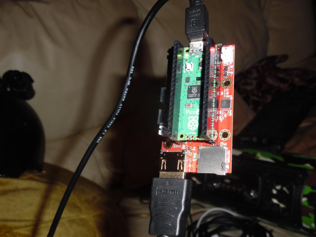

olimex 2350/pico2 hdmi says no files as does pico2 usb vga. they worked before ?
Posted: 06:08pm 14 Sep 2024
I put the sd card that worked in ili9341 card reader into olimex pico2 and it read it fine so dunno what's flashing fat32 files to sd but they are not read??

Stan,
Did you use
OPTION RESET OLIMEX ?
Option platform does not set the pins, only the name.
Option reset set pins and set name
Posted: 07:25pm 14 Sep 2024

yes sir.

Error : There is no valid FAT volume
the card is fine in win 10 but not pico2. tried lots od sd cards
Posts: 9246
Posted: 07:34pm 14 Sep 2024
That version of MMBasic definitely does work with an SD card. I'm using it now, but not on an Olimex.
Posted: 07:39pm 14 Sep 2024
Instead of typing:
>  b:
>  files
What happens if you use:
> drive “b:”
> files
I have exact same setup/firmware as you and I used the ‘drive’ command without issues (and didn’t try what you posted - not in front of Pico now so can’t try what you did).
