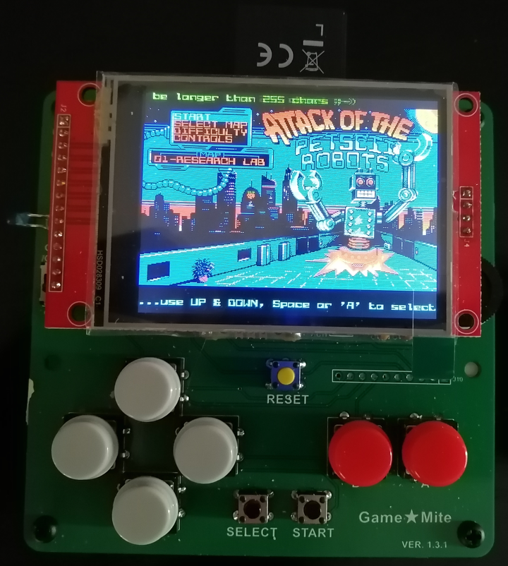

No, I don't have the game running on the GAME*MITE yet, I'm currently just using it for the intro to make sure the controls are supported

Just tested 18j on the Pico-VGA
It is getting better with every Update
Sum issues here and there but you can see where it's going.
I hope I'll get a version with intro ready tomorrow.
It's moving towards the beta version
