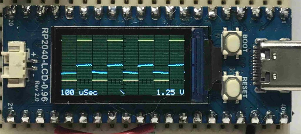

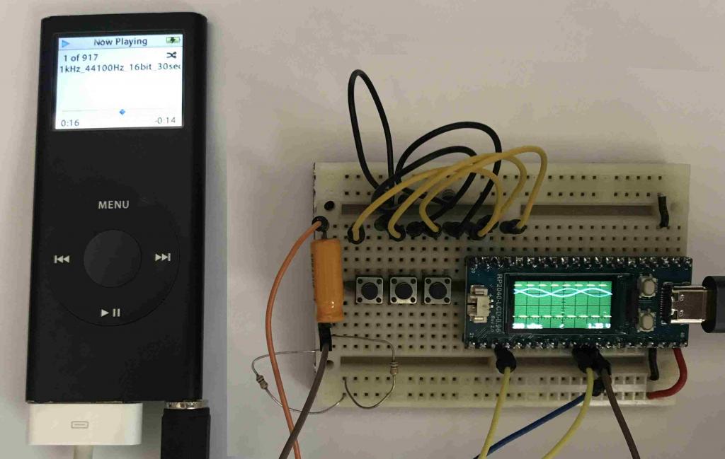

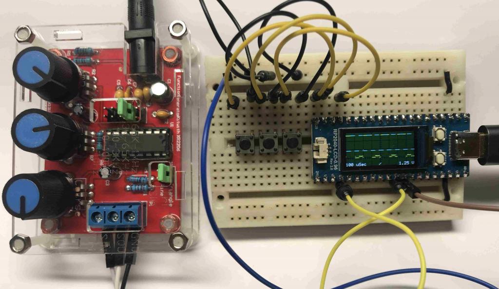

Mick: Mission accomplished! Here's a two trace scope. At the moment, triggering is only done on Channel 1, and the fastest time has dropped from 50 uSec to 100 uSec.
(Pin 31 wired to test signal; pin 32 is floating)
I had been thinking about how to do it this morning, and figured that my first whack at it would fail due to too much memory usage (second buffers for both the raw signal and the displayed trace), but wouldn't you know it, it worked first time out.
What a wonderful environment to code in!

 For y = 0 To VMinor : VMinory1(y) = y*Minor : Next ' for Volts Minor Axis graticule
 ' RP2040-LCD-0.96 - specific values here.
 ' For Voltage, Zero is at pixel 60, 3/4 down the display
 V.Scale(0)= -4.0 : V.Offset(0)=60 : V.MajVolts(0) = 5.000 ' 5.000 Volts per Major Division
 V.Scale(1)= -8.0 : V.Offset(1)=60 : V.MajVolts(1) = 2.500 ' 2.500 Volts per Major Division
 V.Scale(2)=-16.0 : V.Offset(2)=60 : V.MajVolts(2) = 1.250 ' 1.250 Volts per Major Division
 V.Scale(3)=-32.0 : V.Offset(3)=60 : V.MajVolts(3) = 0.675 ' 0.675 Volts per Major Division
 ' For Time,
 H.Freq(0) =   1000 : H.Units(0)="mSec" : H.Seconds(0) = 20.0
 H.Freq(1) =   2000 : H.Units(1)="mSec" : H.Seconds(1) = 10.0
 H.Freq(2) =   4000 : H.Units(2)="mSec" : H.Seconds(2) = 5.0
 H.Freq(3) =  10000 : H.Units(3)="mSec" : H.Seconds(3) = 2.0
 H.Freq(4) =  20000 : H.Units(4)="mSec" : H.Seconds(4) = 1.0
 H.Freq(5) =  40000 : H.Units(5)="uSec" : H.Seconds(5) = 500.0
 H.Freq(6) = 100000 : H.Units(6)="uSec" : H.Seconds(6) = 200.0
 H.Freq(7) = 200000 : H.Units(7)="uSec" : H.Seconds(7) = 100.0
'  H.Freq(8) = 400000 : H.Units(8)="uSec" : H.Seconds(8) = 50.0 - too fast for 2 channels
 ADC_select = 3              ' Select from a number of time scales
 Vselect    = 1              ' Select from a number of Scale factors and offsets for volts
 Trig_Type  = Trig_Down      ' Select from a number of trigger types
Sub Initialize_Hardware
 SetPin V_SW, INTL, V_ISR, PULLUP ' Switch to cycle through Voltage scales
 SetPin T_SW, INTL, T_ISR, PULLUP ' Switch to cycle through Trigger types
 SetPin A_SW, INTL, A_ISR, PULLUP ' Switch to cycle through ADC Frequency (Time) scales
 SetPin GP18, PWM1A               ' Set up pin 24 for PWM test signal output
 PWM 1, PWM_Freq, PWM_Duty        ' Square wave on Pin 24
 SetPin (31), AIn                 ' ADC input on Pin 31
 ADC open H.Freq(ADC_Select), 2   ' Sample at specified frequency
 FRAMEBUFFER CREATE F
 FRAMEBUFFER LAYER  L
Sub Set_ADC_Timing
 ADC FREQUENCY H.Freq(ADC_Select)
Sub Draw_Graticules
 Local STRING T$, V$, A$
 FRAMEBUFFER WRITE L
 CLS Background
 Line HMinorx1(), HMinory1(), HMinorx1(), HMinory2(), 1, GMinor ' Draw minor horiz graticules
 Line VMinorx1(), VMinory1(), VMinorx2(), VMinory1(), 1, GMinor ' Draw minor vert  graticules
 Line HMajorx1(), HMajory1(), HMajorx1(), HMajory2(), 1, GMajor ' Draw major horiz graticules
 Line VMajorx1(), VMajory1(), VMajorx2(), VMajory1(), 1, GMajor ' Draw major vert  graticules
 A$ = Str$(H.Seconds(ADC_Select),3,0) + " " + H.Units(ADC_Select)
 Text    0, Vres, A$, LB, 7, 1, TxtColor, Background     ' Draw Time Scale at Lower Left
 V$ = Str$(V.MajVolts(Vselect), 2, 2)+" V"
 Text Hres, Vres, V$, RB, 7, 1, TxtColor, Background     ' Draw Volts Scale at Lower Right
 Select Case Trig_Type
   Case Trig_Up:   T$ = "/"
   Case Trig_Down: T$ = "\"
   Case Trig_None: T$ = "-"
   Case Else :     T$ = " "
 End Select
 Text Hres/2, Vres, T$, CB, 7, 1, TxtColor, Background    ' Draw Trigger at Lower Middle
Sub Randomize_Test_Signal
 PWM 1, PWM_Freq, PWM_Duty+PWM_Jitter*Rnd  ' Randomize duty cycle to ensure displayed signal is refreshing
Sub Get_Samples               ' Load ADC inputs into sample() array
 trace1(2*Hres-1) = -1       ' Samples will never be < 0
 ADC start trace1(), trace2()
 Do While trace1(2*Hres-1) < 0 : Loop
Sub Scale_Samples
 Memory copy FLOAT addr.trace1 + trigger*8, addr.buffer1, Hres
 Memory copy FLOAT addr.trace2 + trigger*8, addr.buffer2, Hres
 Math Scale buffer1!(), V.Scale(Vselect),  buffer1!()  ' Scale samples to fit vertically
 Math Scale buffer2!(), V.Scale(Vselect),  buffer2!()  ' Scale samples to fit vertically
 Math Add   buffer1!(), V.Offset(Vselect), buffer1!()  ' Offset to bottom of screen (positive is up)
 Math Add   buffer2!(), V.Offset(Vselect), buffer2!()  ' Offset to bottom of screen (positive is up)
Sub Update_Display
 FRAMEBUFFER COPY L, F
 FRAMEBUFFER WRITE F : Pixel Horizontal(), buffer1!(), T1_color
 FRAMEBUFFER WRITE F : Pixel Horizontal(), buffer2!(), T2_color
 FRAMEBUFFER COPY F,N
Posts: 9249
Posted: 08:20pm 04 Sep 2023
LOL! Excellent. I wondered if someone would take me up on that one. :)
I anticipated that the ADC would now run at 1/2 speed compared to a single channel, so the maximum displayed frequency will be lower. Very pretty though. :)
Posted: 08:45pm 04 Sep 2023

Posted: 08:55pm 04 Sep 2023
Here's a photo using both the on-board test signal (from which trigger is derived) and an off-board XR2206-based (but exceedingly crappy) "signal generator" (well, my test leads are nothing to brag about either).
I don't have access to better signal generators. Sorry!
Posts: 9249
Posted: 09:09pm 04 Sep 2023
Unfortunately you almost certainly can't display a sine wave from that without level shifting the input. You are seeing just the top half of the sine, the bottom half is being clipped.
This will bias the trace to mid voltage (about 1.65V) and let you see both halves.
              3V3
              10K
       100nF   |
input---| |-----+---------- ADC input
              10K
              GND
It's always a good idea to put a capacitor on the output from those. IIRC the XR2206 uses a virtual ground so the output signal is +/- around half the supply voltage. I can't remember the circuit of those little devices, but I know they are very basic.
A series resistor (4k7-10k) is a good idea too, to protect the ADC input.
Edited 2023-09-05 07:25 by Mixtel90

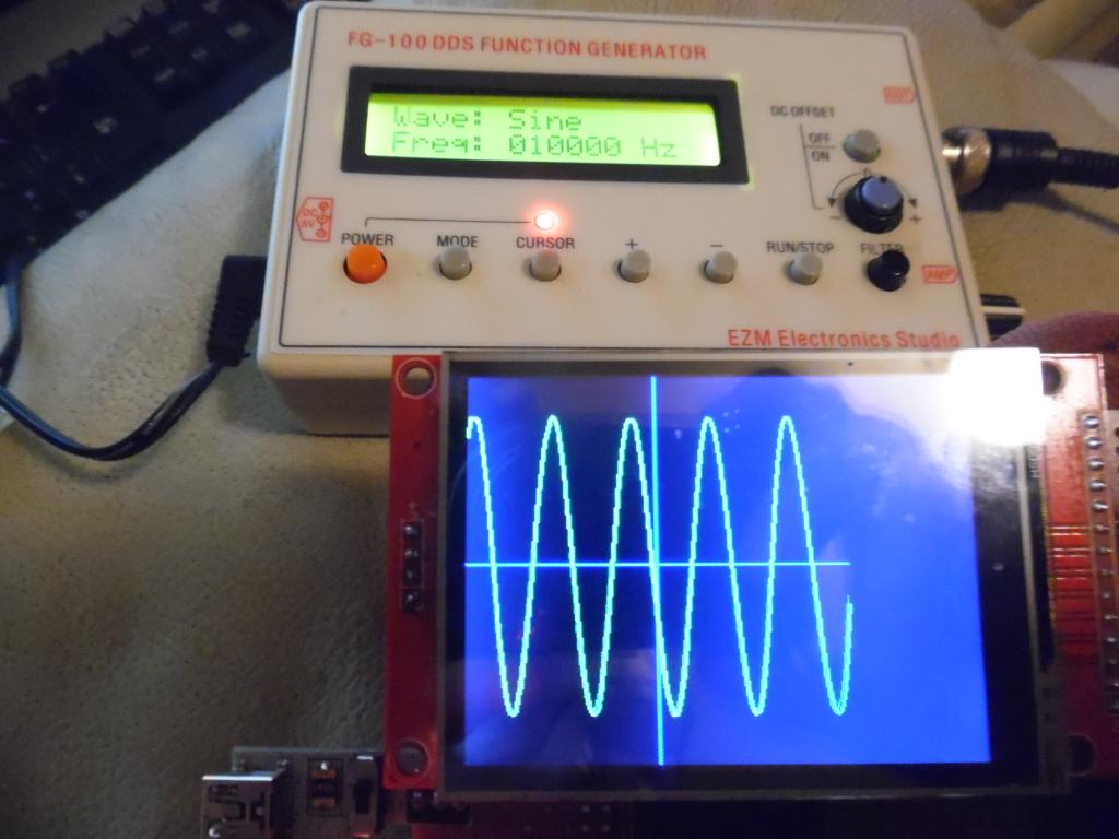

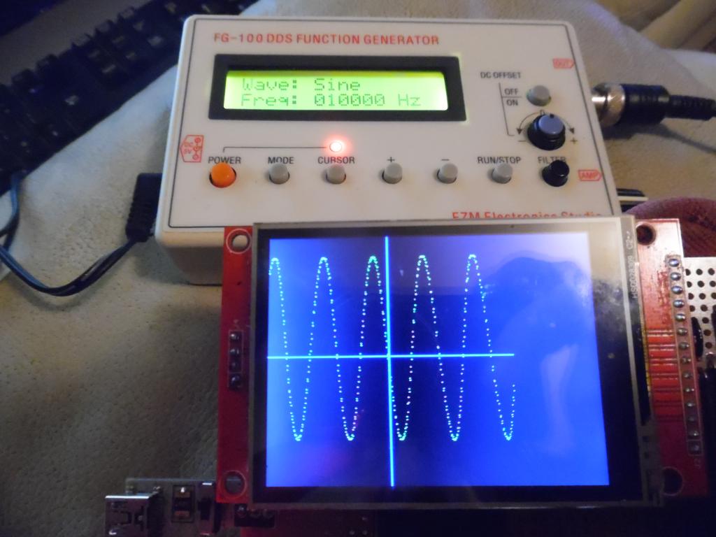

Posted: 09:37pm 04 Sep 2023
I got XR2206-based (but exceedingly crappy) "signal generator" as well. they messed the circuit for cheapness but it can sweep freq which tests a scope.
I posted this over a tear ago using lcd and 2 adc in but no 90 deg sines.
Mean time I changed my simple scope from line to pixel. Dunno if I like pixel,I'll sort a sine. Trigs ok. guess it's faster than line.
for x%=0 to 238 'screen width
     'line x%,samples!(x%+c%),x%+1,samples!(x%+1+c%),,rgb(green) 'draw new sample from sample(c%)
     pixel x%,samples!(x%+c%),rgb(green) 'plot new sample from sample(c%)
   next x%

Posted: 10:02pm 04 Sep 2023
Well, that's better. Reviewing the XR2206 IC schematic, it's biased up to half the (9V) supply voltage, so it's a wonder that I got anything at all.
With a 47 uF capacitor (your previous recommendation) and the 10K resistors, a 1KHz tone played from my old iPod looks decent. The square wave is internally generated on the Pico.
Posts: 3417
Posted: 10:17pm 04 Sep 2023
The photo with my scope prog. used the same cheap signal generator. Its output has a DC bias so all that is needed is a pot to reduce the level to suit the Pico.
Its own level control does not change the DC bias.
@Stan, speed isn't very important on my scope as does not erase and redraw the whole screen all in on go.
It only erases one vertical line at a time and drawing the new pixels on it before moving on to the next. Most of the time it is seamless.
Edited 2023-09-05 08:18 by phil99
Posted: 10:18pm 04 Sep 2023
Pixels look ok with sines,you can tell it's a sine. Dunno about squares as my usb hantek dso draws waves not plot so what a real scope look like? rhetorical.
