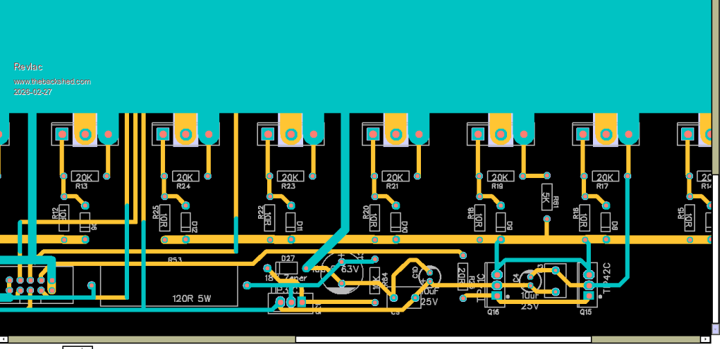

Revlac
Joined: 31/12/2016
Posts: 1309
Posted: 02:33am 27 Feb 2026
Also agree with comment above.
Brian, did you (or someone else) see the last Gerber PCB mad board file, there might have been some changes to the power board Depending on which board you have, the latest has a 10K on Pin 1 of the TIP35C, as well as the 18v Zener,  my board has not got the 10K, not sure if there was anything else, or if that is correct?
Don't want to create any confusion, but worth checking solder joints around the TIP41 and 42C just to be sure.
Cheers Aaron

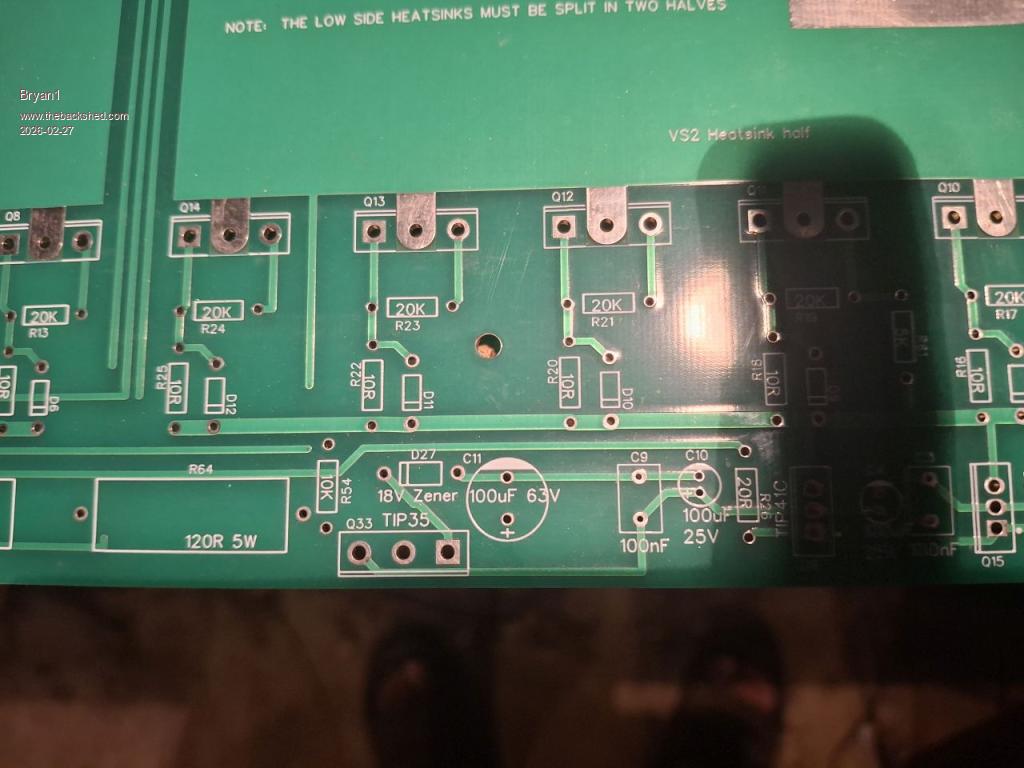

Hi Aaron I do have that latest board but that 100uf cap is around the other way

Both boards look right with respect to the CAP, different tracks, unless I'm blind.

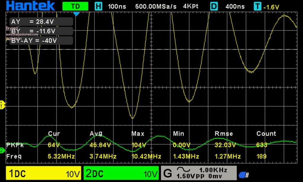

Posted: 11:37pm 28 Feb 2026
Ok with this wet weather got the noise of my genset going to charge the shed battery.
Anyway powered up the controller board and measured 17.8 volts on the 18V zener, now when the ohm meter is used the Vbat + and VBat - are shorted out. Doing an ohm check on a few fets shows the gate is isolated and the source and drain pins are a dead short, so would this mean the fets are gone?
Anyway setup the scope and got a pic of the L01 and L02 first test
Regards Bryan

They should not be the L01 and L02 of the un-driven power board. They should be the L01 and L02 signals coming from the controller board.
TinyT I put a 10 connector on the end of the ribbon cable where VS1 and VS2 were connected to the ground on the connector.
