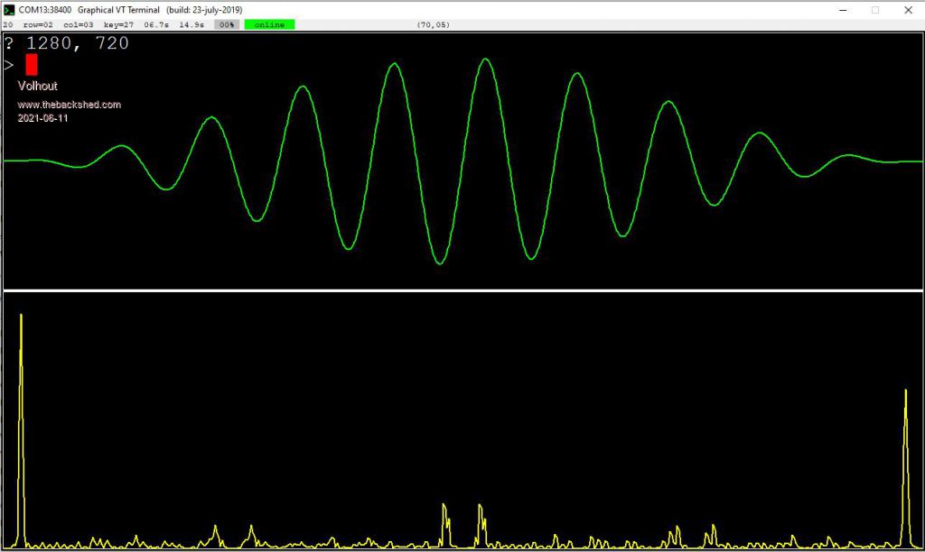

@Peter: there is something wrong with MATH FFT
Yesterday I tested MATH FFT MAGNITUDE on the pico using a 1024 size array, and reported the output was a spectrum. I however did not fully trust the result, as there where spurious peaks in the spectrum I could not explain.
Last night (yes, deep in the night) I tried to reproduce on the CMM2. But the CMM2 gave similar results. I was not sure if it was me, who did not understand FFT, or something wrong with both implementations.
I noticed the peaks in the spectrum could be reduced by applying windowing on the input signal, so I experimented with windowing on both pico and CMM2, and bot behaved the same, but different from what I would expect.
Here is a picture of the pico result of a windowed (sin^2 window) sine wave and the resulting spectrum.

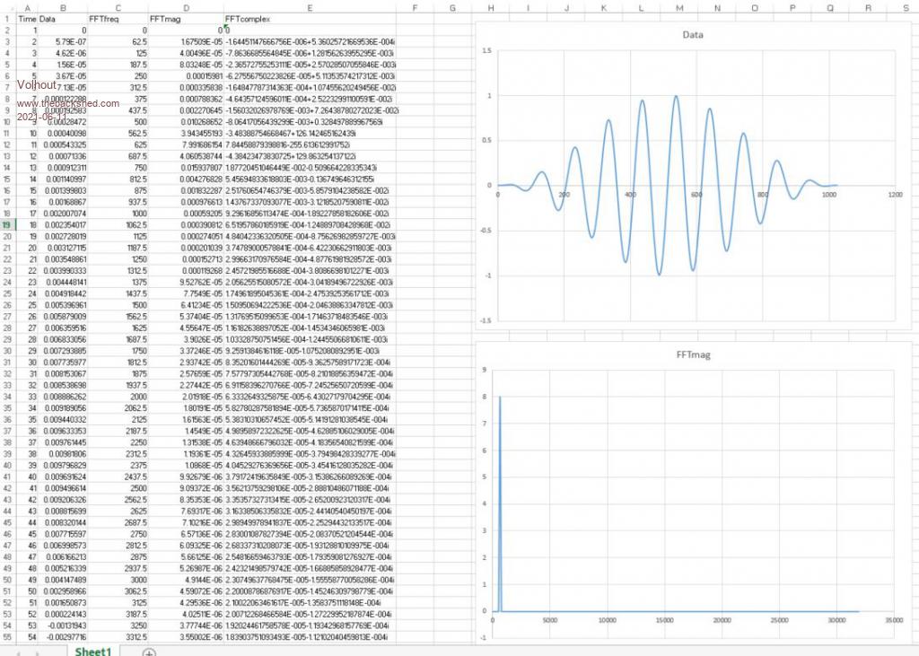

However, if I input the data in excel, and use the analysis toolpack (contains fft) on the same dataset, the result is different, and in line with what I would expect.
This is a difference I cannot explain. The excel magnitude graph is clean, no spurious. At least not in this linear magnitude view.
The only thing I can think of that could explain a bit is that the MMBasic magitude  plot is in some kind of logaritmic scale. But even then, the enormous peak at the right side should be visible in the linear view in excel.
Note that both plots show 0-511 values of the 0-1023 fft array.
Below the test program I used for this test. It is not nice formatted because I was constantly trying to find the bugs in it, and add debug routines.

Posts: 12084
Posted: 01:06pm 11 Jun 2021
Is the basic FFT correct?
Posts: 6209
Posted: 01:36pm 11 Jun 2021
  matherp said  Is the basic FFT correct?
I just tried running the normal FFT and calculate the magnitude samples from:
Magn = sqr(Re^2+Im^2) and get the exact same result. Something fishy in the fft function. But it is the same in the CMM2. If you solve it there, you solve it in pico...
Could it be something with the format of the float used ? But if I look at your earlier post for the H7 the FFT graph (magnitude) did not show the high peak at the right of the spectrum (and you also plotted 512 values from the 1024 array). Could it be something that was changed with the H7 -> CMM2 transition. And now pico inherits...
Edited 2021-06-11 23:40 by Volhout
