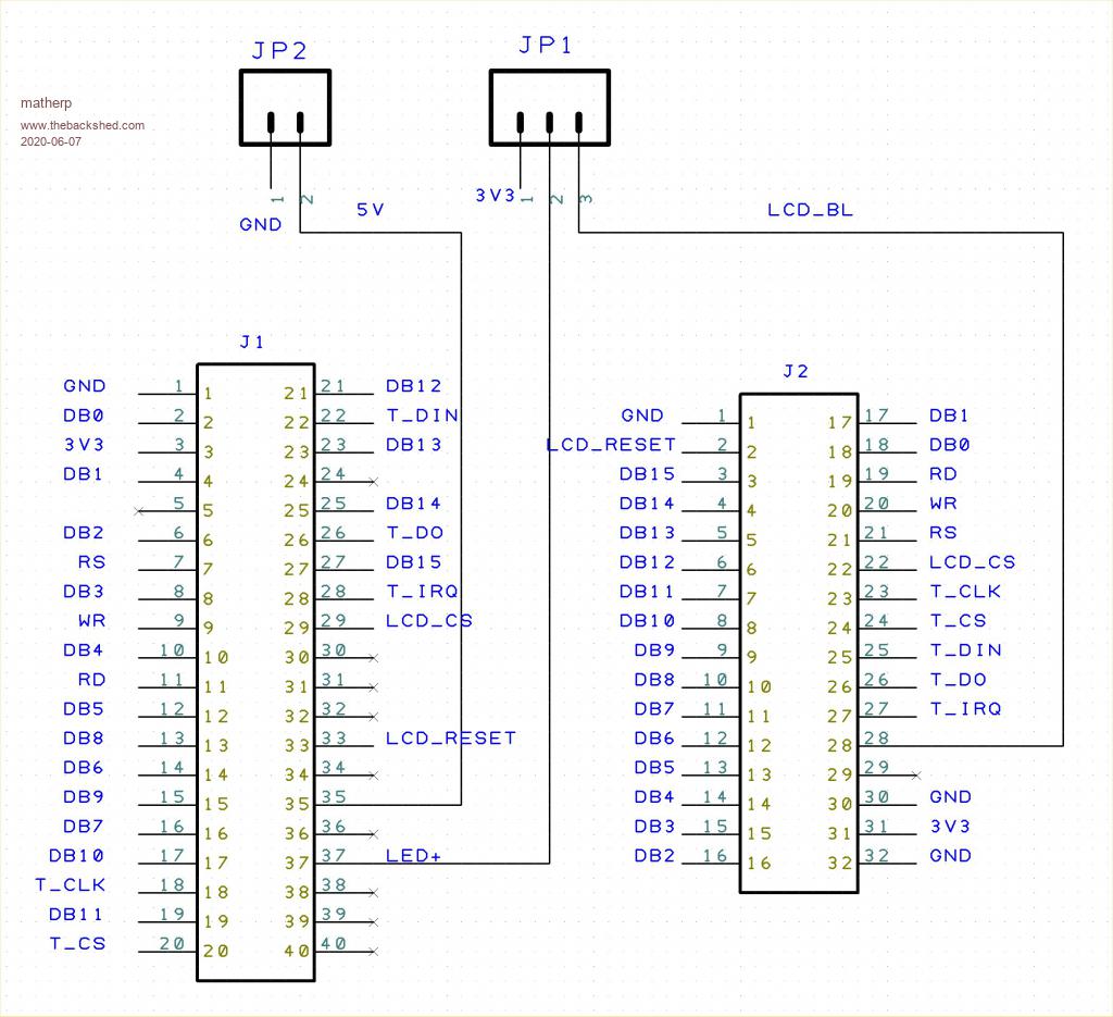

Attached is the wiring for the SSD1963 adapter I did
Disable the ILI9341 with
OPTION LCDPANEL DISABLE
then enable the SSD1963 with
OPTION LCDPANEL SSD1963_n_16,orientation
n should be 4, 5, 5A, 7, 7A, or 8 (same as the MM+)
orientation should be L, RL, P, or RP
Then setup touch if required
OPTION TOUCH PB12, PC5
GUI CALIBRATE

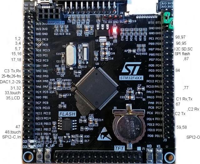

Hi Guys,
I too have a couple of these boards, programmed with ARMmite MMBasic Version 5.05.09.   I sure could use a list that showed the mapping of the pins on the board (by name PE0, PA2,,, etc) to the functions (COMx, I2Cx,,, etc) in MMBasic.
Any help would be great.
Don
Posted: 12:26pm 16 Jul 2020
This is what I made up for my use:
Also this from I'm not sure who:
F4 Pin Functions.zip
Edited 2020-07-16 22:34 by lizby

Hi lizby,
That is Excellent, thank you so much.
Don

Posted: 01:20pm 16 Jul 2020
Here is the "official" mapping, and yes you can use the pin name whenever you need to specify a pin as the Captain says

Canada_Cold
Joined: 11/01/2020
Posts: 57
Posted: 03:02pm 16 Jul 2020
Thanks, Don

hello,
i want to know which pins are 5volt tolerant i want to count pulses from a brushless motor driver
thanks
Posted: 09:44pm 17 Jul 2020
  Quote  i want to know which pins are 5volt tolerant
Try the datasheet for the chip
