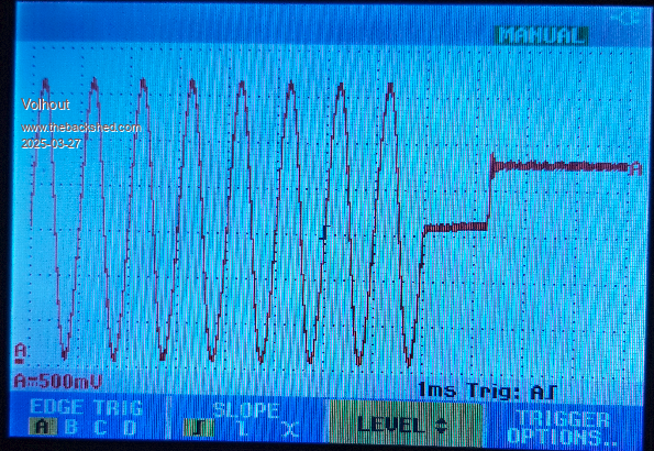

@Peter, Homa,
On my 2040 VGA (PWM audio) design, when I power it on, there is 2.3Vdc at the output.
Since the PWM audio should be centrered around 50% (of 3.3V) equals 1.65V, the 2.3V  causes a jump at the start of each sound played. I see the same at the end of each tone.
I have a scope picture that shows it. This is from PLAY TONE 1000,1000,50
Also at the end of the tone, this offset of 2.3V is restored...after 1.2 milisecond.
I think the initial value of the Timer Compare Register should be half the value of the Timer Wrap Register. Also with every sample frequency change this default value should be set.
P.S. this is RC7_2
Edited 2025-03-27 05:18 by Volhout

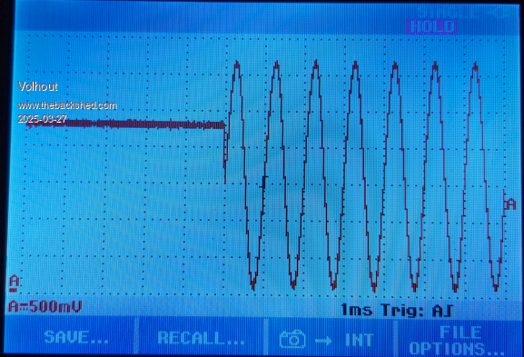

Posts: 6197
Posted: 07:33pm 26 Mar 2025
@Peter,
These DC jumps also happen at PLAY PAUSE and PLAY RESUME of a WAV file,
So I think it is just a wrong default value programmed in the PWM when the PWM is idle. When playing samples, it is nicely centered around 1.65 V.

Posts: 6197
Posted: 07:10am 27 Mar 2025
Hi Peter,
When I PLAY TONE 400,400 and stop it with PLAY STOP, I get nice 50:50. Confirmed.
Observations:
When I PLAY WAV "xx" and the tune ends, I am at 50:50. Confirmed. Play stop always returns to 50:50.
When I PLAY TONE x,x,y and the tone ends after y ms, it ends at 2.3V (69% PWM). tested several frequencies, all end at the same level. Several different times. Always the same 2.3V. So there is no relation between frequency and time for the level 2.3V.
When I PLAY WAV, then PLAY PAUSE, I get 2.3V. The same 2.3V. Even if I started with a power cycled unit that has 50:50 at start of the play wav.
This is VGA design 2 RP2040.
Another observation: after power on (without anything playing) the initial value is 50mV lower than the 1.65V (1.60V), as if the default PWM is set to 48.5%. This is a minute difference, and may even have a different cause. (i.e. changing drive strength of the IO pins) So ignore this for now, but it may give a lead into the other issue.
So in summary: when PLAY TONE ends by the set time, and with PLAY PAUSE this happens. PLAY STOP does not.
P.S. I have never seen your 41%. It is always 69%. Maybe it is taken from some not-initialized memory location ?
Edited 2025-03-27 17:24 by Volhout

Really solid 69.7% duty cycle at 44.1kHz .
idea:
The PWM at 44.1kHz is around 11 bits actual. Could it be that you write the mid position of the 12bit DAC MCP4822 to the PWM ? That would boil down to this roughly 70%.
Edited 2025-03-27 18:12 by Volhout
Posts: 12059
Posted: 08:21am 27 Mar 2025
  Quote  Another observation: after power on (without anything playing) the initial value is 50mV lower than the 1.65V (1.60V), as if the default PWM is set to 48.5%. This is a minute difference, and may even have a different cause. (i.e. changing drive strength of the IO pins) So ignore this for now, but it may give a lead into the other issue.
This bit is deliberate. The audio code centers on 2000/4096 and allows swings between 0 and 4000
  Quote  When I PLAY TONE x,x,y and the tone ends after y ms, it ends at 2.3V (69% PWM). tested several frequencies, all end at the same level. Several different times. Always the same 2.3V. So there is no relation between frequency and time for the level 2.3V.
