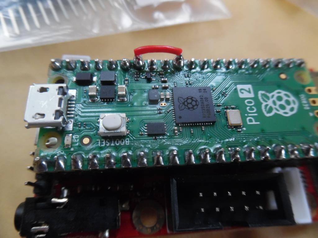

I soldered a link gp26 to gp28 to get stereo. what fiddly job hence female to male headers that just arrived but 2 pico2 shipped from farnell/cpc. It plays mod and wav from sd card.
the tv syncs mode 1 to 5 stable but not what expected and memory errors playing mod files and frame layers.

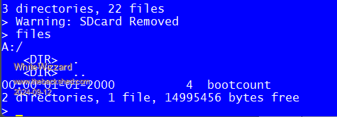

Went to test the SD card first (DRIVE "B:") and could successfully read files on a uSD card. However,  when the SD card is removed I get a warning message appear (this is ok - but could be annoying if a program is running), but on re-inserting the SD card, subsequent FILES report back on Drive A (flash) rather than remaining pointing to the SD. Is this the expected behaviour rather than only changing back upon the user typing DRIVE "A:"?
Posts: 9246
Posted: 05:47pm 11 Sep 2024
Yes, that's normal. The SD card is checked periodically to see if it's there. If it isn't and it has been then MMBasic assumes that it's an error and reverts to A: until B: is manually reselected again. I suppose the CD switch could have been used but that would take another precious GPIO pin to handle it.

soldering a simple link between gp26 and gp28 is easy to jigger your board.
lucky me it worked hence female headers with long leads for next pico2 from farnell.
pihut sold out of olimex pico dev boards.
olimex pico board is great for the price and better than wiring sd card reader,sound filter and 3.5 stereo, hdmi socket to strip board.

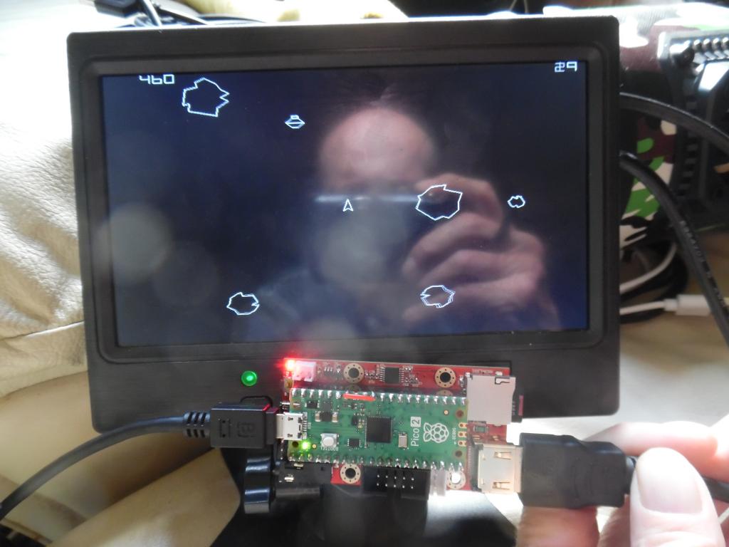

Posted: 10:38pm 11 Sep 2024
bubble universe works in mode1, mode 2,not mode 3 [13] FRAMEBUFFER CREATE F
Error : Not enough memory
> mode 4 RUN
> mode 5 lots of colours . one frame a second..2040 vga was faster?
show me 2040 pico2 compatible code to see speed increase but vga vs hdmi.
pico2 vga or glcd  is faster.
this tv locks to hdmi so talk of no 5v on hdmi??
hdmi is interesting.using mode 3 to play rocks13 with play commented and it works and fills the screen ok, no sound is sad hdmi is interesting
hdmi is new but better than vga? more testing on car monitor with hdni, works vga.
also try hdmi to vga,needs 5vusb tomorrow cos someone mentioned it recently
Edited 2024-09-12 10:20 by stanleyella

Posted: 03:40pm 12 Sep 2024
hdmi works with car reversing monitor
syncs and just works whereas other's getting problems? meaning I been lucky hdmi works for me?

  stanleyella said  hdmi works with car reversing monitor
Your monitor has HDMI? (I know nothing about this stuff)
Any chance that you could show a high-res image and/or text, please?
