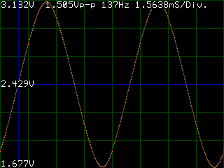

And here we are, back in Venice with more... Scope progs. *
Now with optional automatic Frequency and Voltage adjustment, thanks to Peters Math Window.
Hopefully the comments in it are helpful.

Stan, no Subs, all linear to make following it easier.

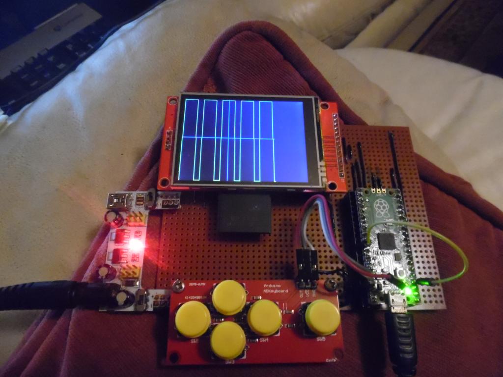

I know you've made other changes but in addition...
Everything after the quote (') up to the end of line is ignored.
Posted: 02:05pm 04 Sep 2023
In the last photo I posted "frame and layer L works on ili9341" the button pad is analogue to gp26 but now that's scope input adc0. Could I still use adc1 for the button pad or would I lose adc resolution?
The button pad works, it was a Tron game running and was more responsive than gui touch area for playing the game.

Posted: 03:00pm 04 Sep 2023
  Mixtel90 said  No, you should probably be fine using ADC1 or ADC2 for your buttons if you are using SETPIN GP27, AIN for example. Only ADC0 is being scanned automatically.
The pad code was

It works on 3.3V but sold as arduino so meant for 5V but 5 buttons using 1 pin is neat and it was cheap. stan
ps. no debounce code
Edited 2023-09-05 01:07 by stanleyella
