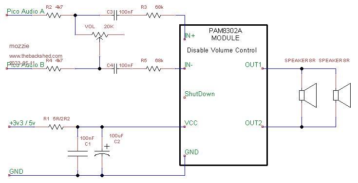

G'day,
Not sure the audio gods are ever satisfied, hence my choice to generally ignore them, Audio Agnostic perhaps
@Thwill
Driving the pwm straight into the PAM pushes it straight into clipping, even with any volume control pretty much shorting the inputs it will have enough gain for the common mode signal to overdrive it. This was the subject of some of the very early circuits before the Mono option in the Play Sound function.
In regards to previous post.
Should have mentioned C3/C6 are optional and as @Turbo46 suggests, dropping the value of C5/C8 will do similar but with a gentle roll off slope and less attenuation, play with values to see what works with your setup. The correct number of components is the minimum possible that performs to your satisfaction.
The volume control issue using a single pot was as the volume of the "sound" is reduced, the clicks and pops etc stayed constant and at low volume settings they are quite pronounced, the dual pot setup reduces it all as the volume is reduced. Try it out at lower volumes with the single pot and if your happy with the results, happy days

Thanks Lyle,
  mozzie said  The volume control issue using a single pot was as the volume of the "sound" is reduced, the clicks and pops etc stayed constant and at low volume settings they are quite pronounced...
I've not been hearing these (except the pop on startup which I may choose to live with even if it can be worked around by dedicating a GPIO line to the SD pin). Perhaps Peter's improvements to the firmware helped in this regard.

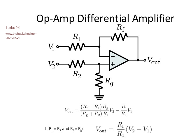

Hi Tom, What Mozzie said.
First you need to understand that the amplifier is a DIFFERENTIAL amplifier. It amplifies the difference between the two inputs. The two 68k resistors are a necessary part of the circuit and define the gain.
Without them, the on board 100 ohm resistors are setting the gain, so it will be very high and you will be over driving the amp so it will be just feeding the speaker with a digital ON/OFF signal which the speakers are effectively 'filtering' because they can only produce a range of frequencies.
The two filtered PWM outputs should be equal and opposite.
With the 68k resistors in circuit and with a pot connected between the IN+ and - inputs consider when the pot is set at zero resistance. The DIFFERENCE between the + and - input is zero so the output is zero or there about depending on the matching of the components.
When the pot is at maximum, the DIFFERENCE between the + and - inputs will be at the maximum and so will the volume or gain.
In one of your circuit's configurations you are actually connecting two Pico outputs together via capacitors. That may produce some high current spikes in the outputs and damage the micro.
I hope that clears it a little

G'day Tom,
You may have just found the solution to the Bintendo Audio Conundrum
This will definitely cause anger and gnashing of teeth with the gods of audio fidelity....

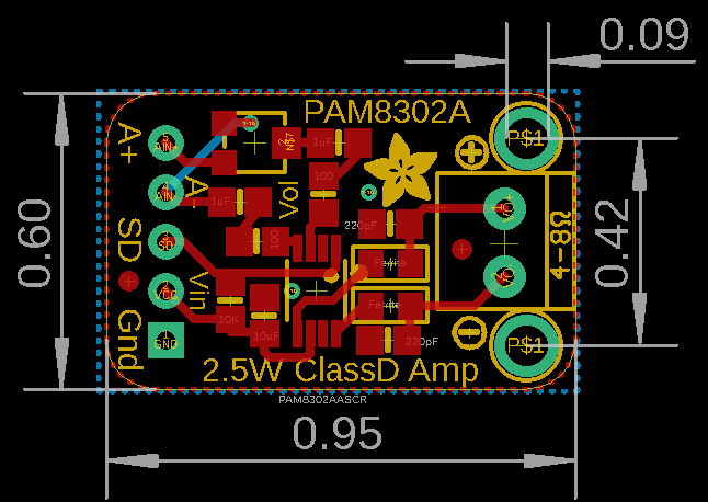

By cutting the track (top right) shown in the photo and disabling the on board volume control, the gain of the PAM8302 can be reduced to a suitable level to allow the PWM signal to stay under control, the "Volume Control" now controls the amplitude of the PWM.
It works, not hifi and a little noise is back but for your application it might be all that's required. Component values will need finessing to adjust gain / volume.
Lyle.
Right so the track you are suggesting cutting is the one connecting AIN- to the internal pot ? You would then set the internal pot to provide 0R between AIN+ and the internal (C1) 1uF. Then you are controlling the volume with an external pot across the PWM inputs like I was trying but failing.
I'll give it a go when I order some more PAM8302s.

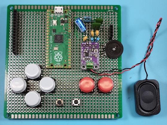

In the meantime I've actually soldered your previous approach, but with a 50K variable resistor across the inputs to the module, to the mk2 prototype.
* Note I know I've forgotten the "voodoo" 2R2 on the power supply, not intentionally.
Seems to work, but the b***dy thing may have been "ticking" again until I ramped up the CPU, the problem now is that I'm "ear blind" to "The Entertainer".
When @bigmik lays out the PCB I'm going to ask for him to allow for a lot of flexibility (a header so it can be taken "off board" and spare plated holes) in the audio section so that if anyone does build one they can have as much *fun* as I am .

I think the blue track:
I'm not certain but I think it's possible @Mozzie's latest proposal also included removing the low pass filter ... perhaps an omission, or perhaps relying on the capacitors and ferrite beads on back-end of the module and the speaker itself to do a good enough job (?)

Perhaps a noisy cricket might be suitable for fitment into the Tomboy, you get noise and haptic feedback in one package (6 legs) and less headaches than a small boy + trumpet...
Tom mentioned he fed the PWM from the Picomite straight into the PAM amp, this just expands on that idea...
Cutting the track (yes the blue one) disables the on board volume control and allows us to set the gain for the PAM8302 using external resistors (R3/R5), if we do this and bring the gain down so that the amp is still high frequency modulating the lower frequency PWM from the Picomite we don't need a filter, the speaker will do it for us.
If we now use the external volume control to adjust the amplitude of the PWM going into the PAM amp, it will adjust its modulation to suit, and we have audio from the speaker with very few external components, possibly the lowest realistic component count, even C3 and C4 are optional due to the 1uF caps on the PAM module.
This works surprisingly well here with my setup, not hifi but it could be ok for the Tomboy application. I still recommend the earlier circuit with filters etc and stereo volume control as a better solution.
