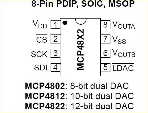

Support for MCP4822 DAC (8 pin version) for audio output
USE:
OPTION AUDIO SPI CSpin, LDACpin, SCKpin, SDIpin
to enable this.
NB: SCKpin and SDIpin must be valid SPI TX and CLK pins as per the manual.
The SPI channel is dedicated to the DAC and can't be shared.
This mode will also use the PWM channel associated with the CLK pin chosen.
e.g OPTION AUDIO SPI GP0, GP1, GP2, GP3 uses SPI and PWM 1
USE standard syntax for PWM AUDIO output

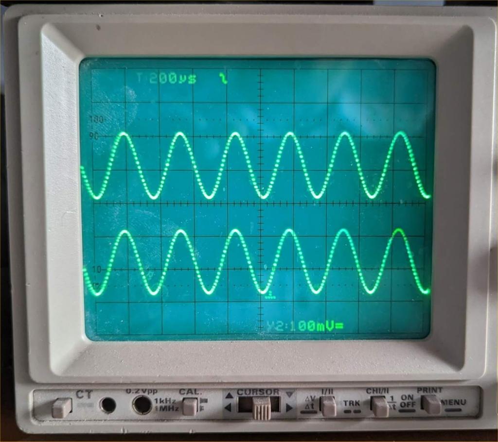

Picture shows PLAY TONE 3000,3000 with a CPU speed of 378MHz. This gives 132300/3000 = 44 samples per sine wav which you can just about pick up the individual levels on the scope. This is taken with the DAC on flying leads - hardly ideal - but still an excellent result

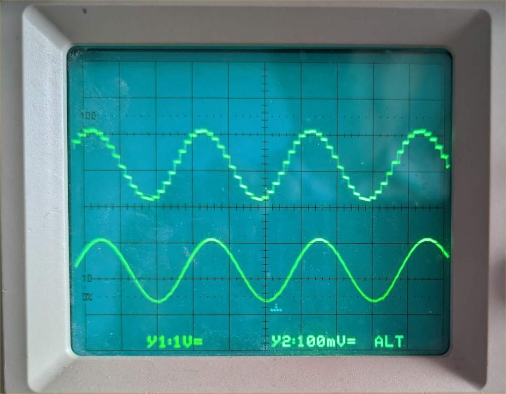

And here is a picture of PLAY TONE 13230,13230
The frequency is chosen to fit the DAC update rate so we get exactly 10 samples per waveforms

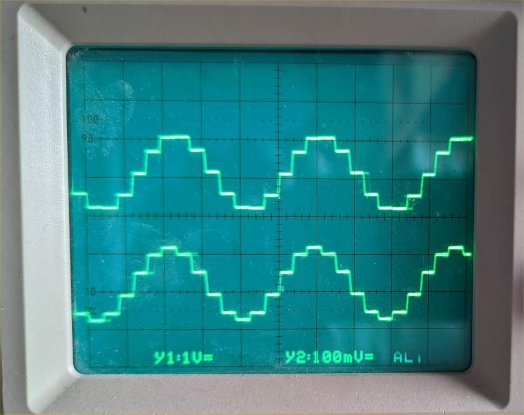

Final Pic
PLAY TONE 13230\2,13230\2
Bottom trace has the DAC connected via a 100ohm resistor into a 100nF capacitor - all that is needed for a perfect trace
