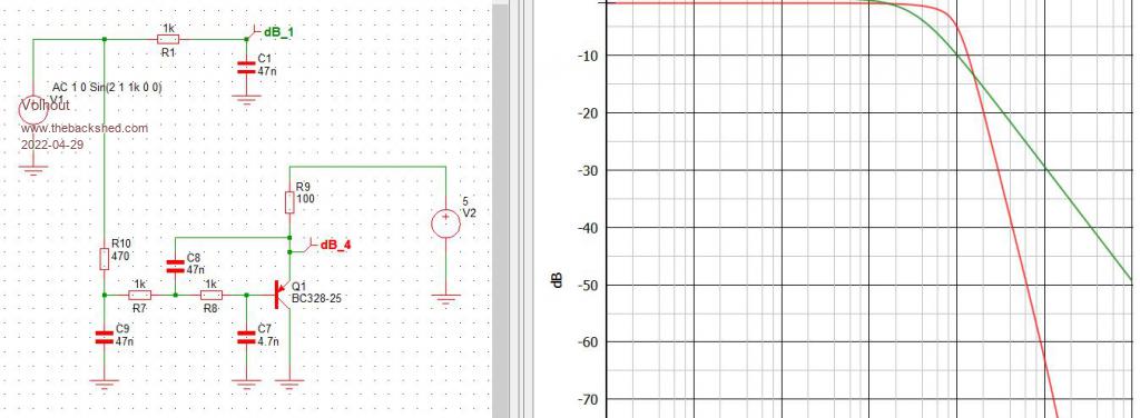

Hi Mick,
Yeah, there is a lot to experiment. And the switchmode PSU is far from ideal.
Reason I am investigating this (previous suggestions like the emitter follower where designed around the DAC in the Armmite F4 and CMM2). This (with 44.1kHz base frequency in the PWM) is a total different beast.
If you do nothing about the 44.1kHz, your amplifier (tweeters) will be driven peak-peak with 44.1kHz. And it is depending on the filters inside the audio amplifier how much of it is attenuated. Also headphones... and your cat will stay away from you when you use these on picomite. Cats heat the 44kHz (I don't). And to them the 44.1kHz is louder than anything in we hear.
The 1k/47nf filter will attenuate the 44kHz with roughly 20dB (10 times attenuation), but the audio spectrum starts to roll off at 1kHz. 10kHz is -10dB (blue line)
This may be useable. But with some more passive components you can achieve better (green, red line).
Just playing.
My goal would be to get the 44.1kHz at 1%, and a spectrum up to 8 or 10kHz -3dB.
That would give a very good audio quality if you would feed it music from the SD card. And it would be in some way compatible with the 11 bits that we have in customer satisfaction. It won't get to CD quality anyway, but I like to get it close.
Similar I will look at the VGA sync signals. These at directly driven into the VGA cable. Technically that is possible (proven) but some impedance matchin (serial resistor) may lower the ringing that is bleeding into the audio circuits.

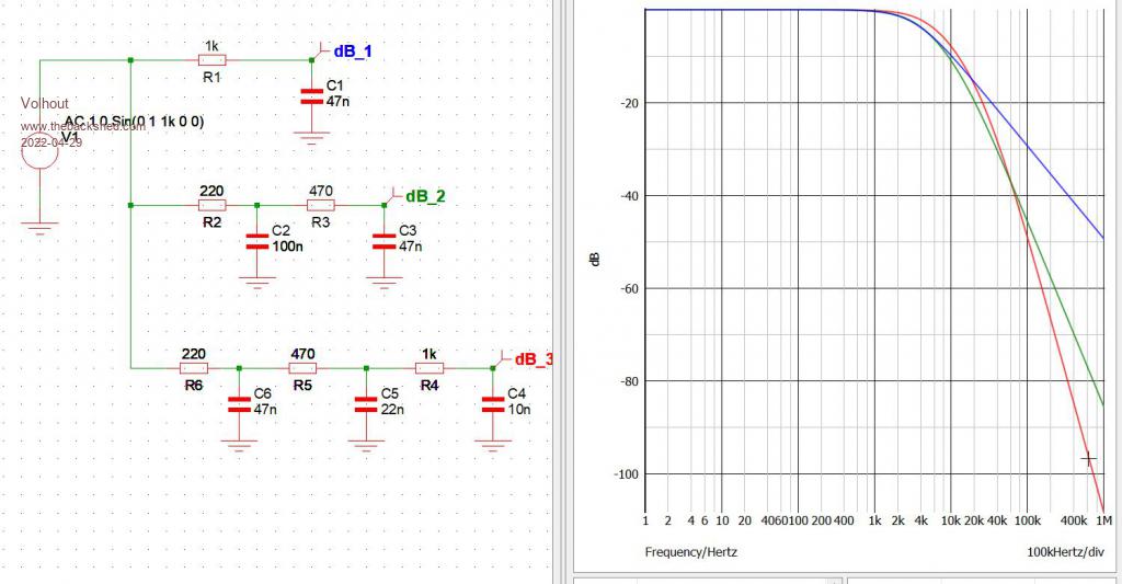

I guess this will be my basic circuit when I start working on the other issues (the red line). Can drive a headset.

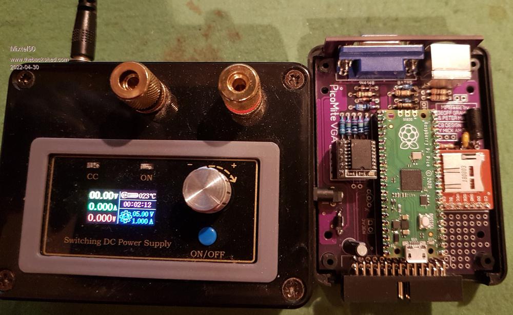

I have very little bench space most of the time, so I came up with a creative idea. I use one of these modules in a plastic box, with a barrel jack on the back and terminals on the top. I can then plug in a laptop power supply (which can stay on the floor) and get a variable voltage, variable current output with a power switch. I need my glasses on to set it (the text is small) and it's a bit clunky to use, but it's cheap and it works well.

  Mixtel90 said  I have very little bench space most of the time, so I came up with a creative idea ...
Neat. I have a cheap Duratool single-output linear bench supply (D03233). The LCD diplay on the one buck-boost supply I have failed almost immediately, but otherwise it seemed to work the last time I tried it.

  Mixtel90 said  I use one of these modules
+1 for that gadget. A handy little variable supply with the emphasis on "little".

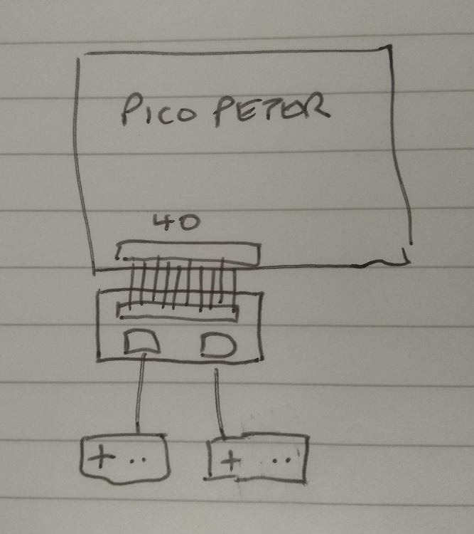

WARNING "idiot (me) talking":
I don't see that the software used to design the PCB matters, all you need is to mate the 2x20 headers and they are "standard" aren't they.
The PicoPETER has a standard spaced 2x20 header at the "front" that breaks out all the pins of the Pico. It looks like it's intended to take a right-angle male header.
What you want is a small board with a corresponding right-angle female header (probably overhanging from the PCB as far as is mechanically possible so it can be attached without needing a cable) and a couple of male DB9s (plus any other gilding you might decide to squeeze in).
Obviously you'd need one of Peter's boards for trial purposes and if the design can't be pin compatible (there may be some leeway to handle minor incompatibility in software) then the idea is a bit of a wash.
Not to scale

Bill is asking for a "piggy back" pcb that sits inside the case, over the top of Peter's pcb, and stacks on top of the 40-pin sockets in that board (it has 3, one for the Pico and two for expansion boards). The port connectors would be flush with a panel so that joysticks could be plugged in from outside the case. I think that's the idea. For it to work I need to know exactly where those 40-pin connectors are on Peter's board relative to the board edges.
Plugging into the 2x20 header is a completely different thing. It might work, but it would probably be rather flimsy. As much a kludge as Sinclair's Interface 2, in fact. lol
