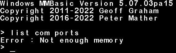

  Goksteroo said  I get this....
On my Dell Inspiron laptop running W11, I get the same.
Under Device Manager, there are no COM ports listed and this is because in this laptop, there are no COM ports, only USB. If I connect up a Picomite, or in fact, any USB to serial device/adaptor, the associated COM port is correctly identified.
Doug.

I love all these COM ports. It appears I have 7571644 of them and Not enough memory. :)
System is Windows 10 Pro 64
