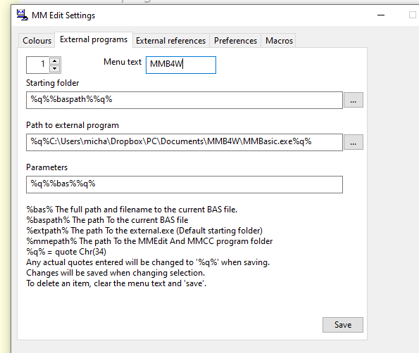

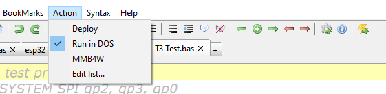

  Andrew_G said  Hi Jim,
While you are there. How does MMEdit work best with MMB4W?
File -> Preferences
Your External program #0 is probably MMDOS
Increment to #1 and then browse to the location of your MMB4W
Save
Then, under Action, You should find MMB4W. When selected as the default, the launch icon should launch directly into MMB4W.

There is one obvious difference between the direct link to MMB4W and Gerry's MMReplace method. Gerry sends commands to the open MMB4W window so there will be only one copy open.
My direct link will always start a new instance of MMB4W so you can end up with a large stack of instances if you don't QUIT them.
The MMEdit help has the instructions for linking. Basically the same as provided by Craig.
If you click on the button "Set as default" (not shown on Craig's image), You can use the "Run in DOS" button to launch MMB4W . The tooltip text will have changed to indicate the default program it launches.

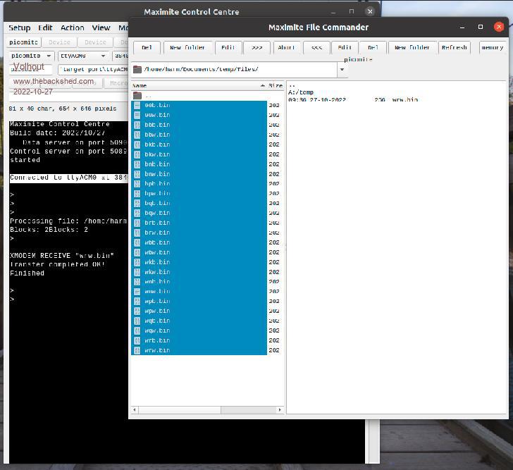

Copy multiple files:
- click on first item in list
- use shif and click on last item in list (all items are selected)
- then select >>> button.
Only the last file selected is copied.
p.s. this screenshot is taken after the copy has taken place, in the terminal screen you can see only 1 file is copied. I re-selected the list, then took the screenshot

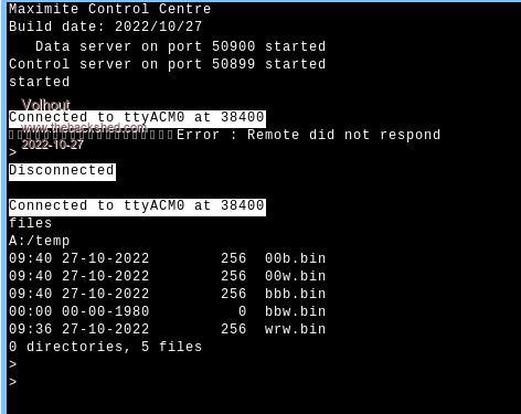

The problems with copying multiple files individually
- select a single file
- press >>>
- in terminal screen wait for completion, then repeat for next file.
After some files are copied, MMCC closes (crashes ?)
After restart of MMCC, and press <connect> at first pico does not respond
<disconnect> and <connect>
pico connects. If you look at files, picomite made a file entry, but file size is 0.
I hope this helps.

Posted: 07:33pm 27 Oct 2022
I am not surprised with the problem with not being able to select multiple files.
There will be a difference between the desktops we are using. My experience with Linux is not sufficient to think of a solution but I will keep looking.
The problem with file transferring is more serious.  XMODEM is very robust.
The maximum packet size when using XMODEM is 132 bytes so there is no way we are overflowing buffers.
I doubt if there is anything in the files you are sending that causes problems but if you could send me a few to test with it might discount that as a reason.
MMCC shouldn't crash whatever the reason for the failed transfer. I can get the occasional failure and MMCC just logs the failure and goes onto the next file without skipping a beat.
Can you transfer big files to the picomite?
Can you transfer from the picomite to the PC?
I don't know if there is anyone else using the Linux version of MMEdit but I am not ready to give up yet.

When trying to copy multiple files ( 3 files selected) only the last file is copied. The copy appears to be correct.
Can copy file from PicoMite to PC with File Commander OK. Progress is received block count in 10s.
Trying to copy multiple files (3) from PicoMite to PC, only the last file of the 3 selected is copied (correctly) and the MMCC screen shows
Completed OK
Finished
... and is hanging there until a Ctrl C is sent from the MMCC at which point, we go back to the prompt.

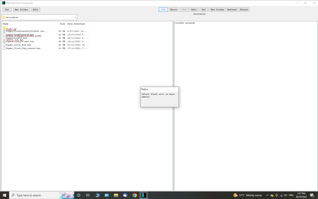

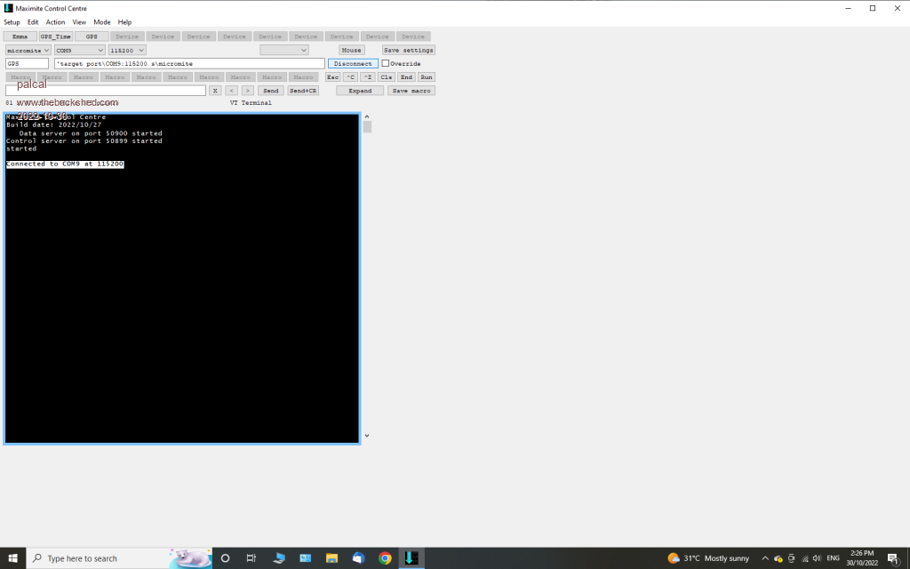

I have just started playin with V5. I connected a Picomite and all seemed OK. I then connected a Micromite,
The terminal worked OK but when I switch to File Manager clicking on SDcard to switch to memory does nothing and when I click to transfer a file it behaves as though I have a Picomite connected.
What am I doing wrong. I printed out the Help File and have read it.
Posted: 05:44am 30 Oct 2022
Try micromite+
The standard micromite doesn't have SD card support.
