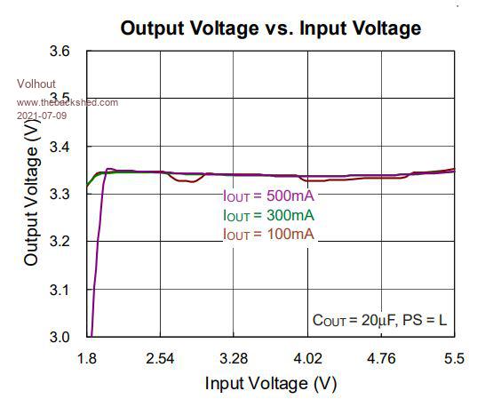

The RT6150 used on the pi pico is a buck-boost converter. And over the input voltage range it changes modes. At low power (100mA) that causes output voltage changes: see below. Especially interesting is the changeover around 5V input voltage. That is exactly where it is used on the pico.
I think I will look for a linear -or- add a 3V reference.
