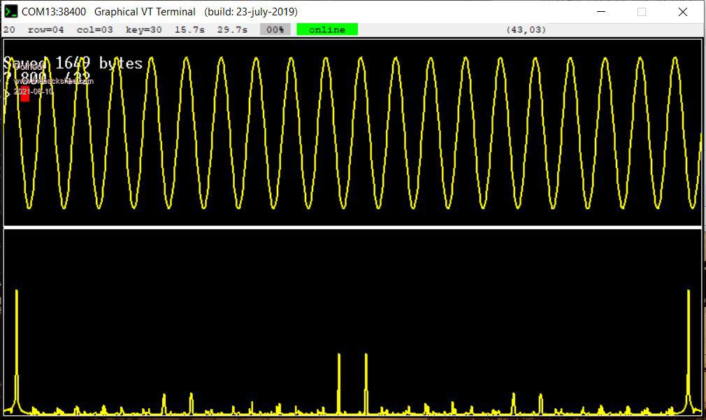

Posts: 6209
Posted: 08:18am 10 Jun 2021
I am a few versions behind (a23) but as promised, a test of the fft function.
I expect this to be the correct result, at least I see the fundamental frequency and harmonics. The fact that the fft output is symetrical, when most applications only show half of the fft as a spectrum.
I am not sure if the centre peaks in the fft graph are result of the start and stop of the sine wave in the input signal.
Anyway, MATH FFT MAGNITUDE works.
This is the code I used for testing.
'GFXterm - magnitude FFT
'init gfxterm parameters
Const GFX=Chr$(16)
Const ENQ=Chr$(5)
Const ACK=Chr$(6)
Print GFX "?"
Input Gw, Gh
Print GFX "clear" 0, 0, Gw, Gh
GoSub drw
'defines
n=1023   'samples for fft (multiple of 2 - 1)
cy = 20  'cycles of sinewave in n samples
Dim a!(n),fm!(n)
GoSub sinfill
GoSub sinshow
Math fft magnitude a!(),fm!()
GoSub fftshow
End
'show fft on graphics terminal
fftshow:
 Print GFX "ink" 255, 255, 0, 2
 'scan magnitude array
 mi!=0:ma!=0
 For i=0 To n
   mi!=Min(mi!,fm!(i))
   ma!=Max(ma!,fm!(i))
 Next i
'  Print mi!, Ma!
 ygain=-Gh/(3*(ma!-mi!))
 yoffset=Gh-1
 xgain=Gw/(n+1)
 xoffset=0
 For i=0 To n-1
   x1=i*xgain+xoffset
   x2=(i+1)*xgain+xoffset
   y1=fm!(i)*ygain+yoffset
   y2=fm!(i+1)*ygain+yoffset
   Print GFX "line" x1,y1,x2,y2
 Next i
Return
'fill input array a()
sinfill:
For i=0 To n
 a!(i)=Sin(i*2*Pi*cy/n)
'  Print a!(i),
Next i
Return
'show the graph of the input signal
sinshow:
 ygain=-Gh/5
 yoffset=Gh/4
 xgain=Gw/(n+1)
 xoffset=0
 For i=0 To n-1
   x1=i*xgain+xoffset
   y1=a!(i)*ygain+yoffset
   y2=a!(i+1)*ygain+yoffset
 Next i
Return
'draw frames
drw:
 Print GFX "ink" 255, 255, 255, 2
 Print GFX "line" 0,Gh,0,Gh/2+1
 Print GFX "line" 0,Gh,Gw,Gh
 Print GFX "line" 0,Gh/2+1,Gw,Gh/2+1
 Print GFX "line" Gw,Gh,Gw,Gh/2+1
 Print GFX "line" 0,0,0,Gh/2-1
 Print GFX "line" 0,0,Gw,0
 Print GFX "line" 0,Gh/2-1,Gw,Gh/2-1
 Print GFX "line" Gw,0,Gw,Gh/2-1
Return

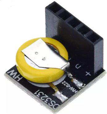

Posted: 01:52am 11 Jun 2021
DS3231 RTC module now working on picomite.
This code sets the date and time. It is necessary to fill in the array hx() with the necessary values in hexadecimal Binary Coded Decimal (BCD) in the order shown in the comment on the first line.
 ' address,seconds,minutes,hours,dayofweek,day,month,year,control -- enter numbers in BCD as hex
 Dim integer hx(8)=(&h0,&h0,&h36,&h21,&h4,&h10,&h06,&h21,&h10) ' hx(0) is address to write to
 SetPin 14,i2c1sda
 SetPin 15,i2c1scl
 I2C1 open 100, 1000
 I2C1 WRITE &h68,0,9,hx()
 I2C1 close
 End
The following code gets the RTC values and sets date$ and time$:
dim integer d(9)
SetPin 14,i2c1sda:  SetPin 15,i2c1scl: I2C1 open 100, 1000
i2c1 WRITE &b1101000,1,1,0 ' set the read address to 0
i2c1 read &h68,0,7,d()
dt$=str$(bcd_bin(d(4)))+"-"+str$(bcd_bin(d(5)))+"-20"+str$(bcd_bin(d(6)))
tm$=str$(bcd_bin(d(2)))+":"+str$(bcd_bin(d(1)))+":"+str$(bcd_bin(d(0)))
date$=dt$:time$=tm$
?date$,time$
end
Function bcd_bin (Val as integer) as integer ' from FruitOfTheShed
 local integer tmp
 ' convert the BCD values to binary
 tmp = val AND &b00001111
 bcd_bin = (val AND &b11110000) * 10 / 16 + tmp
END Function
Because RTCs have been built into many micro/maximites for a long time, I had to do some digging and experimenting to get it right. I found code from 2011 for the DS1307 using line numbers and different I2C commands, and a matherp offering with a CSUB. The bcd_bin function is derived from a DS1307 sub in FruitOfTheShed.
