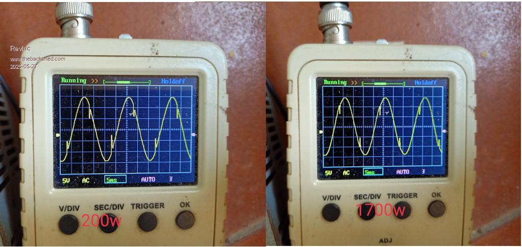

Ok, so you made me dig a little deeper....and my curiosity joined the party , after looking at the difference between the signwaves with either a diode (heatgun) on the low power settings and the speed controller running at different power levels while watching the DSO,   I suspected the speed controller is a bit more than just an ordinary SCR and a few bits, after some stuffing around I could just make out half of the part number and it turns out to be a Triac bta100-800b so it now makes more sense the way the is shows on the DSO and is easy for the inverter to run and not as hash as a diode or single SCR.
The first photo is the speed controller running a restive load at 200w  the second photo is at 1700w the divot moved from one side over the peak of the wave to the other side, the inverter runs this just fine, no change in sound from the toroid and no other loads running, turn the controller all the way up and the divot is gone.
Keep in mind that some appliances have filter caps, and others have very little, with so many variables (different DSO) its a bit much to expect it to look identical to the signewave on other builds  although it can look quite close.

The variable speed heatgun is pulling power from both halves of each AC cycle so the Toroid does not complain much, if at all, but those garbage heatguns that use a Diode in series for low speed, pull power from only half of each AC cycle, causing higher harmonic distortion and unbalance the AC waveform which causes the Toroid to growl.

Thanks @Revlac for doing the test.  It's interesting that low and high speed controller loads caused divots with similar magnitudes.  I had expected the magnitude to be proportional to overall load.  But now it looks like the rate of load current change and voltage magnitude at the sine wave position likely play a bigger role.

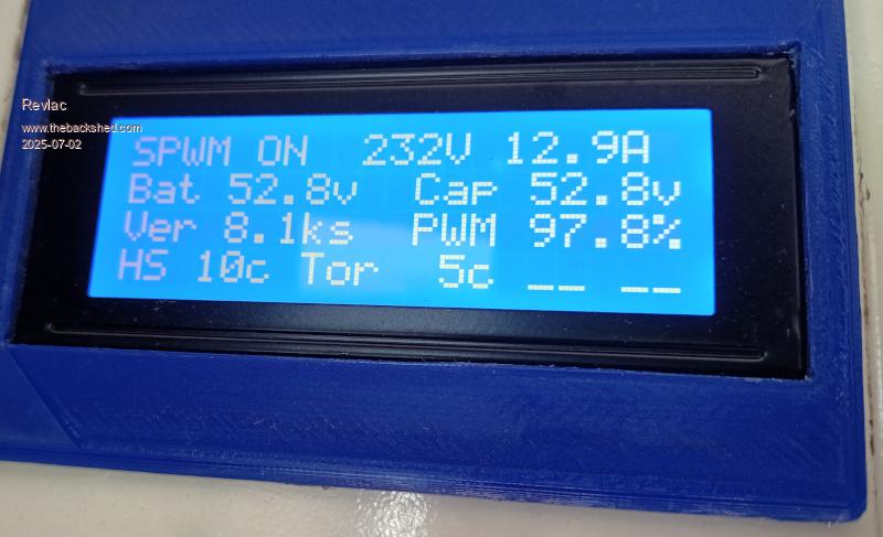

I did have the HWS on and a heater inside and did mange to see and take a photo of the Inverter screen....I really need to cut the hole in the door and put in a window to see everything.
The pwm was 97.8% so yes will have to do a few checks, need a few work free days to get the other toriod finished and then tweak up the current trip, and try again.

The high PWM for that load level Looks like toroid turns ratio or not enough turns on the secondary or incorrect number of turns for the primary.
Admittedly my efficiency is little lower because of the low idle PWM value that I have (around 71%), but with a 6kw load mine is still in the low 80%. I did this because I need to start induction loads drawing well over 23kW for a few seconds on startup.
