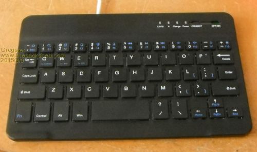

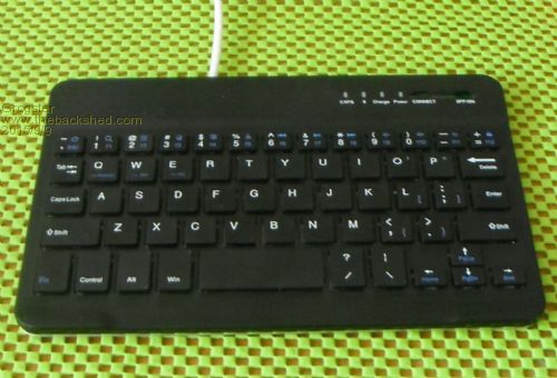

UPDATE:
All done, except for the plug on the end of the cable.

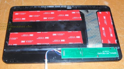

It is hard to see, but there is a slice of OHP film taped down over the top of the PCB, to prevent it shorting out on the aluminium base-plate. 3M VHB tape is remarkable stuff, and by God, it sticks. I have used it for many a mounting, and it has never let me down, and this looks much neater then drilling new holes right through the case.

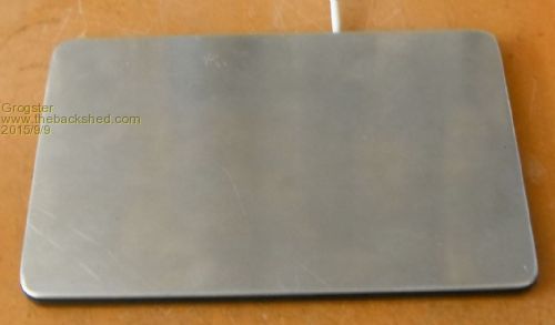

The plate is 3mm aluminium, cut by a local firm, using the flappy original "Plate" as a template.
I used CRC 2016 Contact Cleaner to clean down the surface of the new aluminium plate first, then lower gently into place, and press down.

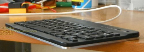

Last image shows the finished prototype sitting on one of those foam-rubber mat-anchor-securing-sheet-stuff. I don't know it's proper name, but people put it under normal keyboards to stop them moving, and it is also common in cars for people to plop their cellphone on to stop it sliding off the dash. I had green, but you can get it in black among other colours.
With it sitting on this stuff, it is solid as a rock.
Posted: 07:47pm 08 Sep 2015
you didn't use the original screws to hold the back on?
it looks extremely professional. now you just need to sell the design back to the original chinese manufacturer!
rob :-)
Posted: 08:19pm 08 Sep 2015
Hi G,
Looking good there.
Can I suggest you try four low profile self-adhesive rubber feet. These will make the unit look very professional as well as adding the all important anti-slip. Available in round or square, and in black, white, grey and clear. Also various sizes. I think round, black, 8mm (diameter) x 2mm (high) will look best on your unit (I have spent many hours trying different feet for my units here - using the correct one gives a pleasing result!)
By the way, I would not go for domed shape as these are too high for your requirements IMHO.
Ebay a good source for lots of cheap feet . . .
Nice work once again Grogs
WW

Thanks, chums.
@ Rob - original back-plate was just a flappy bit of useless tin-foil type stuff - no strength at all, and the securing screws were all of 1mm in thread length, so they were totally out. I suppose I could have found replacement screws of the right length, but at the end of the day - 1mm thread depth into plastic, is not gonna hold, and the weight of the aluminium plate would probably overcome the screws and drop off the bottom!
@ WW - Yes, I have some of those stick on rubber feet. The ones I have are black, about 8mm, and square. The actual contact foot surface is flat.Edited by Grogster 2015-09-10

I have not experienced that issue - yet - but as it is certainly a proven bug, I will upgrade. This will be a good test to see how easy(or hard!) it is to get the unit apart again.....

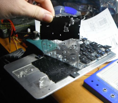

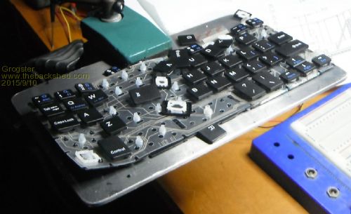

Posted: 10:35pm 09 Sep 2015
Well, I killed it.
By God, that 3M mounting tape REALLY sticks. It sticks so well, that the only way to get the keyboard apart, is to effectively destroy it.
I have another four or five, so does not bother me, but I will have to rethink the mounting tape idea - much less of it then what I am currently using, would probably be the first step!
