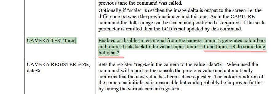

Posted: 02:41pm 22 Feb 2025
I believe something is unfinished here
My MMBasic 'sand box'
Posts: 3369
Posted: 02:59pm 22 Feb 2025
Good one!
I think that is Peter taking a mad stab in the dark.
