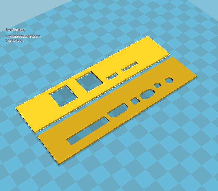

Oh, and something else would interest me. I have a colleague who has a 3D printer. He could print the housings for me. Does anyone have the necessary printer files?
Or is this a standard housing that I can also order from JLCPCB?

  ManiB said  .. I have a colleague who has a 3D printer. He could print the housings for me. Does anyone have the necessary printer files?
Hi Manfred,
I wrote this yesterday:
  Quote  And I converted Peter's DXF to STL using Fusion a long time ago. I don't know if that helps. This worked well for my devices.
PicoMiteHDMIUSB.zip
STL=3D-Printer Files
Michael

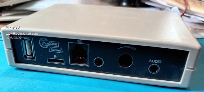

Posts: 9238
Posted: 11:39am 22 Mar 2025
This one is done using the PCB method:
Hi Manfred,
I wrotethis yesterday:
PicoMiteHDMIUSB.zip
Michael
Hi Michael, thanks for your STL files for front and backpanel. I've checked the two files (Körper1.stl and Körper2.stl) and I think Körper2.stl is corrupt.
But I will use the PCB files from Daniel anyway.

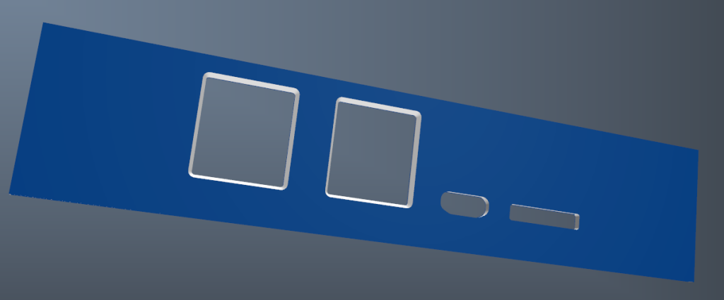

Imported Pete's DXF to Front Panel Designer:

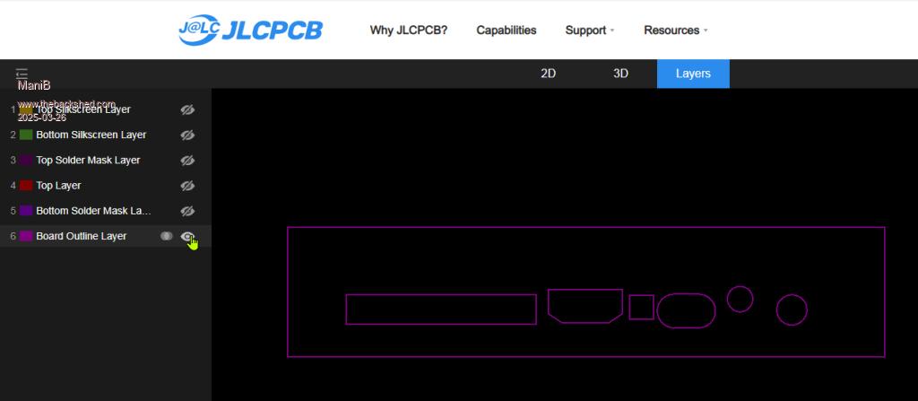

  PhenixRising said  Imported Pete's DXF to Front Panel Designer:
Hey PhenixRising, I'd be interested to know which tool you used. I couldn't find anything at https://jlcpcb.com.
@Daniel: I uploaded your Gerber files to https://jlcpcb.com and with the Gerber viewer in 3D mode I couldn't really see that there were cut-outs. Is that ok?
Is the board outline layer responsible for the cut-outs? If so, then it could be OK and ‘only’ a display problem in the Gerber viewer - but I have no experience.
Edited 2025-03-26 05:43 by ManiB

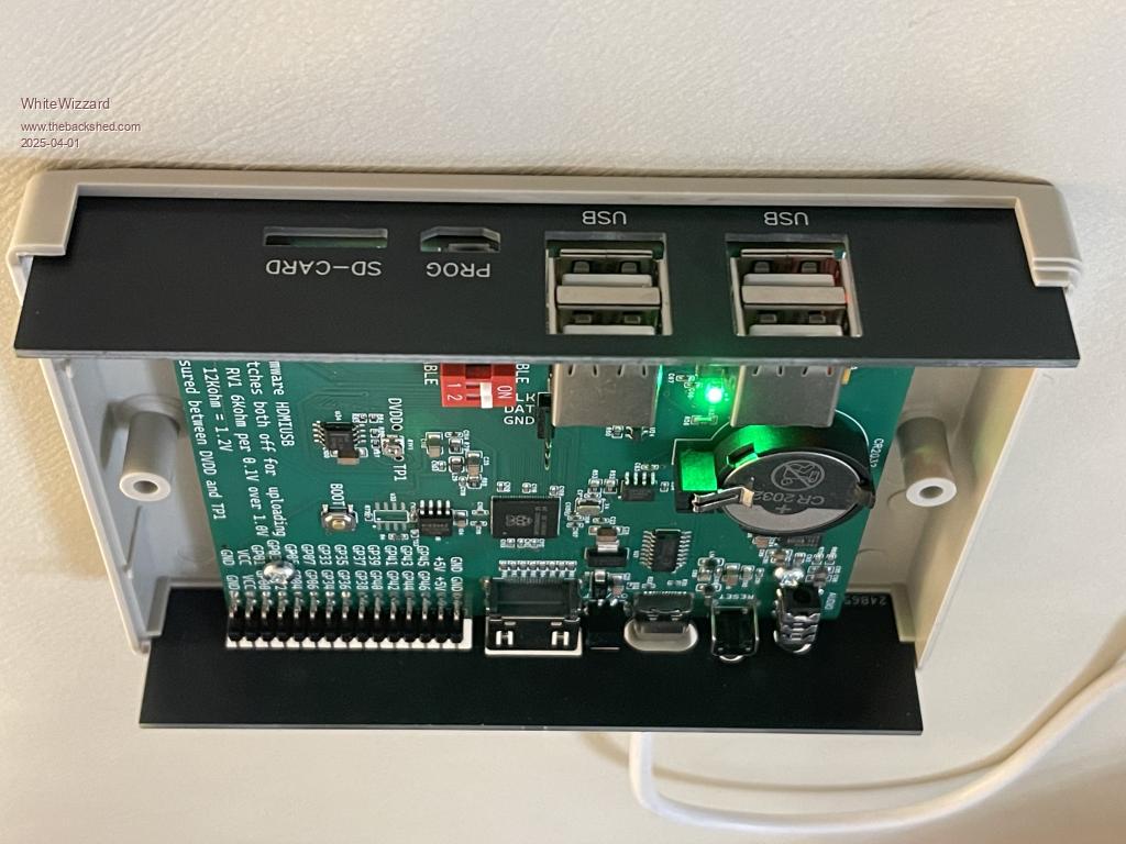

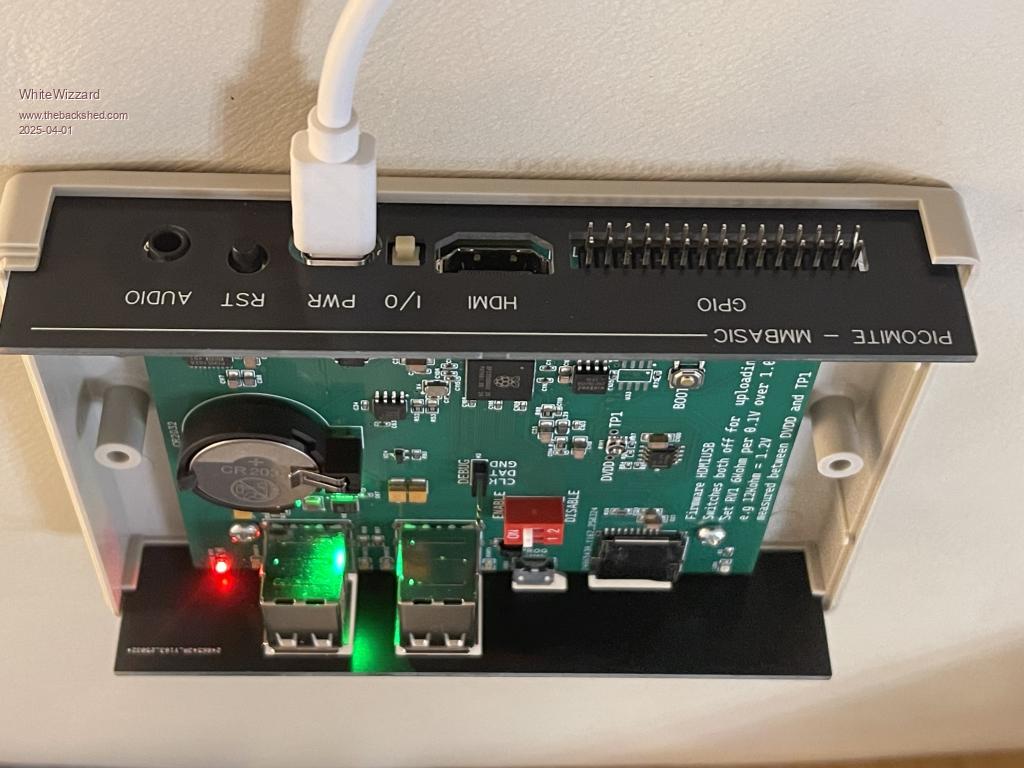

Posted: 08:06pm 31 Mar 2025
  ManiB said  Is the board outline layer responsible for the cut-outs?
I can confirm all is good with the Gerber file, and you will get the panels cut out with all the holes!
Mine arrived earlier today and everything fits nicely into the recommended enclosure as can be seen below.
Anyone in UK wanting Peter’s latest HDMI/USB ‘Reference Design’ (with I2S audio) then I am selling completed units (cased, with panels, PSRAM installed) for £45; this includes UK Special-Delivery shipping. Simply drop me a PM to reserve one (first come, first served; but I do have quite a few!!).
(Photo shows without PSRAM - I am just about to solder some units).
Not sure why photo’s upside down - obviously these are the Australian model!
Sorry, I missed this.
It's a pricey way to go (anodized aluminium)
panels.zip
I have zipped both the dxf and fpd files. Pete had both panels on one dxf and so I had to split them.
