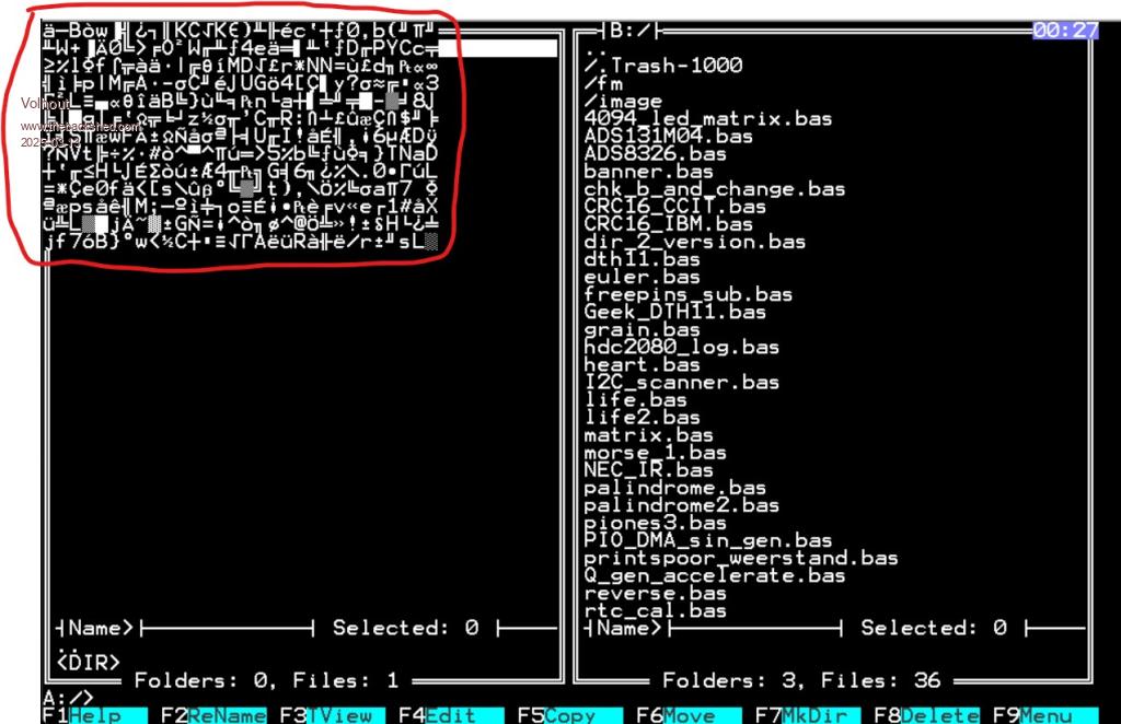

EDIT: the tests with sound and showing pictures all ended in ERROR messages when there is no audio (PWM/I2S/SPI) defined, and no (VGA/LCD/HDMI) screen defined. That could be handled more gracefully.
EDIT2: the screen saver (in my case) did not cover all 80x40, but only a roughly 32x16 area at top left size, also characters where white, not green. I will confirm if this is related to the fast screen update (Pause 10) and play with the value.
EDIT3: Putty/Linux tests went well...

The screensaver size is not related to update rate.
Even when slowed down, it still only manages 32x16 area.
This is caused by incorrect MM.HRES and MM.VRES, since there is no display.
But we have set terminal windows as 80x40 with OPTION DISPLAY 40,81
This has a working screen saver...
But since it has no fading, it is not as nice...

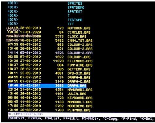

Maybe we take your 02017 version as a starting point, and start removing things that will not work anyway on console (sound/picture view). And maybe (in line with the single pane file manager in CMM2) change the "xxx.bas" files color, so they stand out.
CMM2 filemanager
Teraterm is perfect since it has the Terminal (MS-DOS) font. Putty however should also work. The default Ubuntu build Putty does not have the Terminal font, but works acceptable. Only the frame (graphics characters) are not supported. The frame consists of blocks. Maybe the Terminal font can be added to Linux. But it may be copyrighted Microsoft (not open source).

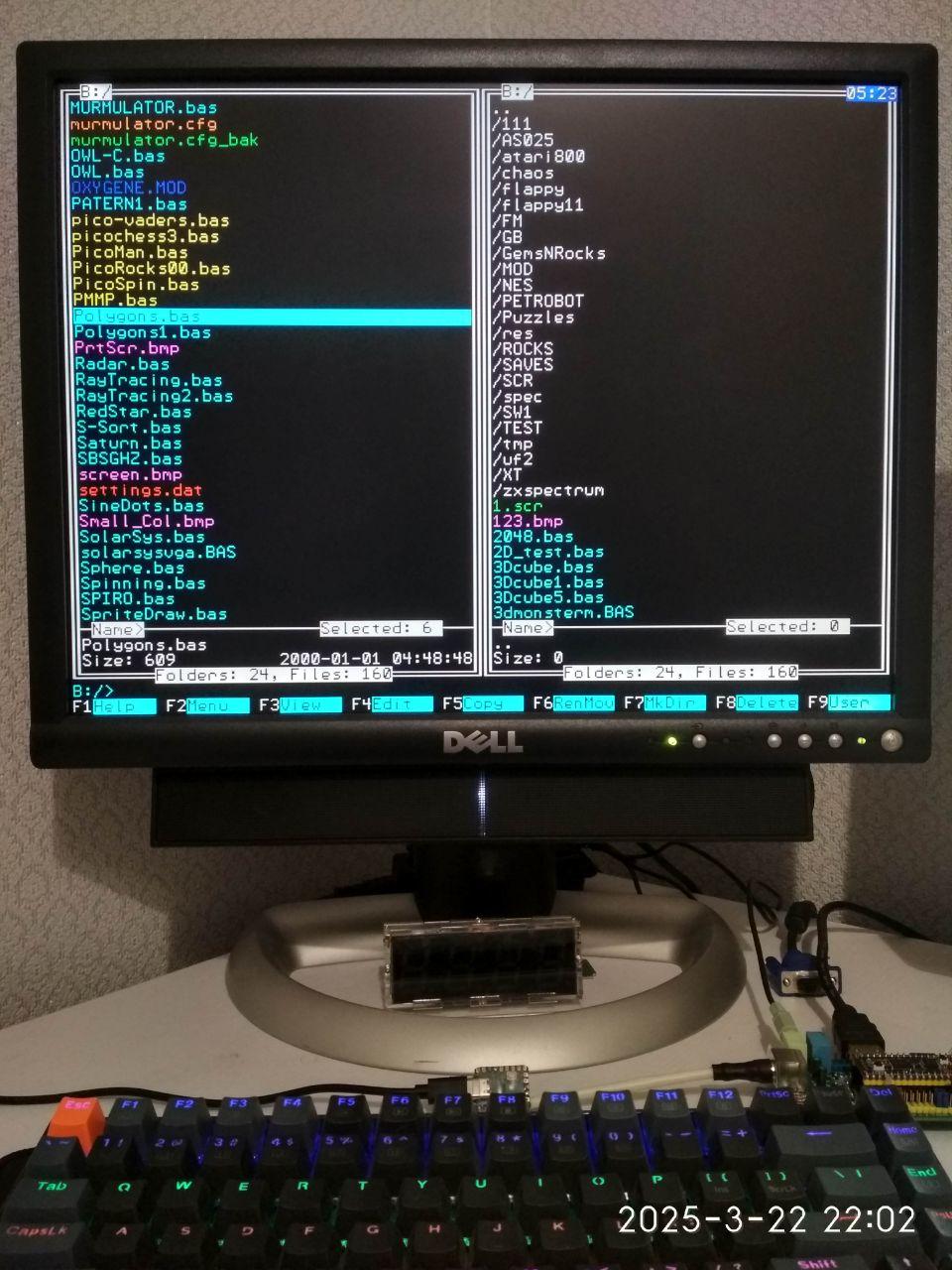

Today I did a little programming, made file coloring and multi-select, for now it only marks files.))
FM140.zip
Need advice on coloring files, assigning buttons, etc.
Of course, I can't keep up with you, I'll dig into this further as much as possible... I'll be looking at your code.
