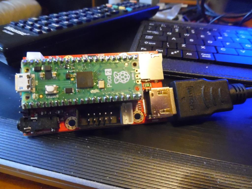

Posted: 07:55pm 10 Sep 2024
olimex arrived and tried picomitehdmiusb and picomitehdmi
but no video, check hdmi tv works?
teraterm works with pico2 so there's hdmi to set up.
please help.which usb to use?
Edited 2024-09-11 05:57 by stanleyella

Posted: 08:29pm 10 Sep 2024
  matherp said  Did you type "OPTION RESET OLIMEX"
no. The thread has many pages, my bad. got this to mess with
option reset olimex

Posted: 09:17pm 10 Sep 2024
I typed mode 3 and circle 240,240,100 and got a circle,,, bit oblate spheroid but olimex is working first test

no hdmi freq for this luxor tv but hdmi to olimex pico2 and modes seem ok and this is still in development!

Posted: 12:06am 11 Sep 2024
tried mode 1 to 5 with existing 2040 asteroids and bubble universe on olimex pico2 and from jittery to big to not enough memory for mod play.
thing is it works through the hdmi and the sd card reader works.
it's an old luxor tv and it has synced an stuff fine cos  I got no remote.
sound test next. link needed.
maybe usb version but sort this first.
hdmi don't seem faster than vga 2040. pico2 vga was faster than 2040 vga

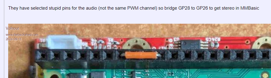

Posts: 9246
Posted: 08:00am 11 Sep 2024
Stan:
HDMI can be stripboard friendly. There are breakout boards. The Adafruit one even has the resistors on it.
I think you'll be able to get the USB HDMI version running on there. GP8/GP9 will probably still work with a USB-TTL converter for the console even though there are pull up resistors on them.
You don't *need* the long female connectors. There are a lot of pins you can't use even if you have them and some (if not all) of the most useful spare ones are already on that little box header and the little 3-pin header.
The 3-pin has GP0 & GP1
CON2 has GP2 & GP3
The 10-gin has GP4, GP5, GP6, GP7, GP8, GP9, GP20, GP21
The HDMI socket has
GP10, GP11, GP12, GP13, GP15, GP15, GP16, GP17, GP18, GP19, GP26
Audio has GP27, GP28
The SD card has GP22, GP4, GP6, GP7 (it shares the SPI with the 10-pin)
There's nothing left to connect anything to. The female connectors are useful for monitoring but most can only be used if you aren't using DVI/ HDMI.

Posts: 6198
Posted: 08:29am 11 Sep 2024
Don't forget .....
