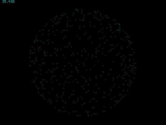

Rotating 2D sphere
with and without cache tracing
'Option TraceCache On 32
Const NumPoints = 500
Const Radius = 190
Const Dist = 500
Const X0 = MM.HRES\2
Const Y0 = MM.VRES\2
Dim x(NumPoints), y(NumPoints), z(NumPoints)
Dim angleX, angleY
For i=1 To NumPoints
phi=2*Pi*Rnd
theta=ACos(2*Rnd-1)
x(i)=Radius*Sin(theta)*Cos(phi)
y(i)=Radius*Sin(theta)*Sin(phi)
z(i)=Radius*Cos(theta)
Next
Colour RGB(Cyan)
Inc angleX,.02
Inc angleY,.03
CLS : Print Timer: Timer =0
 ny=y(i)*Cos(angleX)-z(i)*Sin(angleX)
 nz=y(i)*Sin(angleX)+z(i)*Cos(angleX)
 nx=x(i)*Sin(angleY)+nz*Cos(angleY)
 finalZ=-x(i)*Sin(angleY)+nz*Cos(angleY)
 proj=dist/(dist-finalZ)
 Pixel X0+nx*proj,Y0+ny*proj
Next
Loop While Inkey$=""

Rotating 2D sphere with Option TraceCache
CLS
Dim N=600, R=200
Dim X(N), Y(N), Z(N)
For i=1 To N
TH=Pi*Rnd
PH=2*Pi*Rnd
X(i)=R*Sin(TH)*Cos(PH)
Y(i)=R*Sin(TH)*Sin(PH)
Z(i)=R*Cos(TH)
Next
AY=0.05: CY=Cos(AY): SY=Sin(AY)
AX=0.03: CX=Cos(AX): SX=Sin(AX)
OX=MM.HRES\2: OY=MM.VRES\2
Timer =0
For i=1 To N
 If Z(i)>0 Then Pixel OX+X(i),OY+Y(i),0
 XT=X(i)*CY-Z(i)*SY:ZT=X(i)*SY+Z(i)*CY
 X(i)=XT:Z(i)=ZT
 YT=Y(i)*CX-Z(i)*SX:ZT=Y(i)*SX+Z(i)*CX
 Y(i)=YT: Z(i)=ZT
Next
Print @(0,0)Timer;

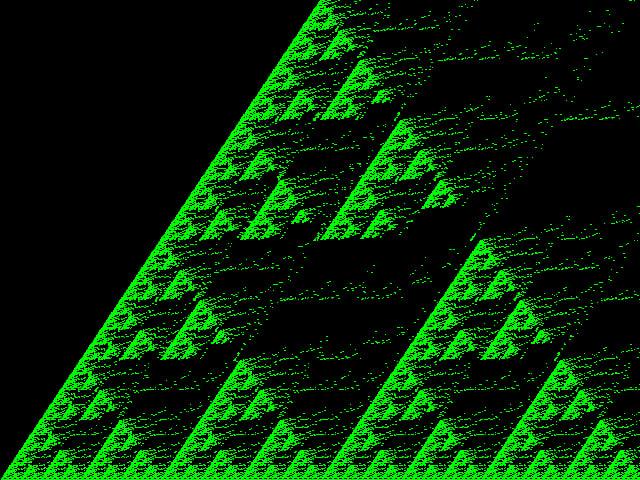

"The Fragility of Being" by Sierpinsky
Const N=1023
Const SclX=N/MM.HRES
Const SclY=N/MM.VRES
Dim integer X,Y
Colour RGB(Green):CLS
For X=0 To N
 For Y=0 To N
   If X And Y Then Y=Y+(X And Y)\2
   Pixel (X+Y\2)/SclX,MM.VRES-Y/SclY
 Next
Next
Edited 2026-05-09 21:08 by javavi

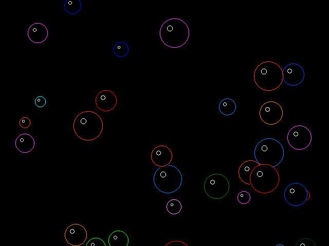

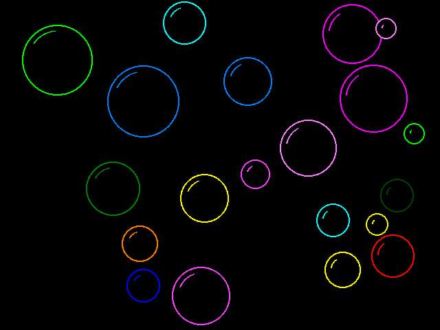

Soap bubbles
MODE 3
Dim c(15)=(0,1,2,3,4,5,6,7,8,9,10,11,12,13,14,15)
Colour Map c(),c()
Type Bubble
 x As INTEGER
 y As INTEGER
 dx As INTEGER
 dy As INTEGER
 r As INTEGER
 c As INTEGER
 act As INTEGER
 pop As INTEGER
End Type
Const maxBubbles = 20
Dim b(maxBubbles) As Bubble
For i=1 To maxBubbles
InitBubble(i)
Next
   Circle b(i).x, b(i).y, b(i).r,,,0,0
   If b(i).act=1 Then
     b(i).x=b(i).x+b(i).dx
     b(i).y=b(i).y+b(i).dy
     If b(i).x-b(i).r<0 Or b(i).x+b(i).r>MM.HRES Then
       b(i).dx=-b(i).dx
     If b(i).y-b(i).r<0 Or b(i).y+b(i).r>MM.VRES Then
       b(i).dy=-b(i).dy
     For j=i+1 To maxBubbles
       If b(j).act=1 Then
         dist!=Sqr((b(i).x-b(j).x)^2+(b(i).y-b(j).y)^2)
         minDist!=b(i).r+b(j).r
         If dist!<minDist! Then
           t=b(i).dx: b(i).dx=b(j).dx: b(j).dx=t
           t=b(i).dy: b(i).dy=b(j).dy: b(j).dy=t
           If Int(Rnd*10)=0 Then
             b(i).act=2
             b(i).pop=5
     Next j
     If Int(Rnd*1000)=0 Then
       b(i).act=2
       b(i).pop=5
     Circle b(i).x, b(i).y, b(i).r,2,,b(i).c
     t=310-b(i).x\16
     Arc b(i).x, b(i).y, b(i).r-8,,t,50+t,b(i).c
   ElseIf b(i).act=2 Then
     For p=1 To 8
       angle!=p*0.785
       px=b(i).x+(b(i).r+(5-b(i).pop)*3)*Cos(angle!)
       py=b(i).y+(b(i).r+(5-b(i).pop)*3)*Sin(angle!)
       Pixel px,py,b(i).c
     Next p
     b(i).pop=b(i).pop-1
     If b(i).pop <=0 Then
       t=b(i).r*10: Play Tone t,t,20
       Circle b(i).x, b(i).y, b(i).r+15,,,0,0
       InitBubble(i)
 Next i
Sub InitBubble(i As INTEGER)
 b(i).r=Int(Rnd*40)+15
 b(i).x=Int(Rnd*(MM.HRES-2*b(i).r))+b(i).r
 b(i).y=Int(Rnd*(MM.VRES-2*b(i).r))+b(i).r
 b(i).dx=(Rnd*4)-2: If b(i).dx=0 Then b(i).dx=1
 b(i).dy=(Rnd*4)-2: If b(i).dy=0 Then b(i).dy=1
 b(i).c=c(Int(Rnd*14)+1)
 b(i).act=1
 b(i).pop=0

Posts: 6195
Posted: 08:20am 01 Jun 2026
Version that runs on RP2040 VGA
Volhout - RP2040 work around for mode 3, color map, added framebuffer to avoid screen flicker, and lowered number of bubbles to better fit 320x240 mode 2 screen, smaller bubbles.
'SOAP BUBBLES original Javavi 2026
 if instr("2350",mm.device$) then
   MODE 3
   Colour Map c(),c()
 else
   mode 2
   dim c(15):For f%=1 To 15:Read c(f%):Next f%
 end if
 framebuffer create
 framebuffer write F
Type Bubble
 x As INTEGER
 y As INTEGER
 dx As INTEGER
 dy As INTEGER
 r As INTEGER
 c As INTEGER
 act As INTEGER
 pop As INTEGER
End Type
 Const maxBubbles = 5'20
   InitBubble(i)
 Next
     If b(i).act=1 Then
         b(i).dx=-b(i).dx
         b(i).dy=-b(i).dy
         If b(j).act=1 Then
               b(i).act=2
               b(i).pop=5
       Next j
         b(i).act=2
         b(i).pop=5
       t=310-b(i).x\16
       For p=1 To 8
         angle!=p*0.785
         Pixel px,py,b(i).c
       Next p
       b(i).pop=b(i).pop-1
         InitBubble(i)
   Next i
   framebuffer copy F,N
 b(i).act=1
 b(i).pop=0
 '--Colorscheme accordung to matherp
 Data RGB(BLUE),RGB(GREEN),RGB(CYAN),RGB(RED)
 Data RGB(MAGENTA),RGB(YELLOW),RGB(WHITE),RGB(MYRTLE)
 Data RGB(COBALT) ,RGB(MIDGREEN),RGB(CERULEAN),RGB(RUST)
 Data RGB(FUCHSIA),RGB(BROWN),RGB(LILAC)
Edited 2026-06-01 18:22 by Volhout
