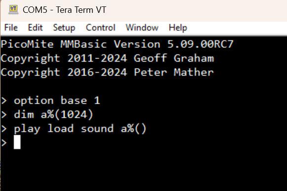

A very minor issue, when using
Option Base 1
Play LOAD SOUND WaveArray()
gives
Error : Array size
Easily fixed by converting to Base 0 but Base 1 allowed an array index value to equal the harmonic numbers in the tone and simplified the wave generation function a little.

  Quote  A very minor issue, when using
Option Base 1
Can't replicate
Posts: 3417
Posted: 08:15am 27 Jul 2024
Ok, that has me stumped. At the command line I can't enter Option Base 1 so I put your lines in a program and it does not produce an error. Yet my program wouldn't run with Base 1
Later I will load RC7, convert it back to Base 1 and try again.

Posts: 3417
Posted: 01:13pm 27 Jul 2024
Re Option Base 1, couldn't find RC7 so loaded latest version of RC5 and it works.
