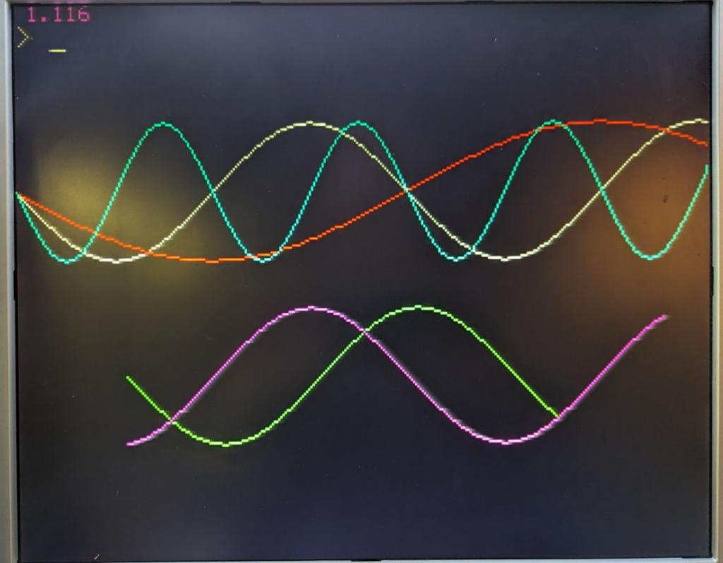

V5.07.08RC18
Prompted by amigawizard I've added some ultra-fast plotting capability
New command
LINE PLOT ydata() [,nbr] [,xstart] [,xinc] [,ystart] [,yinc] [,colour]
ydata is an array of floats or integers to be plotted
nbr is the nbr of line segments to be plotted - defaults to the lesser of the array size and MM.HRES-2 if omitted
xstart is the x-coordinate to start plotting - defaults to 0
xinc is the increment along the x-axis to plot each coordinate - defaults to 1
ystart is the location in ydata to start the plot - defaults to the array start
yinc is the increment in ydata to add for each point to be plotted
colour is the colour to draw the line
This give a huge performance increase over plotting discrete line segments. For example plotting 319 line segments on the VGA version takes around 1mSec @ 252MHz
Example
If MM.Device$="PicoMiteVGA" Then MODE 2
Dim array!(2000)
For i=0 To 2000:array!(i)=Sin(Rad(i*2))*MM.VRes\8+MM.VRes\3:Next
CLS
Timer =0
Line plot array!() 'plot from start of array 1 line segment per x coordinate
Print @(0,0)Timer
Pause 4000
Timer =0
Line plot array!(),,,2,,,RGB(red) 'plot every second x = zoom in
Print @(0,0)Timer
Pause 4000
Timer =0
Line plot array!(),,,,,2,RGB(cyan) 'plot every second y = zoom out
Print @(0,0)Timer
Pause 4000
For i=0 To 2000:Inc array!(i),MM.VRes\3
:Next
Timer =0
Colour RGB(green)
Line plot array!(),200,50 'plot 50 samples starting at x=50
Print @(0,0)Timer
Pause 4000
Timer =0
Colour RGB(magenta)
Line plot array!(),250,50,,50 'plot 150 samples starting at x=50 from position 50
Print @(0,0)Timer
Pause 4000
In addition I've added extra capability to the ADC START command to optionally scale the reading as required
ADC START CHAN1arr!() [,Chan2arr!()] [,Chan3arr!()] [,Chan4arr!()] [,C1min] [,C1max] [,C2min] [,C2max] [,C3min] [,C3max] [,C4min] [,C4max]
By default the min and max values are set to 0 and VCC to give voltage readings. But if the data is for display then you can use other values so:
C1min=200 and C1max=100 will create values ranging from 200 to 100 for equivalent voltages of 0 - 3.3. This allows you to scale the reading for display without further manipulation or to recover the original ADC readings (C1min=0.0, C1max=4095.0)
