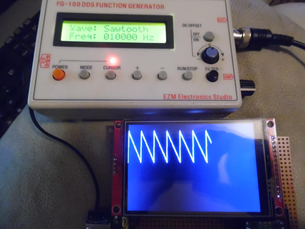

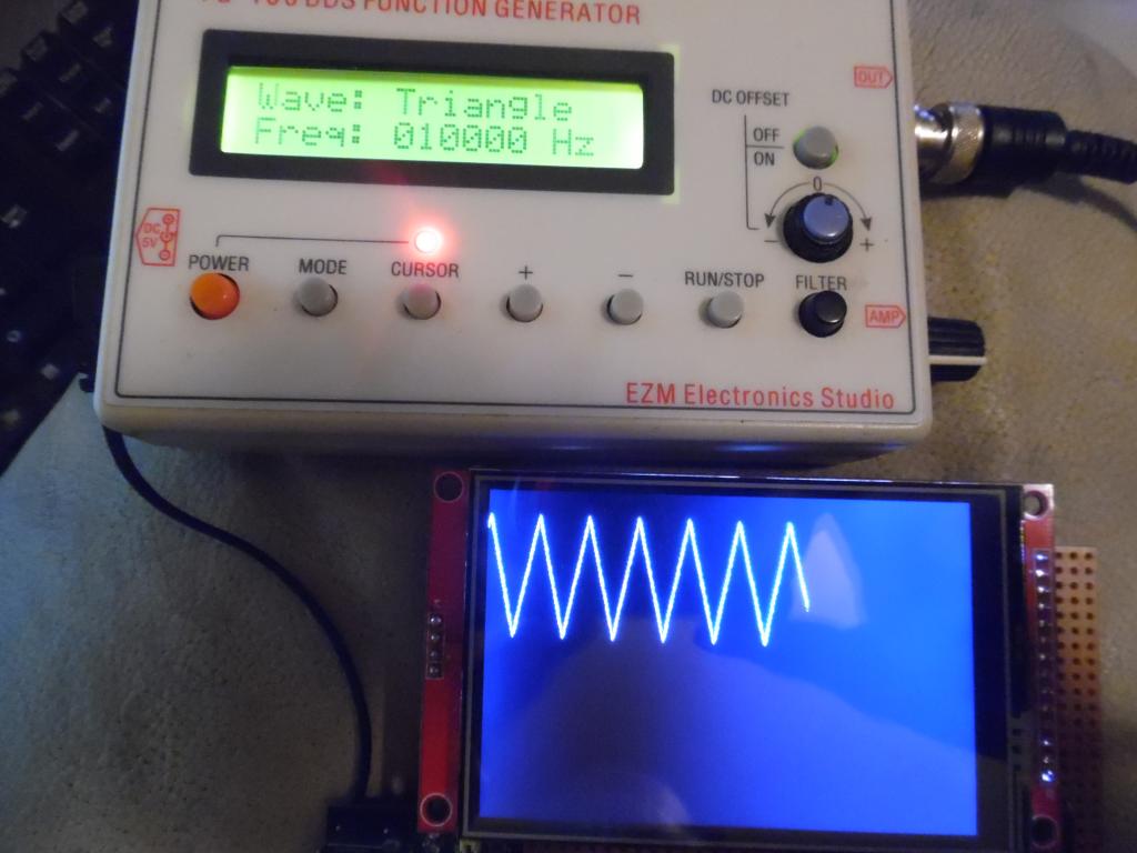

How well is triggering working on the other waveforms?
Posted: 08:28pm 31 Aug 2023
NPH's code pisses over mine
my triggering is rubbish..but I tried. It's all a hobby,I got a scope but got to respect the work NPH has done...the box looks crap imho. that's why everything is acrylic.

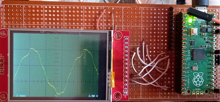

  stanleyella said  Jim, good day. I'm confused as to "This was on a 320 x 240 pixel display."
as 320x240x3=230400 which is more than
RAM:
  0K ( 0%) 0 Variables
  0K ( 0%) General
152K (100%) Free
Is it me being thick again? sorry. stan
Program:
 12K ( 9%) Program (323 lines)
112K (91%) Free
Saved Variables:
 16K (100%) Free
RAM:
 25K (16%) 81 Variables
 75K (49%) General
 52K (35%) Free
OPTION LIST
PicoMite MMBasic Version 5.07.08b14
OPTION CPUSPEED (KHz) 250000
OPTION LCDPANEL ILI9341, LANDSCAPE,GP7,GP8,GP9
OPTION TOUCH GP14,GP15
GUI CALIBRATE 0, 262, 327, 929, 702
OPTION SDCARD GP13
cro.zip
The only changes I made were to the pins used as they conflicted with my setup.
I also added 'i' to invert the trace.
The signal being traced is the random AC pickup from a short lead on the input pin.
Edit:
Add this line after Math Window
Text 150,50,Str$(Math(Max buffer())-Math(Min buffer()),2,3)+" p-p"
to display peak to peak value
Edited 2023-09-01 07:41 by TassyJim
